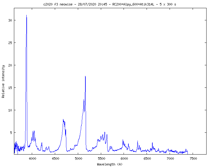

Miguel Rodriguez
- Posts: 36
- Joined: Sat May 31, 2014 4:52 pm
- Location: Madrid, Spain
Re: C2020 F3 (NEOWISE) spectrum
I have acquired a C2020 F3 (NEOWISE) spectrum with Alpy 600.
Regards
Regards
- _c2020f3neowise_20200728_865_Miguel Rodriguez.png (5.56 KiB) Viewed 14760 times

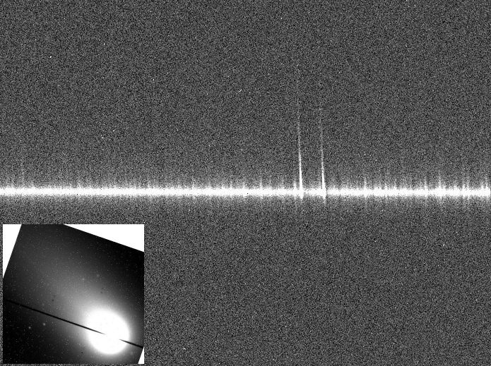

Daniel Dejean
- Posts: 127
A quick way to evaluate the “performance” of a low def spectro is to compare the result with a high def spectra. This comet provide an excellent source for reference.
See example below :
With my Alpy I just see the low frequency envelop but the main lines can be identified at bin 11 (pixel 4.4microns). A binning at bin22 (pixel 8.8microns) shows a dégradation, not a surprise but result is still redeable.. We will see what happen in the UV sideas soon as a HD reference spectrum will be available for that region.
thanks to Juan Guarro for his reference HD spectrum at http://www.spectro-aras.com/forum/viewt ... f=6&t=2367
Bon ciel.
Note you cannot compare spectra unless you know where in the comet it was taken. The distribution of the dust, ions and neutral radicals is different depending on where you measure. As an extreme example see my spectra here
http://www.spectro-aras.com/forum/viewt ... f=6&t=2583
Even if you measure the centre of the coma the spectrum will still vary depending on the width of the binning zone
I recommend posting a guider image with each spectrum showing where it was taken

Daniel Dejean
- Posts: 127
Hello Robin,
Thank for your useful comment. As per your recommendation, I was showing a guider image in a previous message.
My point here was just to take opportunity of the high density of the received signal to better understand the "convolution" effect of a low definition spectra. The high leveI of the emission in the 3850-3880 zone is also a good opportunity to characterize this effect on the UV side where we could compare images provided by different spectroscope.
I am not an expert and not sure at all to use the right wording. However, I learned that interpretation of low definition spectra is very often a risky task... At your knowledge, if we are able to get a good understanding of the convolution function of a given setup, is there a kind of "deconvolution" process that will allow to better understand the signal hidden by such low definition filtering effect ? May be just a stupid idea or an unrealistic dream....
Thank again for your advice.
Hi Daniel,
Sorry I was not criticising you. It was a general comment asking observers to say exactly where in the comet the spectrum was taken.
The difference between high and low resolution is interesting. High resolution for example shows that the Na D lines were still present even when they were not visible (or very faint) in low resolution spectra. Here is a sky subtracted spectrum image through the coma and tail from 2020-07-20. it clearly shows the Na D lines still there, extending into the tail. (click the full size image to see the position of the slit)
The spectrum also changes across the coma with Sodium close to the centre but the dust and C2, CN emission extending further out, for example
http://www.spectro-aras.com/forum/viewt ... f=6&t=2581
To me these differences are very interesting and not studied by most amateurs who only take spectra of the centre of the coma

Daniel Dejean
- Posts: 127
Hi Robin,
Thanks for your superb picture showing clear evidence of Na emission at high resolution on july20. A good quality, low resolution spectra, taken near the same date would probably shows a single "blended line". This comet is a good opportunity for me to better understand, in practice, the "convolution" effect of low definition. My first experiment on July22 is taken in too bad condition to be usable (in bin22 and too noisy...). Hope somebody in that forum will be in position to shows a low def spectra taken near July20-22.
My low def results of july24/26 are showing no evidence of Na emission. If available, it will be interesting to compare it with a high res spectra near the same date.
With the results we have already on hand I understand this Na "flash" has been very dynamic in time (near the sun) and concentrated in the coma centre as per your observation.
Every day is a new opportunity to learn
Bon ciel,
Daniel
