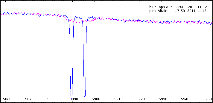

Re: Fringing ripple
I am fairly sure the fringes I see are from the spectrograph and not the atmosphere. They are at constant wavelength positions and do not change with time or location in the sky. Attached is a comparison of eps Aur and Altair taken several hours apart. They match exactly. (I used Altair as a "star flat" to remove them)
- showing fringes constant with time and sky position
- fringes_NaD_ LHIRES_2400_12nov11.png (12.24 KiB) Viewed 9668 times

Re: Fringing ripple
I agree that the ripples must be internal rather than atmospheric as I get them in my flats ... but, surprisingly, not sufficiently uniform for the flats to remove them from the images.
