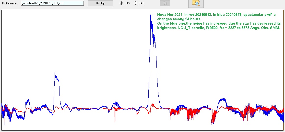

Hello at all,
As David has said the Nova Her 2021 magnitude has decreased a lot and its aspect has changed.
You can see some graphic comparaisons here.
Cheers, J.Guarro.

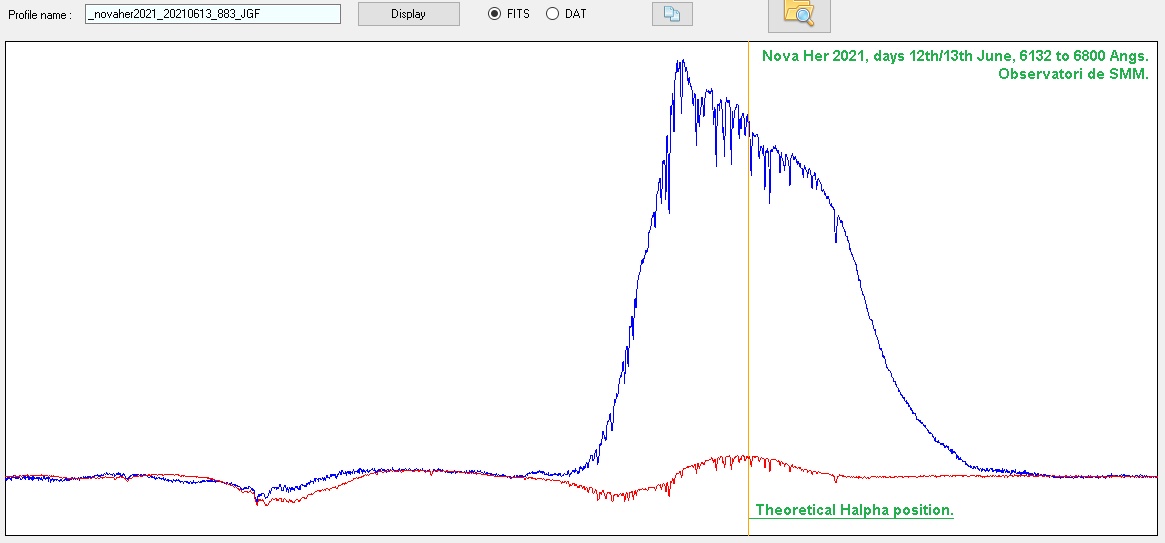

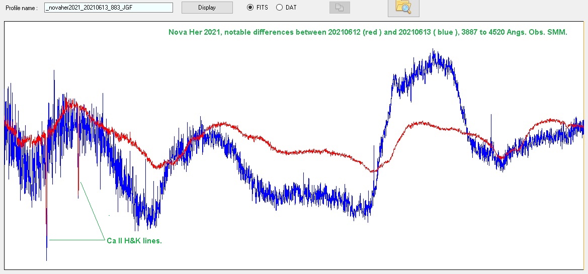

I followed the nova during all the night and was able to see its evolution in 6 hours
The whole spectrum
H Alpha evolution

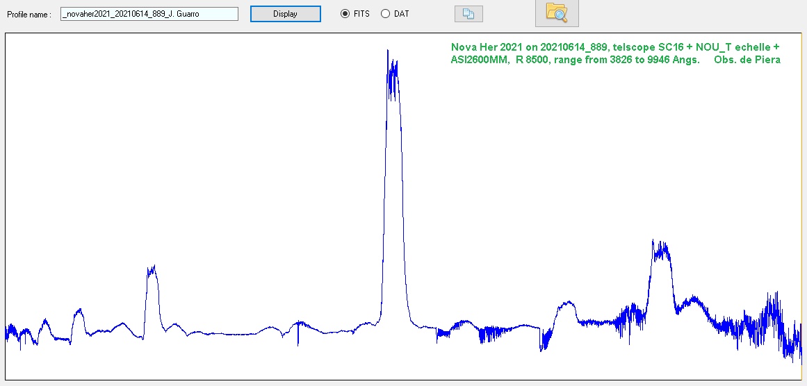

That is Nova Her2021 this last night, you can see here the good performance of NOU_T echelle with the ASI2600 MM camera.
Cheers, J.Guarro.

The shift in the H alpha, beta line profiles from blue to red while still centred on the rest wavelength is interesting.
Increasing transparency might level the line profile but why are we now seeing more emission from the back of the system? Is this an orbital effect ?

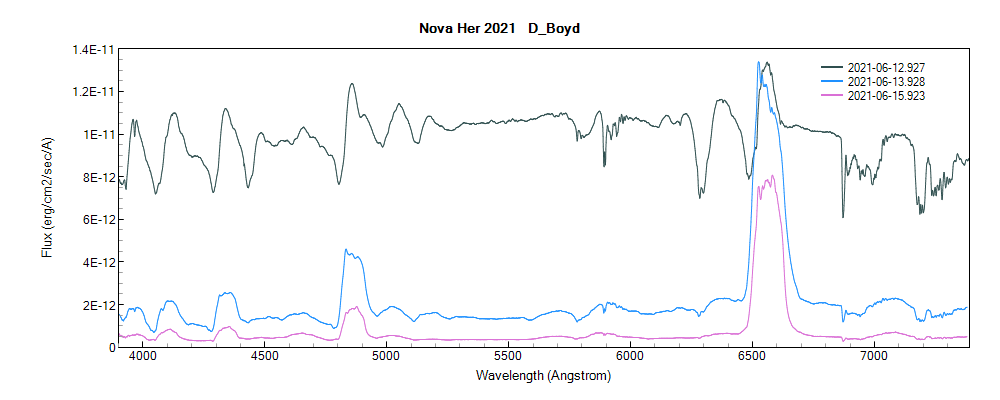

The following plot shows the change in absolute flux of the nova over the last 4 days. These R~1000 spectra have been calibrated in absolute flux using concurrently recorded V magnitudes of 6.35, 8.38 and 9.77 respectively.

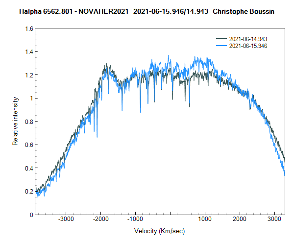

As other observers have noted, the spectrum of Nova Her 2021 is changing very fast !
In particular, the evolution of the Halpha line is already clearly visible at low resolution with a modification of the overall shape of the top of the profile.
I obtained two spectra of the Halpha line of Nova Her 2021 at high resolution on June 14 at 22 h 39 TU (resolution of 18220, JJ = 2459380.4435) and on June 15 at 22 h 43 TU (resolution of 18835, JJ = 2459381.4463) with my LHIRES III (grating of 2400 lines / mm, acquisition time of 60 min for each spectrum (6 x 600s)).
What is most noticeable is the width of the Halpha line but we can also note the evolution in detail of its profile in one day (especially around +1000 km/s) !
Clear skies to all !!
