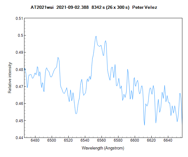

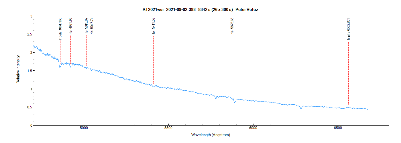

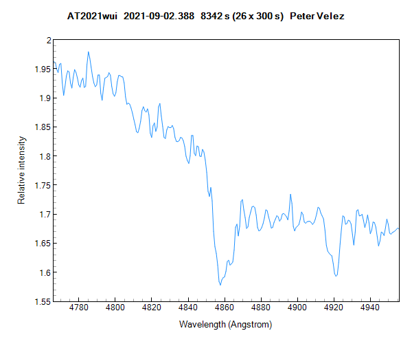

Here is my contribution with a few lines of interest marked.
About 2 hours taken with UVEX 600 lines/mm on a PW CDK 12.5. I have dereddened the spectrum using the ISIS Extinction tool applying a factor of 1.15 as suggested by Robin. Resolution reported by ISIS is 1024. SNR measured with the FWHM tool in ISIS is around 100 and the calibration acceptable when considering the Na I and Telluric O2 lines.
The classification as an early B star looks right to me. While not particularly obvious from the main plot, I was able to identify He I at 4 locations in the spectrum. The absorption line for He II at 5411.52 A is modest - I've included it for completeness but am not certain about it.
What I do find interesting is the profiles of the Ha and Hb lines. I've included subplots of these. The Hb absorption line has a small bump - this might be the start of an emission building but at this resolution I can't be certain.
I might check back in on this one in a week or so to see if anything has changed.
