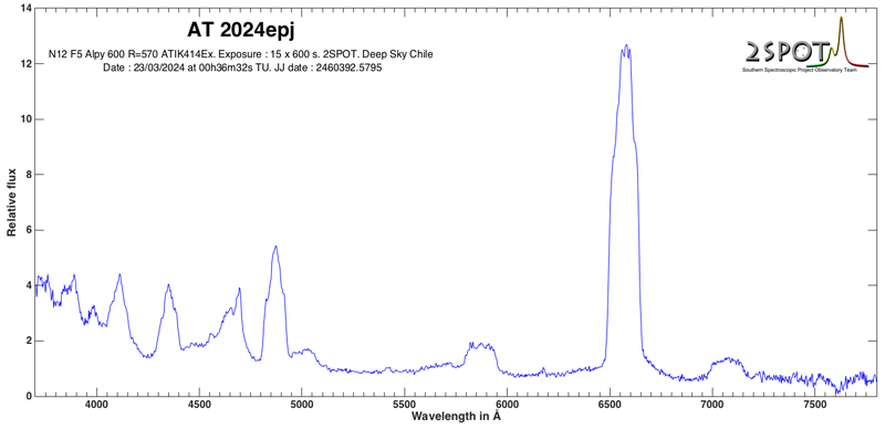

New spectrum taken from Chile, this time with an Alpy 600.

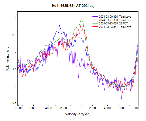

And comparison between the eShel sepctrum and the Alpy spectrum. (and evolution in 3 days)
Evolution of H alpha line in 3 days

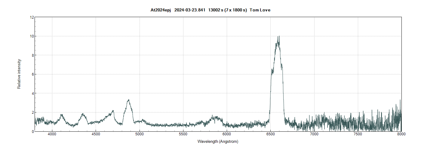

Surprisingly, I have had good weather tonight. So here is my fresh Alpy spectrum as well.

The emergence of He II 4686 on the red edge of the complex NIII/CIII
