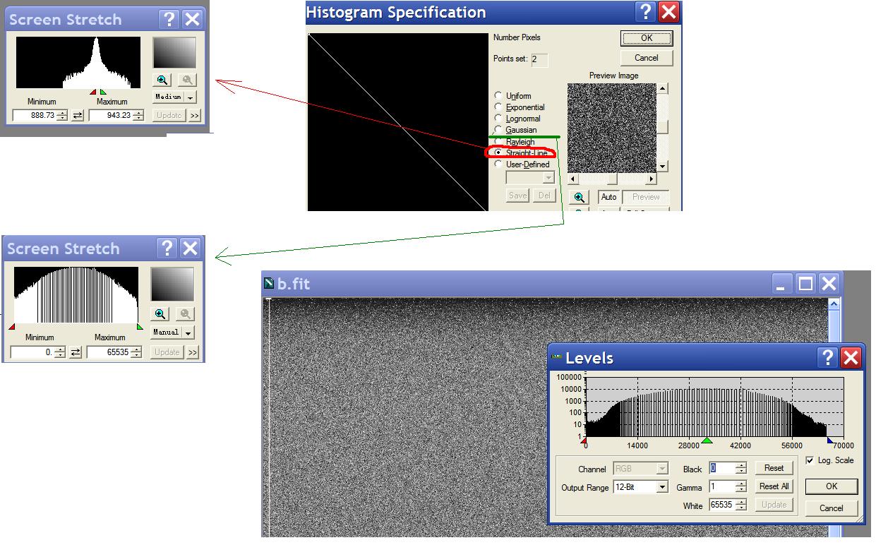

I have tried to set CCD's gain=0; offset=126 to take pictures, then RON=47, very noisy~~ the same when offset=110.
Only being set at 116, RON is the same value mentioned in the QHY homepage. 6~7e

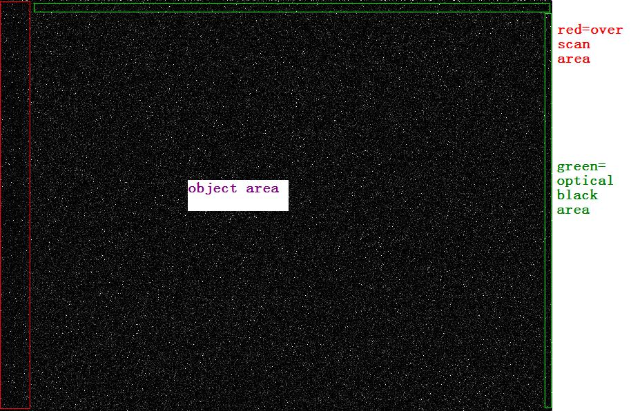

Sorry , I forgot to say that QHY6Pro's photo insists of 3 parts: over scan area + object area + optical black area. All of them are showed together.

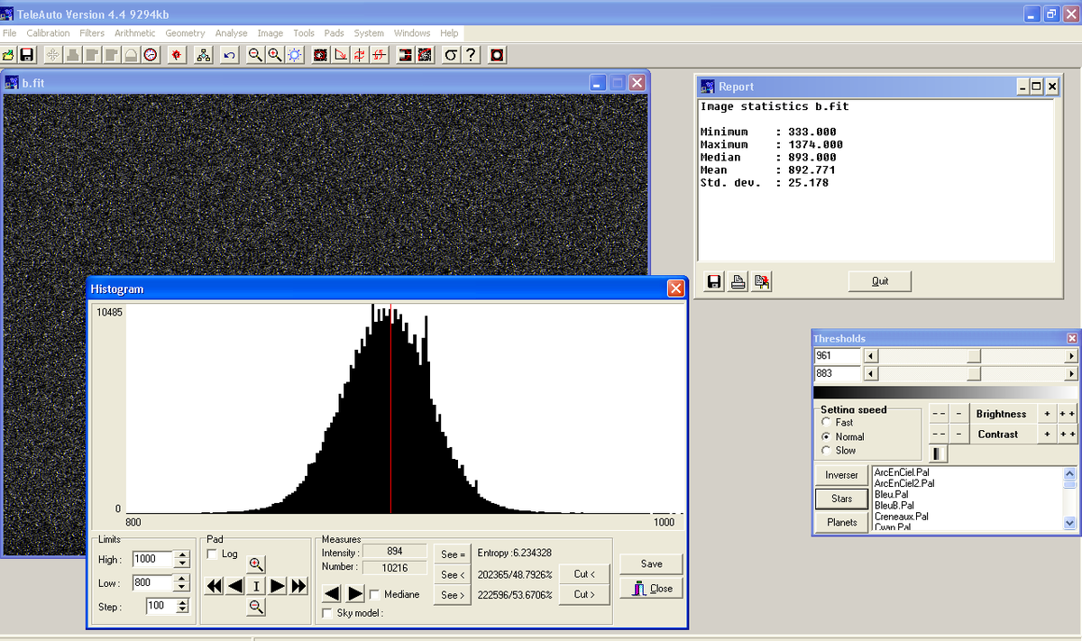

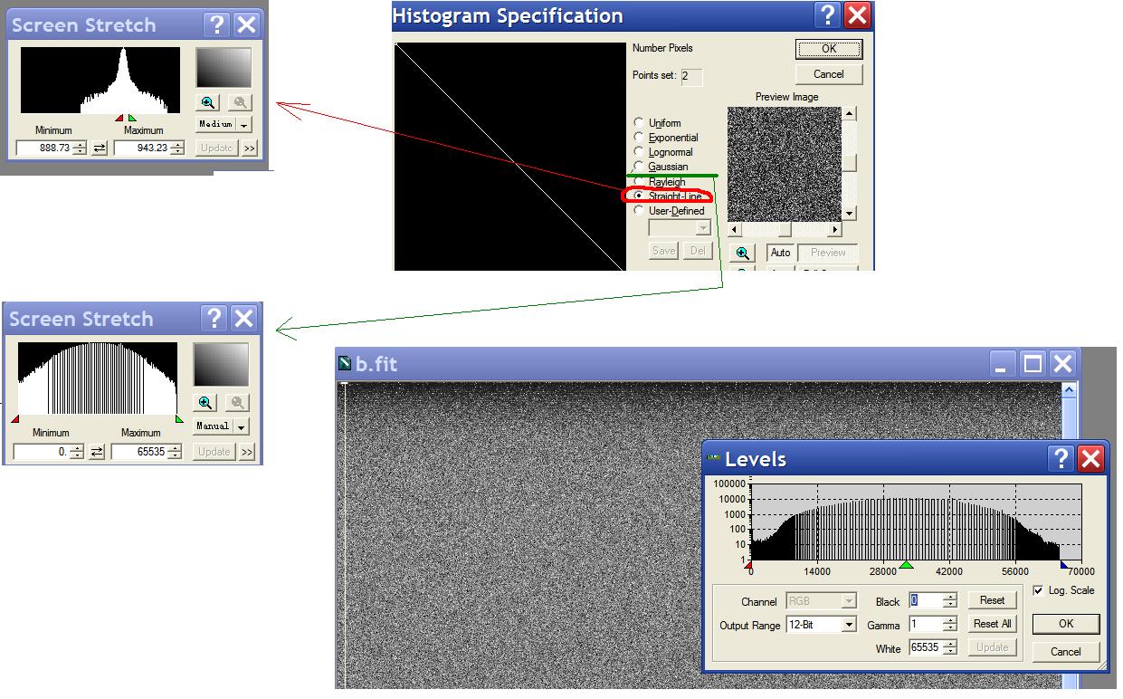

Thank you very much! I have just looked at bias and made a screenshot. I do not know if the histogram is good or bad?

Re: evaluation of noise and gain for QHY6Pro
Hello Dong,
The shape of your histogram looks rather strange and it also looks clipped at both the low and high end.

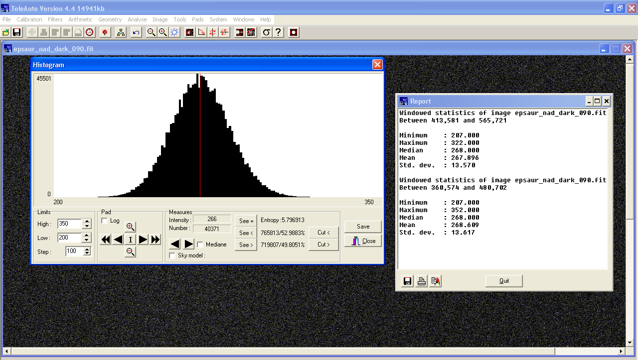

Attached is the histogram of a single 300 sec dark frame from my ATIK 314L+
Can you post the fits of your dark please (as a zipped file)
ATIK 314L+ 300s dark

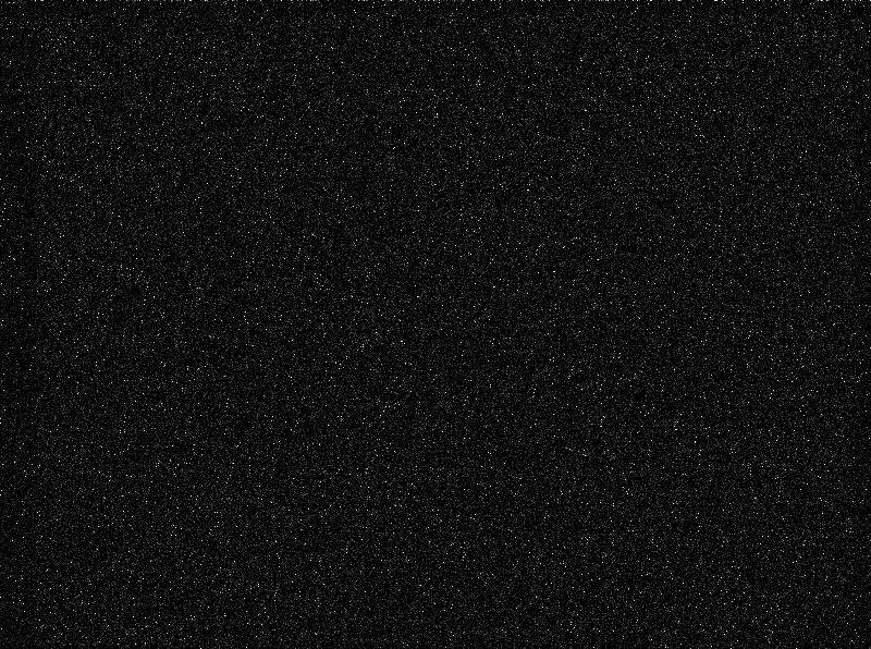

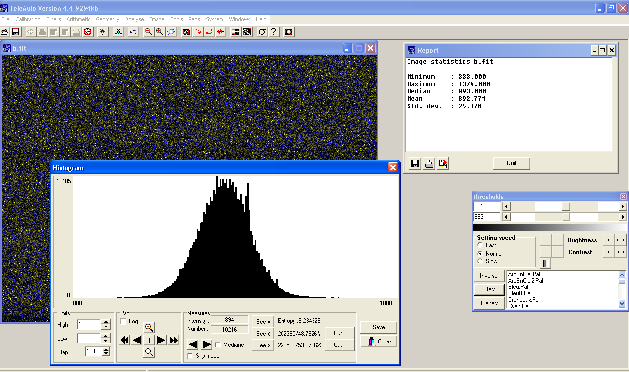

Hello Dong,
I checked your bias frame. The histogram looks fine. I think your histogram plot must be incorrect.
QHY6 pro bias frame
QHY6 pro bias frame

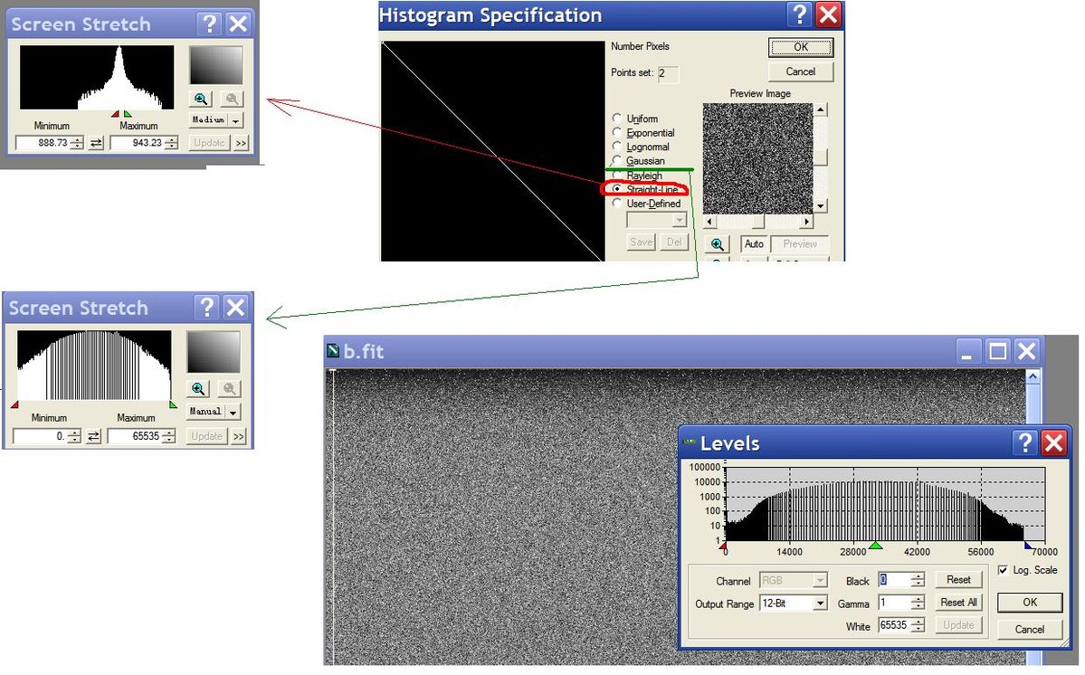

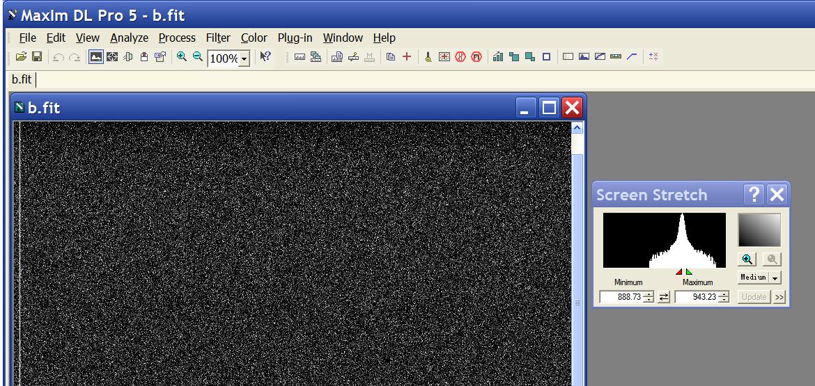

Hello, Robin:
Thank you! This time I open MaxIm and find 2 buttons "histogram and levels", last time it is default as straight-line, so I think that this makes that strange shape; when I change into Gaussian, it becomes a bell-shaped one just like yours, and so does the "levels".
I think that this is the reason that histogram plot is not correct, don't I?
