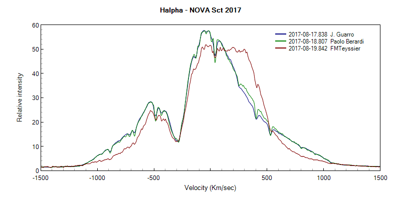

Here's my last spectrum taken last night.
Comparison with the last echelle spectrum of Joan (taken in the ARAS data base)
And Balmer lines (H Alpha and H Beta)

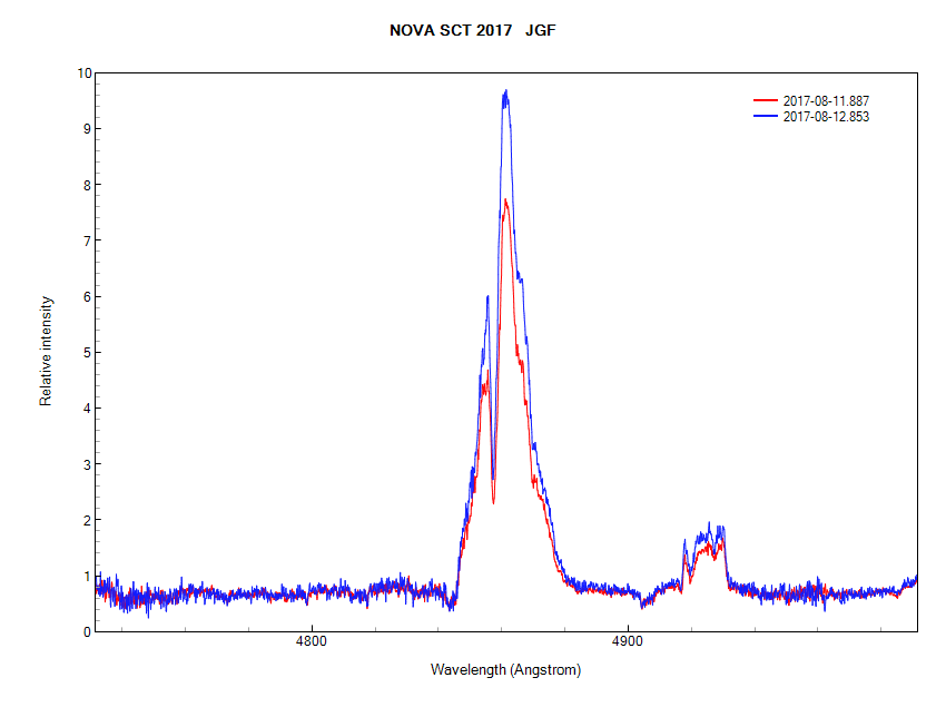

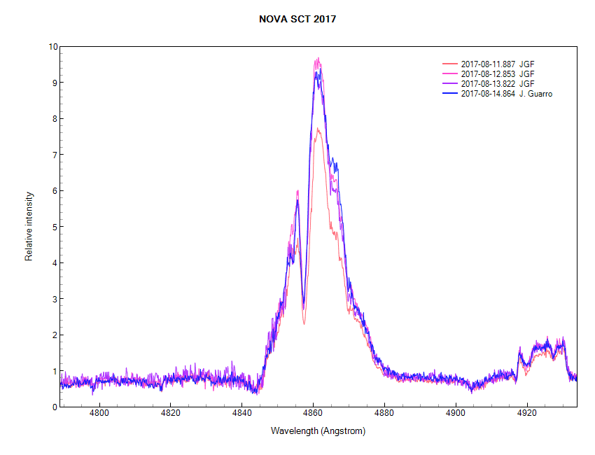

Post by Joan Guarro Flo »
Variations of the NovaSct2017 on the last 24 hours.
The star continue having it's ascending tendence in the Hidrogen.

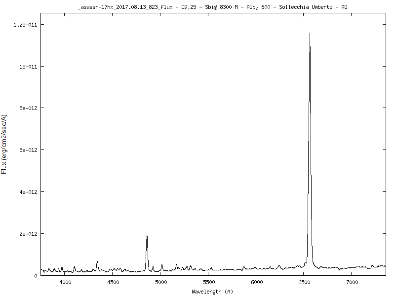

Post by umberto sollecchia »
Bonjour à tous, le profil de la nova observé le soir 13/08/2017. Umberto

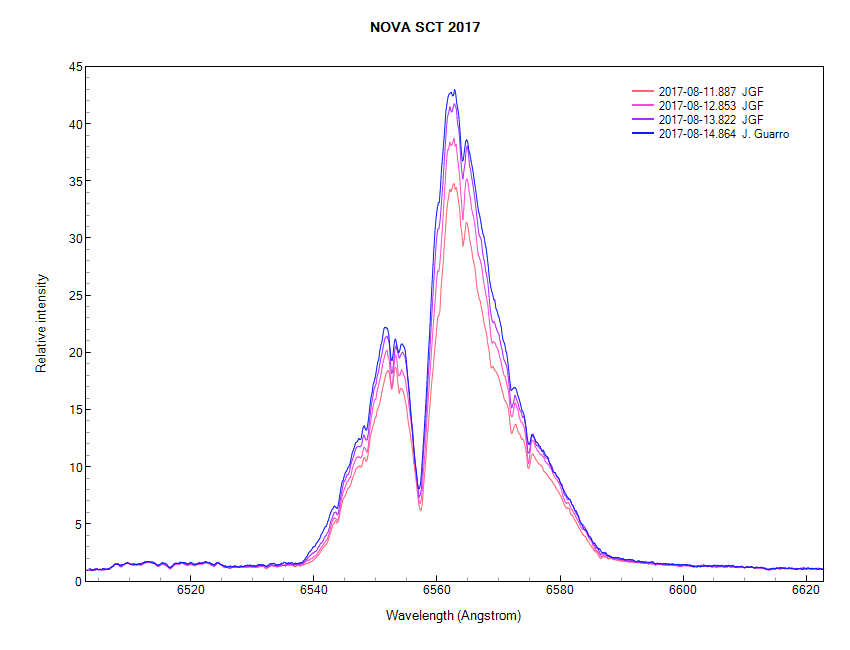

Posts: 578
Hi all, I added my last observations in the following profile animations.
H-beta and Fe II (42), sequence that includes July 26, 30, Aug 1, 3, 9 obs.
H-alpha region. Includes July 10, 25, 31, Aug 13 obs.
The same spectra (H-alpha) at lower flux values:

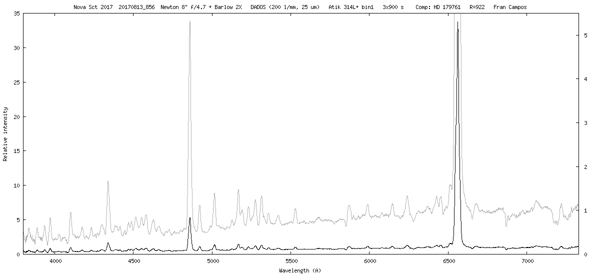

Post by Francisco Campos »
here is my contribution from the night before yesterday.
Greetings
Fran

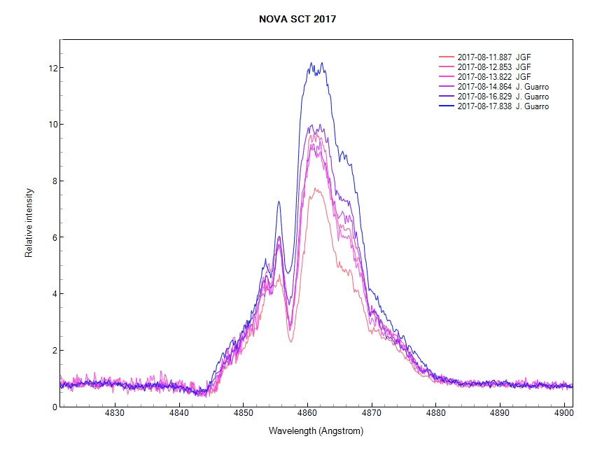

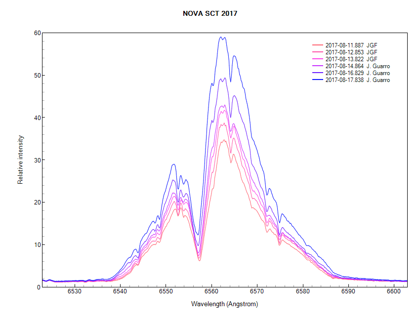

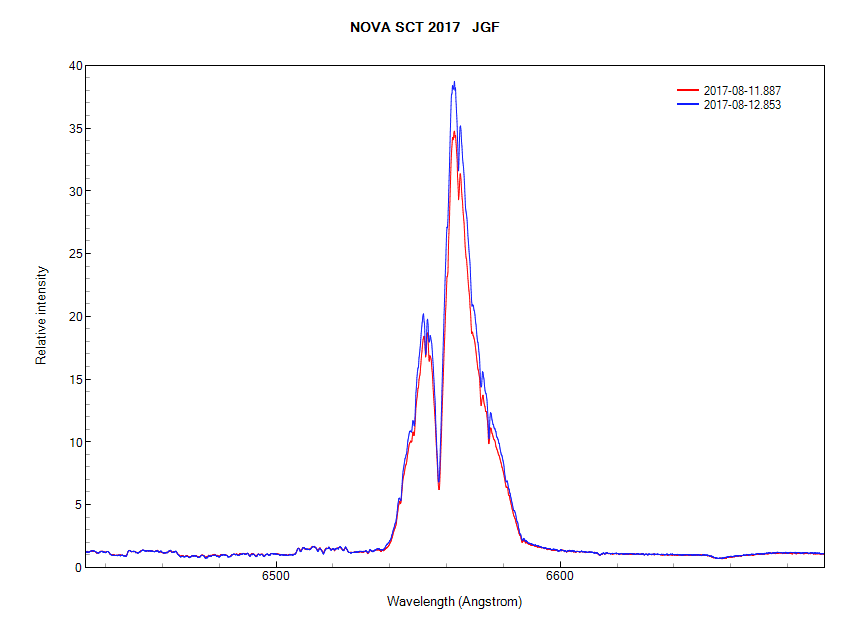

Posts: 728
These graphics showing the evolution of the Hydrogen on de last nights.
The last night was cloudy in my two observatories.
Joan.

Posts: 728
Hi all, Bongiorno Paolo !
The NOVA SCT2017, continued with it ascending Hydrogen emission. Is it normal ?
No tinc por, Joan.
Posts: 1565

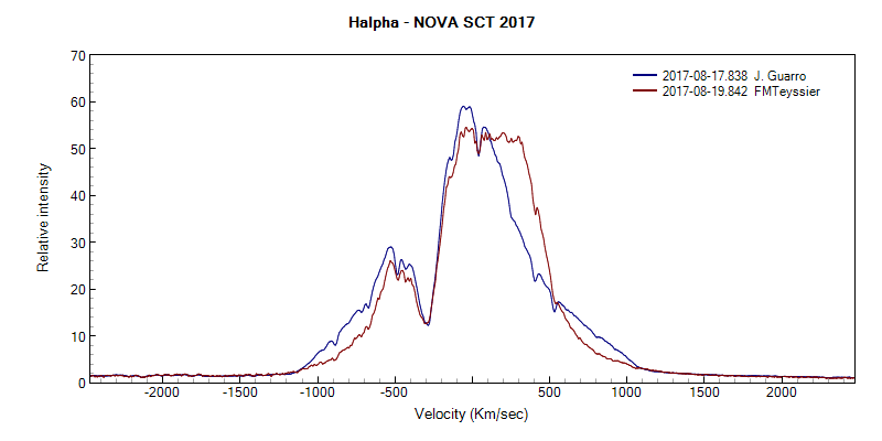

Finally, I join the campaign ...
Not easy at Latitude 50N (+ haze tonight)
But impressive change in the Balmer profiles within 2 days
Udate with Paolo spectrum (18-08)
Flat top: signature of an almost spherical ejecta - Still very opaque (absorption at -280 km/s)
