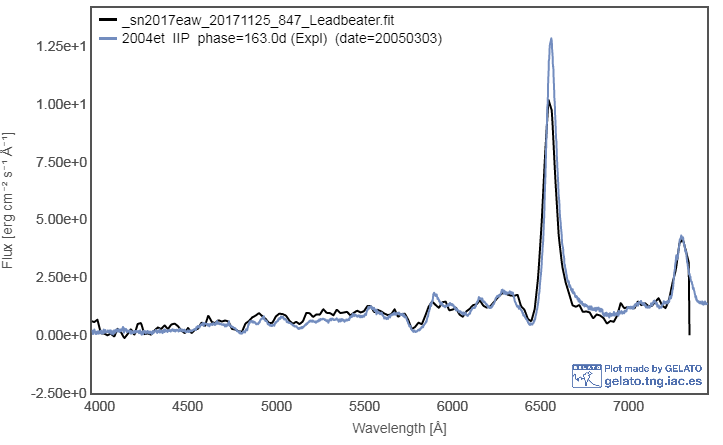

Here is an R~130 spectrum from last night using the ALPY200, (black) overlaid on a spectrum from GELATO of another IIP supernova at approximately the same age, SN2004et, which was interestingly in the same galaxy and was one of the first supernovae I ever measured, using a 100 l/mm grating (before the Star Analyser)
https://sites.google.com/view/sn2017eaw.
