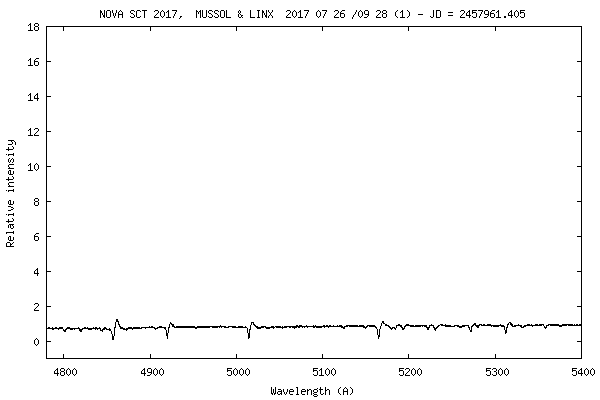

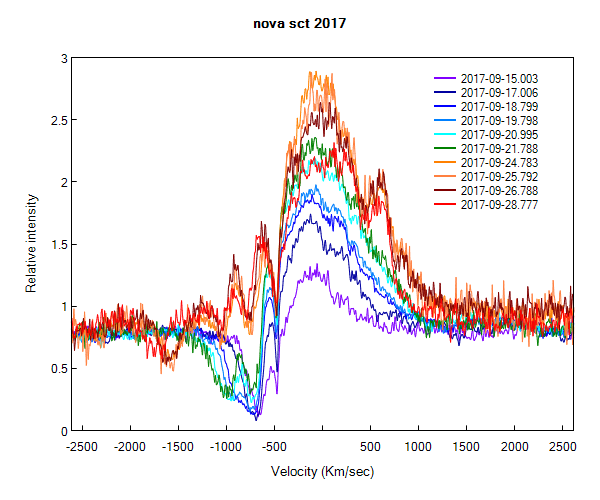

This is the evolution zone Hbeta and Fe II, from 2017 07 26 to 2017 09 28.
Cheers, Joan.
Cheers, Joan.

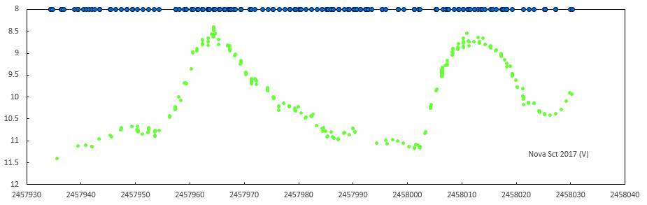

- Posts: 1565
Very good coverage and nive animation, Joan!
The evolution of the "nova" is very impressive and atypical

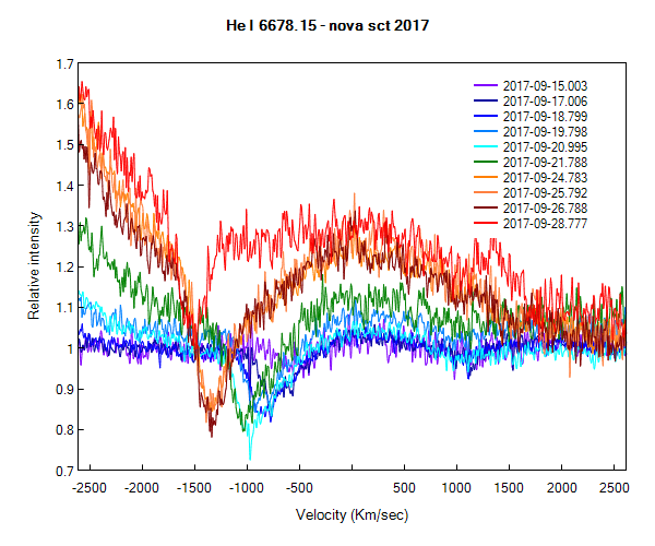

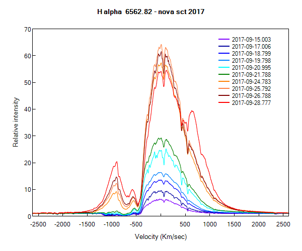

Update of the light curve with the second rise from ARAS data base http://www.astrosurf.com/aras/Aras_Data ... ct2017.htm: Evolution of some lines during the second decline:
H alpha. At the second maximum, the emission is very weak
This is the typical behavior of the lines during an oscillation, hightlighted by Mac Lauglin: during an oscillation the spectrum tends to regain the aspect it had at the same luminosity

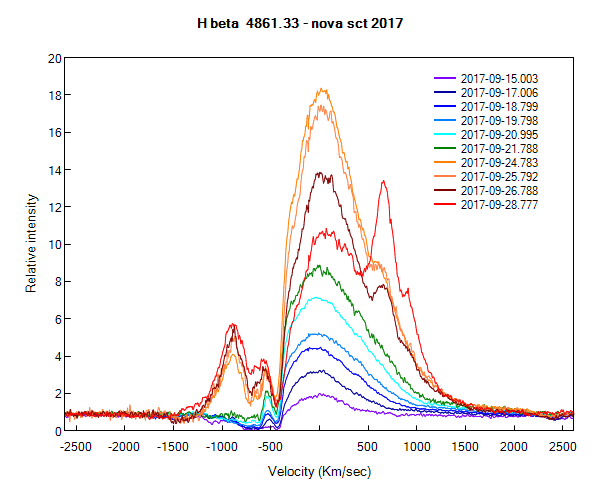

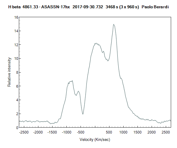

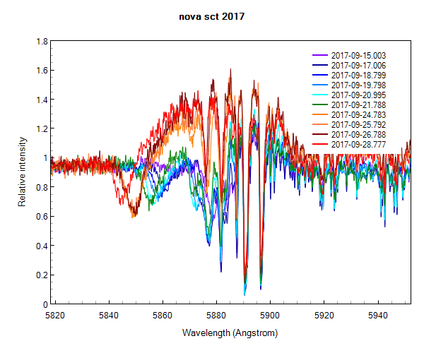

H beta profile from the mast spectrum obtained by Paolo:
Interesting to see the similarity between the two main absorptions vr ~-430 and +460 km/s Very impressive!
Keep on the good work on this very peculiar event until the conjonction

- Posts: 1565
Thank you for the information, Fran

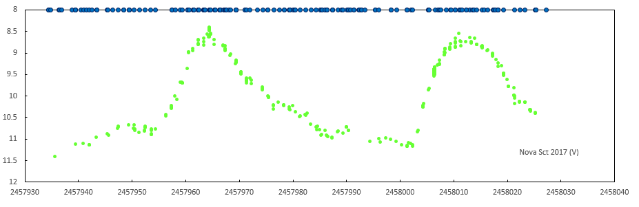

A fantastic object! Uptade of the lightcurve and last spectra (Terry, Joan, Paolo, Umberto, Fran)
PS: I can't access to the photometry of this nova from VStar. Any idea?

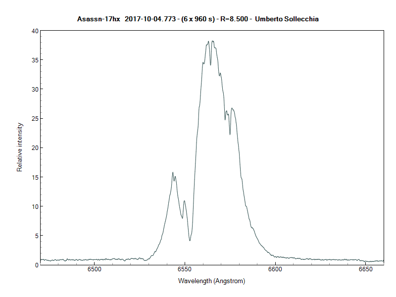

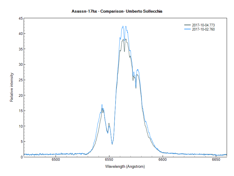

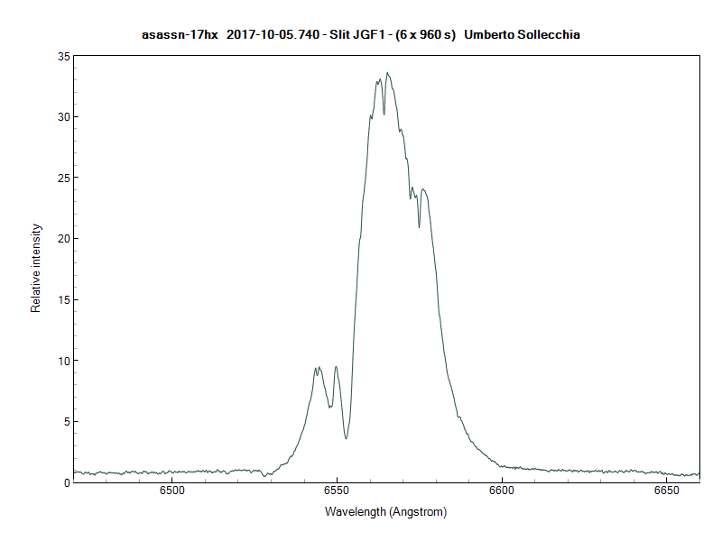

Bonsoir du tout, la danse de la nouvelle continue. Place le profil du jour 05-10-2017 et une comparaison avec le jour 04-10-2017.

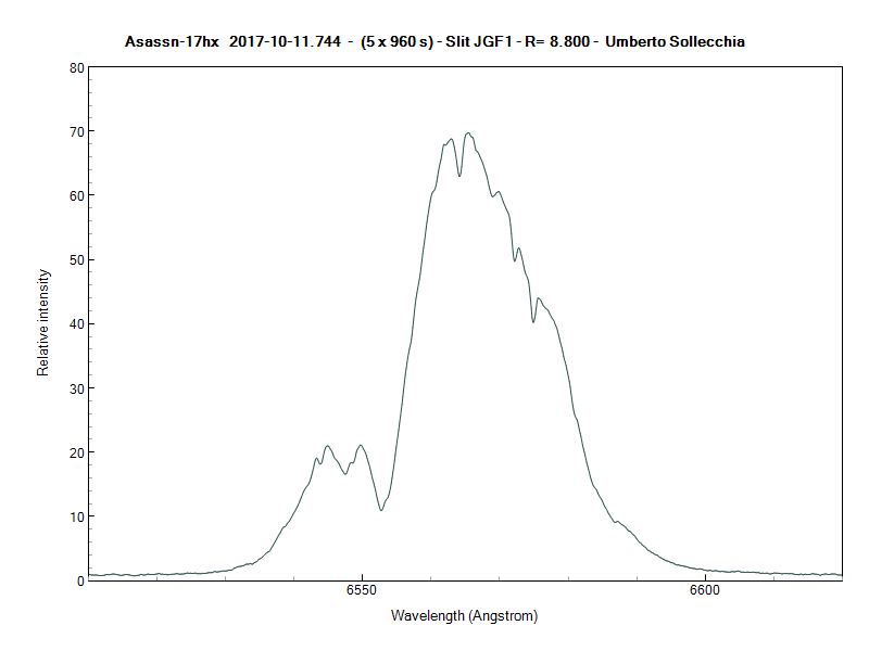

- Posts: 247
onne journée à tous, placez le profil de la nouvelle observé le 11-10-2017.

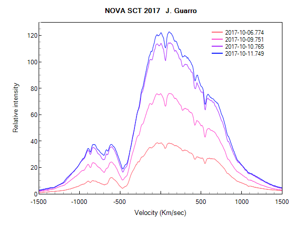

- Posts: 728
As it is seen in the graph of the Umberto. Halpha of the New Sct 2017, has been back in the maximum issue
Regards, Joan.
Regards, Joan.
