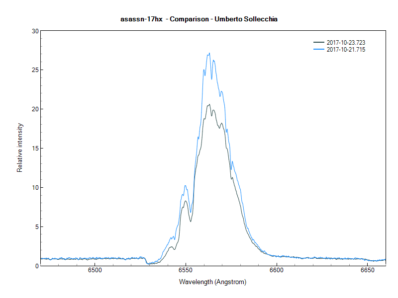

Post by umberto sollecchia »

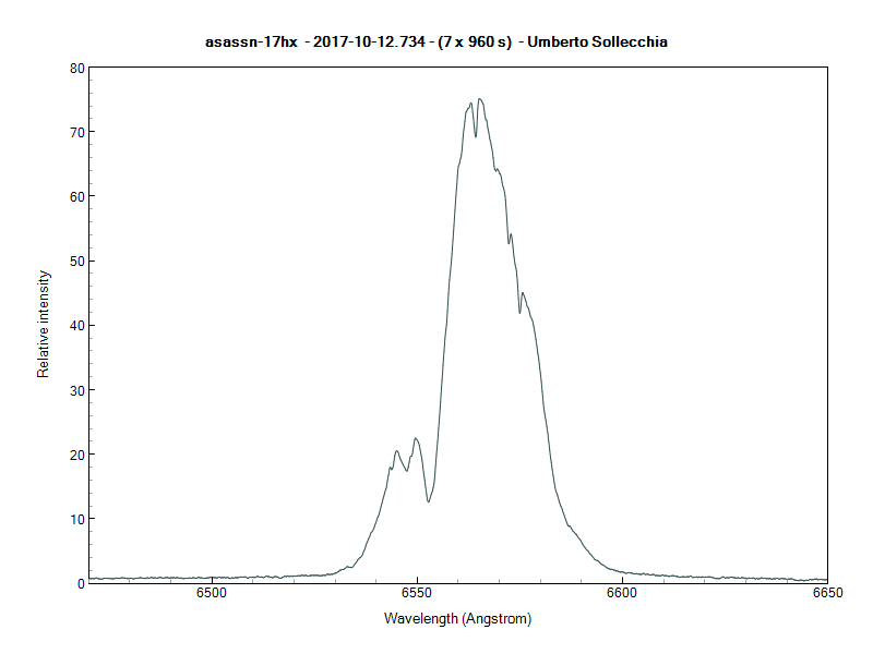

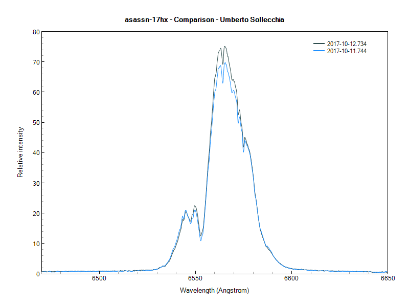

Bonne journée à tous, placez le profil de la nouvelle observé le 12-10-2017 une comparaison avec ce qui précède.Umberto
asassn-17hx_20171012_734_Umberto Sollecchia.png (22 KiB) Viewed 17591 times
asassn-17hx - Comparison - Umberto Sollecchia.png (29.37 KiB) Viewed 17591 times

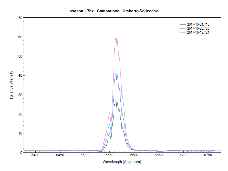

Bonsoir du tout, voici une comparaison des profils des trois derniers jours.
umberto
asassn - Comparison - Umberto Sollecchia.png (33.52 KiB) Viewed 17544 times

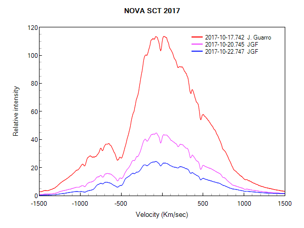

Posts: 728
Post by Joan Guarro Flo »
As it can also be seen with the graph of Umberto. It is very possible that there is a reverse relationship, between, the increase in brightness of the Nova and the decrease in the intensity of the Halpha.
Joan.

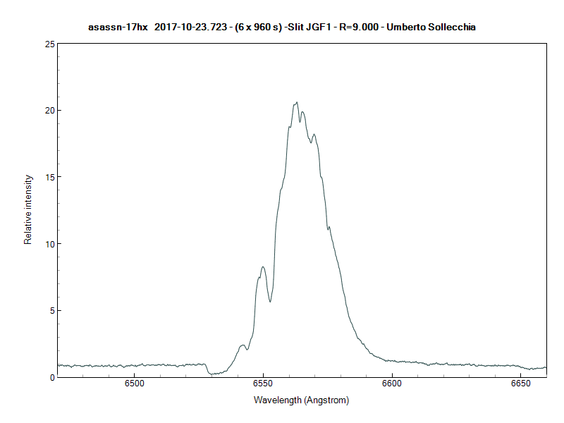

Posts: 247
Salut, juste Joan, même la nuit dernière 23-10-2017, avec de nombreux problèmes météorologiques, j'ai réussi à faire un spectre à la nova.Voici son profil spectral et une comparaison avec 21-10-2017.
Salutations -
asassn-17hx_20171023_723_Umberto Sollecchia.png (21.15 KiB) Viewed 17489 times
asassn-17hx - Comparison - Umberto Sollecchia.png (29.8 KiB) Viewed 17489 times

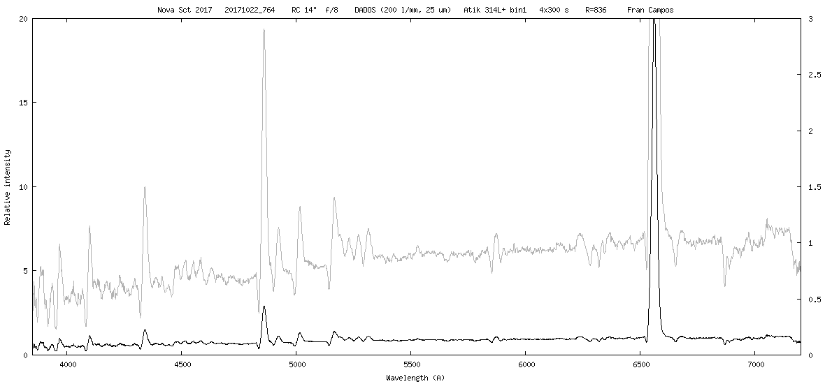

Francisco Campos
Posts: 88
Post by Francisco Campos »
Joan Guarro Flo wrote:Hi,
Joan.
Yes, Joan, the nova is again rebrightening. Outstanding!
Here is a spectrum from two nights before- the nova is getting more and more difficult to observe. Again P-Cyg profiles but now the bands are broad.
Salut!
Fran

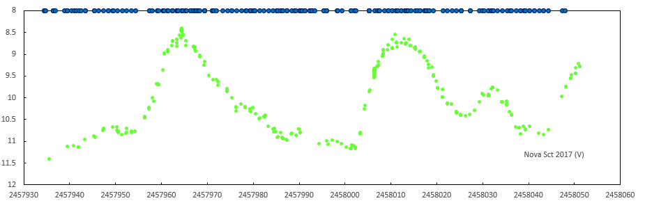

Posts: 1565
Update of the lightcurve and spectroscopic coverage
Impressive!
A few more spectra of this new brighning are welcome. Yes, the nopva is lower and lower.

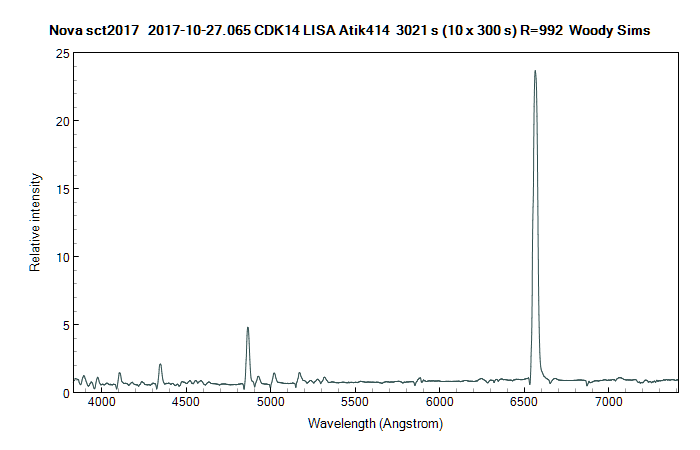

Forrest Sims
Posts: 86
Post by Forrest Sims »
Greetings,
I was lucky enough to capture Nova sct2017 last evening just after sunset. This a hard target as you know being rather low to the southwest at sunset. Being at latitude 33 degrees did help. I was able to get 10 300sec exposures. Halpha is overexposed to, help improve the SNR at other wavelengths.
Woody
novasct2017_20171027_065_Woody Sims.png (17.16 KiB) Viewed 17438 times
