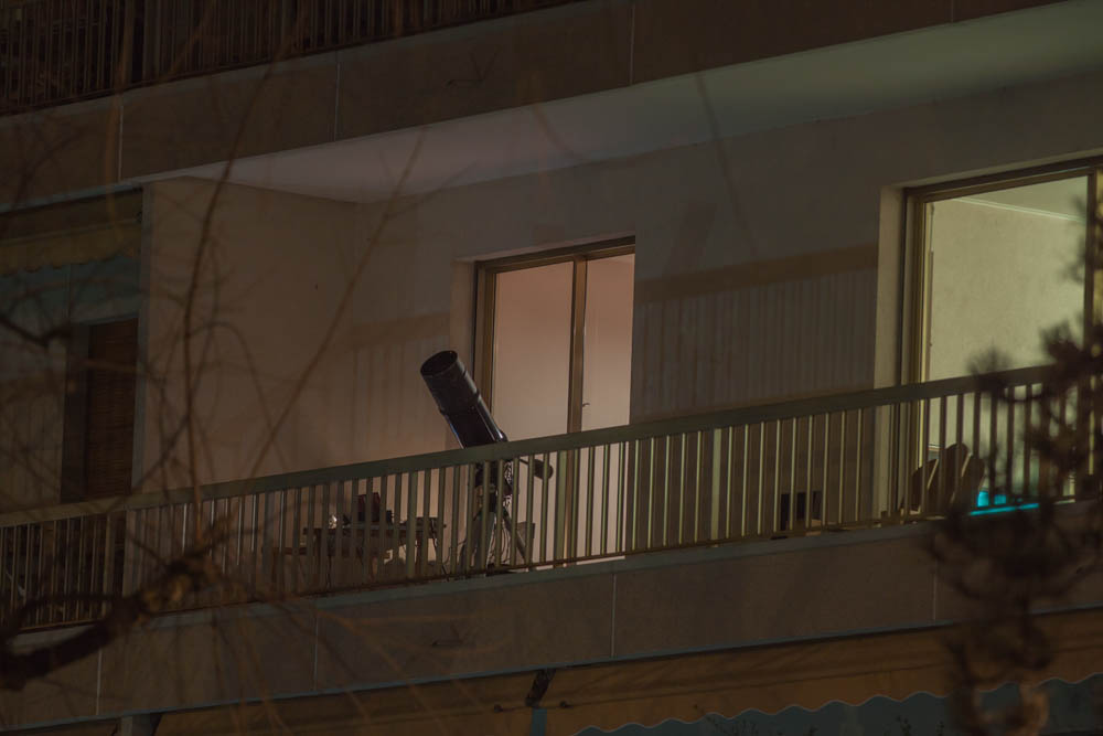

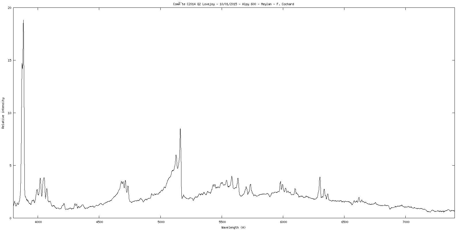

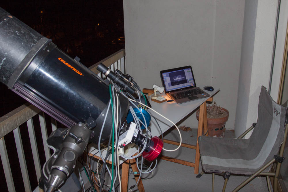

Last Saturday, I made a spectrum of the comet, with my Alpy spectro.
Of course, nothing comparable with your great data, but my observation was made in city center, from the balcony of my appartment !
I only can see a small part of the sky - but luckily, this time the comet was in my small window !
I've also made a spectrum of the sky background, to remove it from the comet one.
Not high science, but a really fun moment !

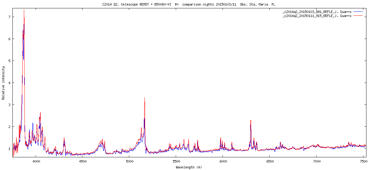

The Observatory REMOTE of St. Maria M. is free of fog.
Leave this graphic of comparison of the days 3 and 11 January.
J.Guarro.
J.Guarro.
- _C2014Q2_20150103-11_J.GUARRO.png (9.6 KiB) Viewed 9009 times

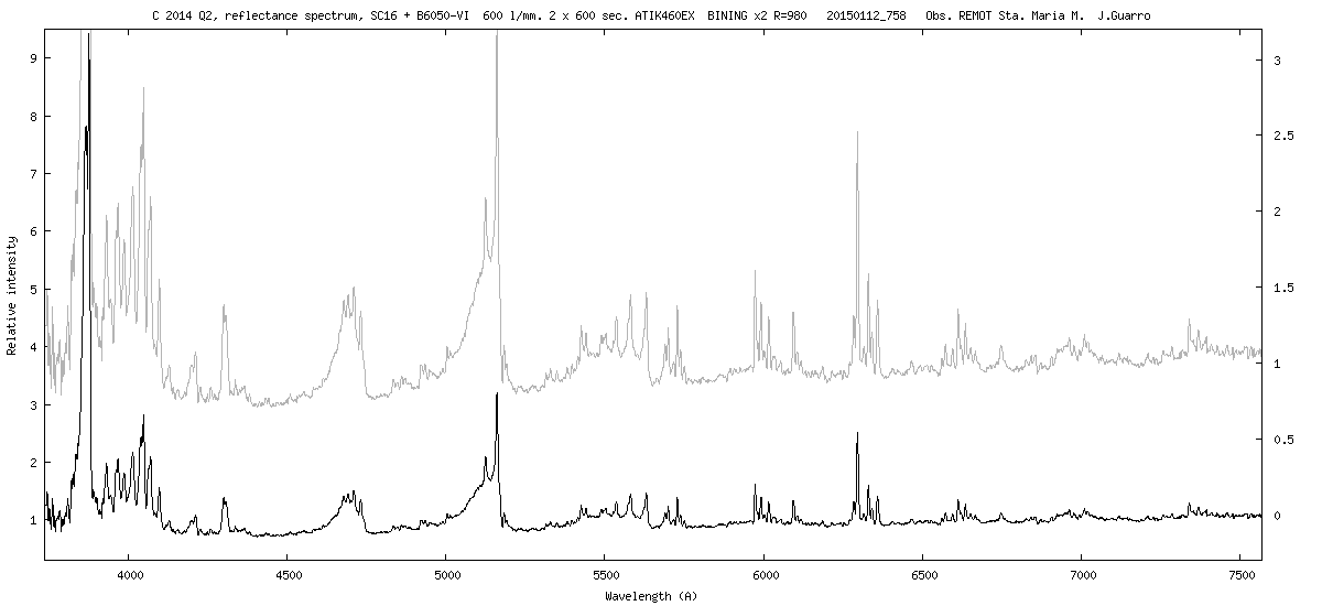

The C / 2014 Q2, last night from Sta. Maria M.
J.Guarro.
J.Guarro.
- _c2014q2_20150112_758_REFLEC_J. Guarro.png (12.29 KiB) Viewed 8992 times

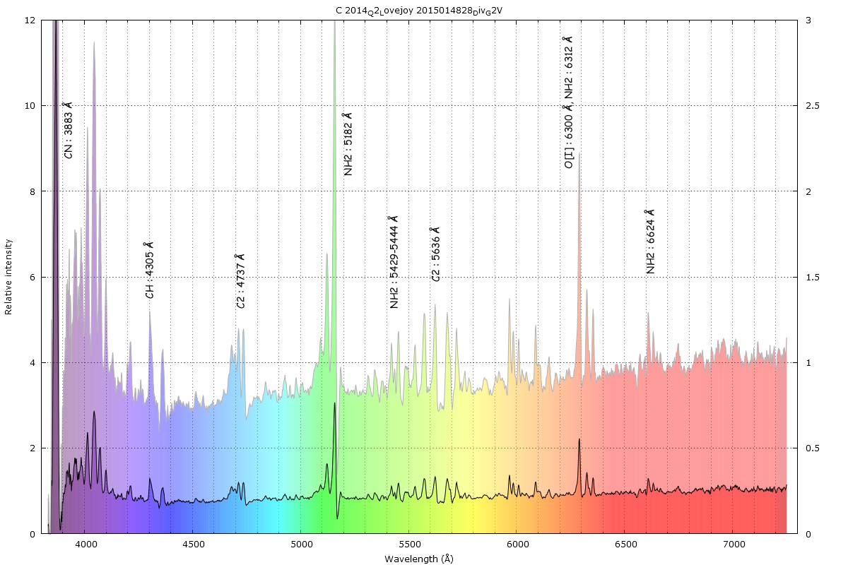

Last observations for 12 and 13 january. Reference spectrum for Sun light was obtained observing the G2V star HD13043. For its high radial velocity (and for comet relative motion) I had to shift the spectrum before calculate the comet reflectance.
Mid-res spectrum (R~5500), 5750-6230 A interval that includes Na D doublet region (no appreciable sign of emission in reflectance spectrum). Other strong lines come from NH2 and C2 molecules.
Hi-res spectrum (R~15000), 6243-6410 A interval (2400 l/mm grating) with 6300/6363 A auroral [O I] red doublet. The emission component from atmosphere airglow is very low, around 1-2 percent of cometary lines.
