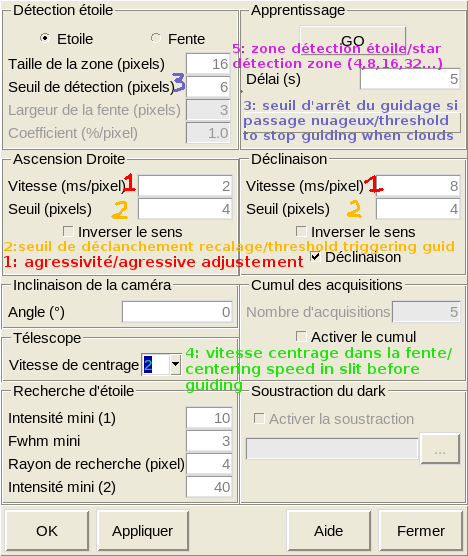

Here is a small tuto for autoguiding with Audela.
Hope this help.
For camera tilting angle, there is a tuto here:
http://audela.org/dokuwiki/doku.php/en/ ... er_spectro
http://audela.org/dokuwiki/doku.php/fr/ ... er_spectro
