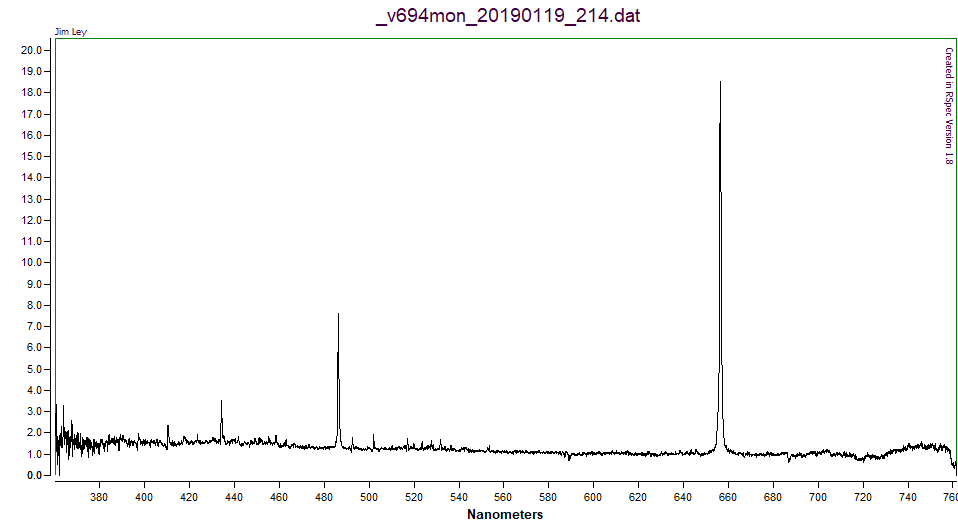

Here is a spectrum that I took last night.
V694 Mon full.png (12.53 KiB) Viewed 6253 times
This was 10 x 600s. That certainly increased the signal to noise ratio!
Do you think that these profiles suggest absorption of H-beta and H-alpha?
V694 Mon H-beta.png (16.27 KiB) Viewed 6253 times
V694 Mon H-alpha.png (13.34 KiB) Viewed 6253 times

Here is my most recent result for low resolution Alpy600 (Vis) and LISA (Ir) on V694 Mon:
I'll try to post my photometry data as I have been shooting this object every clear night with the C-11
and ST-8xme with Astrodon photometric filters.
