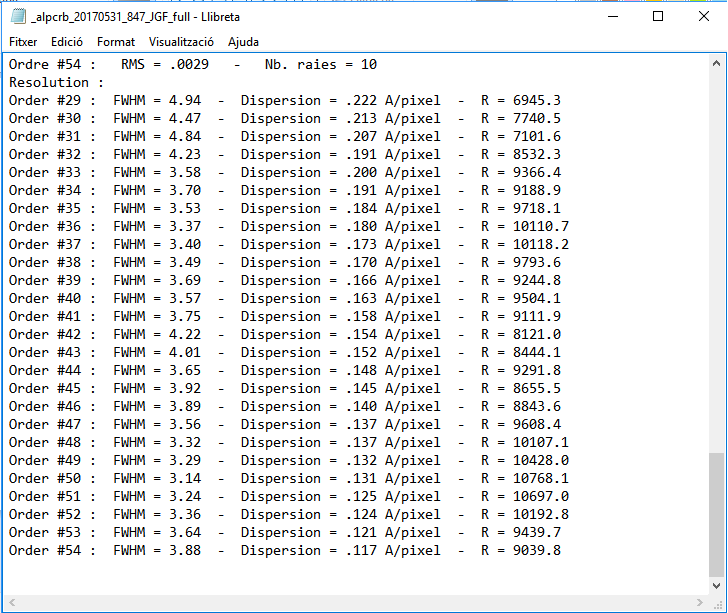

I don't have enough words to describe your work. With a resolution of 9000 covering the whole visible spectrum... it is necessary to ask for more? Ok, there will be some astrophysics that look for resolutions higher than 10.000, but they won't reject a spectrum of this quality... and a very affortable price.
Do you think that a ST-8XME is a good option for this spectrograph? I think the chip size is more or less the same as the Atik 460ex one, but with bigger pixels.

usually work with binning x2 (pixels, 9:08 x 9:08), will step numbers of the current dispersion and as areas comparative of ATIK460ex and ST-8XME.
I think you should enter the C.Buil website, where you will see the performance of the two cameras.
http://www.astrosurf.com/buil/isis/noise/result.htm
The ST-8XME is a very good camera, Tenin in mind that it can cool water. This simplifies considering the spectrograph and CCD are fixed. There hung the telescope.
