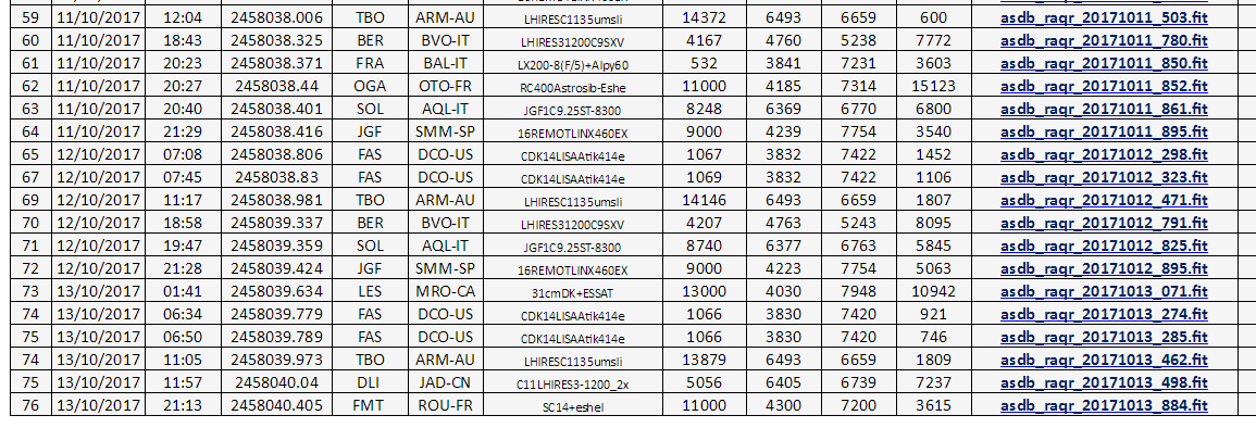

Déjà 3 nuits d'observations sur Toulouse et en espérant que le beau temps persiste (vent d'Autan prévu = nuages en principe). Voici une quicklook de la première :
(je t'envoie les fichiers d'ici demain/après demain François)
Posts: 1565
Re: R Aqr spectra requested by Margarita Korovska
C'est excellent Christian,
Nous répondons largement à la demande de Margarita K., avec des spectres d'excellente qualité!
Merci à tous,
Bonne continuation jusqu'à dimanche

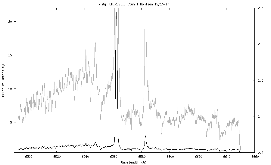

I agree it is not stellar. There is a close companion that is quite visible in the blue and a haziness visible with a U filter. See below.
I also took a much better spectrum than my previous one as the weather was kinder.
R AqrV01.jpg (40.88 KiB) Viewed 19287 times
R AqrB01.jpg (41.6 KiB) Viewed 19287 times
R AqrU01.jpg (36.03 KiB) Viewed 19287 times

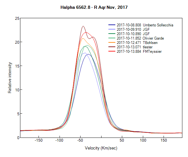

Posts: 1565
An update
The monitoring is perfect
It looks that we detect variations in some lines, especially H alpha at a time scale of ~ 1 day
Resolution 8000 to 14000
But a word of caution: as mentionned R Aqr as a symbiotic star has a combination spectrum (hot component+red giant+nebula).
More over it is well knowned that complex jets are/have been emitted
So the observed "variations" in the profile of Ha line could be the result of observed area (setup, seeing ...)
I try to get a response and I'll keep you informed

Posts: 1565
Spectra obtained the same night with a good snr:
Comments from Steve:
The nebula and jet are highly
structured and have complex velocity distributions. This could
cause problems if the pointing varies between spectra, and even
produce some profile variations on short intervals if the seeing
varies (the psf can mix parts of the nebular spectrum into the
stellar, I need to check on the relative intensities but it's not
impossible on a scale of arcseconds). Some srt of
seeing monitoring, or extraction along the slit, would help clarify
things.
The star and jet (and inner nebula) contaminate the spectrum and certainly alter the profiles depending on the seeing. For a typical seeing of 2-3 arcsec, the expected variation can be anything from around -30 to +70 km/s depending on the slit and centering. The north is redshifted, the south blueshifted, and since there is also scattered light in any system it's essential to displace the slit and obtain spectra either perpendicular to the slit direction or away from the central star (or take three spectra at different positions for reference). The star is variable on short timescale, the environment isn't, so unless a high velocity event occurs (and that can be determined from lines other than Halpha) you can calibrate the contribution of the environment. NB: here is, again, a good reason to obtain a broad selection of lines: the Balmer decrement works in favor o the stellar contribution because of the excitation conditions, the Hbeta should have a much weaker nebular contribution than Halpha and the forbidden lines [O I] and [O III] will be different for the two regions. Comparing the wings of the profiles will permit a systematic correction for contributions.

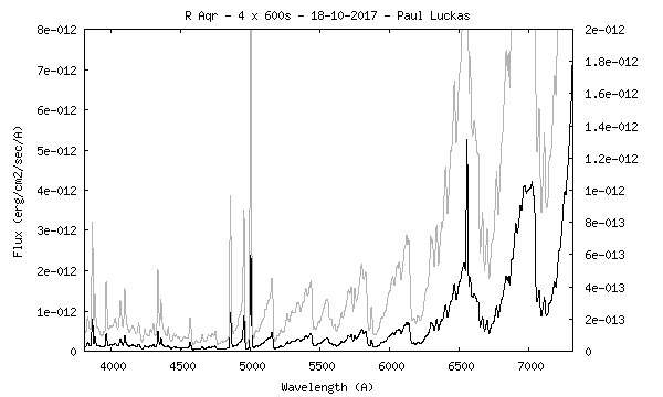

Paul Luckas
Posts: 103
Post by Paul Luckas »
Here is a low resolution (R = 535) update from last night.
Paul
