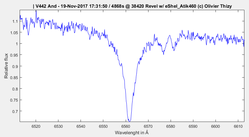

V442 And Be star in outburst - update
Post by Olivier Thizy »
a quick update on V442 Andromedae which went into outburst end of august. The outburst seems done now (to be confirmed) but one spectrum per week would confirm it. Here is the spectrum from last night with no emission visible:
Once the outburst end if confirmed, it would be great to have an intensive two weeks monitoring to get the quiescence phase monitoring folded over the 2.6 days period. I have the feeling that this intensive monitoring whould be done soon so be ready... :-)
