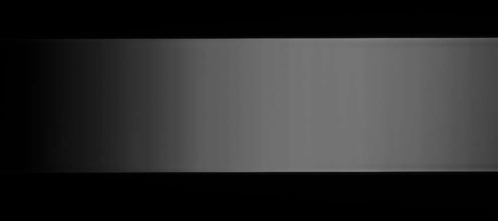

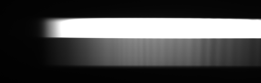

Hi Christian
I have purchased one of these cameras mostly to use on my LISA rather than on a LHIRES.
I was very interested in your comment about minimal rippling.
Unfortunately I have found that there is still rippling at least with the LISA.
Below are 2 flat frames taken with the internal lamp of the LISA. The first was taken some time ago with a ATIK314+ and a regular slit.
The second is with the ASI183MMpro. They are not exactly comparable as the second one was taken through a different slit- a photometric slit with the wide end. The narrow part should be the same though.
The rippling is similar in both cameras. Maybe slightly more pronounced with the ASI183.
This is annoying but it is easy to remove on the LISA with the flat frame. ATIK314+ ASI183MM pro

Re: New CMOS ASI183MM camera
Hi Terry,
These low resolution ripples are from a different source, most likely interference fringes between much thinner layers in the sensor itself. (Most sensors show these to a varying extent. The sensor used in the ATK314 is one of the best in this respect, it is very severe in the Kodak KAF chips). The ripples in high resolution spectra are interference fringes from the cover glass which apparently depends on whether the sensor cover glass is AR coated. (for example the ATK314 is very good, the ATK414 is terrible)

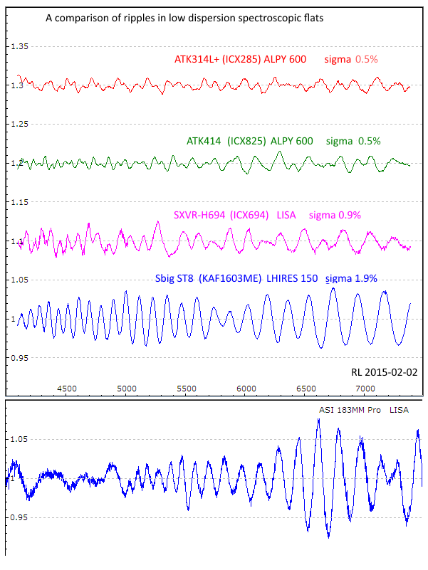

Hi Terry, Christian
Here is Terry's flat added to the bottom of my collection of low resolution ripples. (the ASI183MM is not calibrated in wavelength) The ASI183MM is definitely poor in this respect. A problem for slitless spectroscopy (eg with the Star Analyser). A good flat would be definitely needed for slit/fibre spectrographs. (I can still see some residual ripples ~2%pp with my ALPY600 and ATK428 camera even after flat correction using the internal flat lamp.)
- lowres_ripples_by_sensor_update.png (41.69 KiB) Viewed 9644 times
