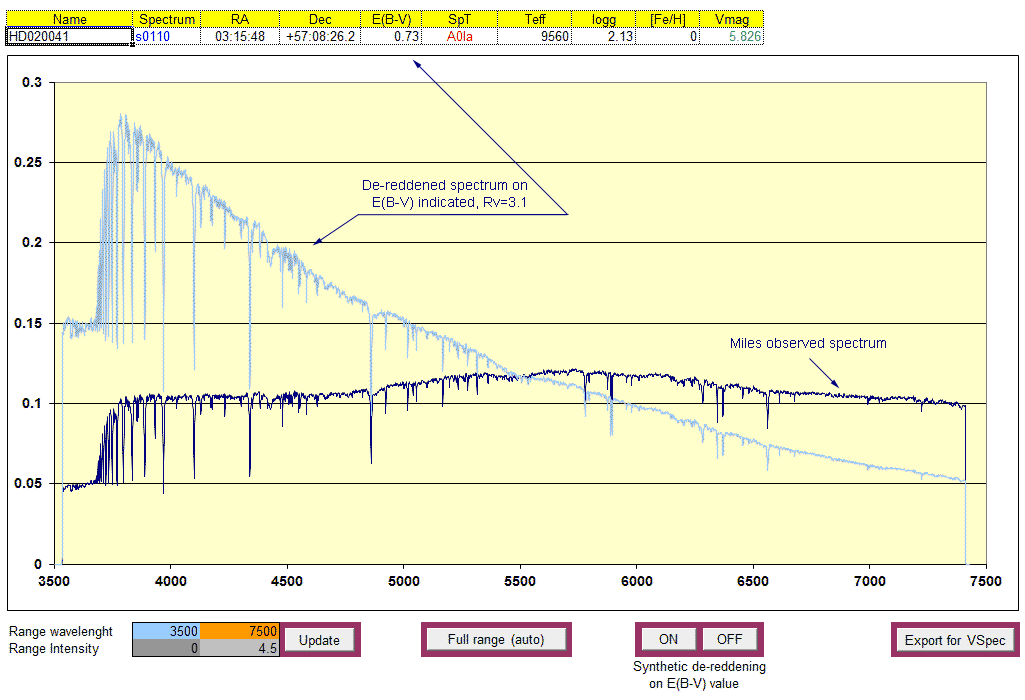

Re: About Miles data base
following the very important last posts by Christian and François related with the MILES catalogue de-redded spectra inconsistency, and thanks François to share the link where to download the original MILES spectras (before de-reddening), as promised today we have updated the excel file posted yesterday by me and Paolo Berardi.
In the zipped enclosed file you will find:
1)
SPEC_VIEW (folder) with:
- file excel "MILES_SPEC.xls"
- folder EXPORT (empty)
- folder MILES_OBS (empty)
2)
Please download the 985 spectra ASCII (ZIPPED) at the following link:
http://quasar.teoth.it/html/varie/MILES_OBS.zip
unzip the single files s0001-s0985 (file extension .test.dat) in the previous empty folder MILES_OBS .
3)
Open the file "MILES_SPEC_V2" (there are two versions Excel 97-2003 and Excel 2010). You will see the table with the 985 stars list. You can select a star and click on "profile" button.
4)
If you click [ON] over the label "Synthetic de-reddening" a new spectra will be superimposed. This spectra has been de-reddned on the base of the color excess E(B-V) indicated on the cell J3. This is the new screen view:
5)
The button[Esporta VSpec] will copy the fie MILES in the folder EXPORT (see point 1). Moreover a new file will be created for the inter-stellar extinction even if the "Synthetic de-reddening" is on OFF, this new file will have the extension "_dered.dat".
Finally the changes vs the previous excel file posted yesterday are the following:
- the name of the folder that contains the spectras
- the spectras
- the function ON/OFF that now will do a de-reddening while in the version before a reddening was made.
The MILES OBS spectra can be used for the calibration in intensity, selecting the specific star spectra in the catalogue. While the de-reddened spectra is just for didactic purpose in order to understand what can do the inter-stellar extinction.
Again thanks to all experts here on supporting us to develop this simple tool. If there is any problem please just ask.
Kind Regards,
Paolo and Marco

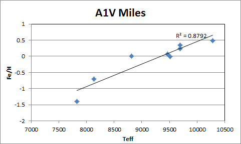

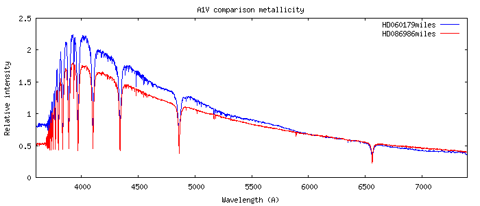

- Posts: 142
Robin recently asked the question in spectro-l if metallicity has an effect on the continuum, or in other words if the spectral type and luminosity class are sufficient for the selection of a calibration reference star. My answer I post here because some illustrations help the discussion. Since the Miles library has selected stars in particular with different metallicity it can be used to answer this question.
I already had prepared earlier a table of the catalog stars sorted after spectral class copied from
http://miles.iac.es/pages/stellar-libra ... alogue.php
I looked at a spectral class where I found several spectra of the same luminosity class (A1V), suitable for spectra normalization and checked if I find a correlation between metallicity (Fe/H) and effectice temperature of the fitting Planck slope: As a correlation seems to be there I plotted the two extreme spectra, corresponding to: HD60179 is better known as Castor A. By coincidence I had used it earlier as a reference for my echelle. I also checked that reddening (Eb-v) was small.
Other spectral classes show a similar correlation (B2IV and B8). Metallicity seems to have a quite large effect on the continuum shape, although it has to be noted that the example shown here are two extreme cases. Does anybody know more about this?
Regards, Martin
Regards, Martin
