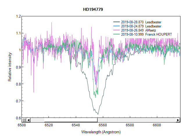

Here's the evolution of HD 194779 with two others spectra in Bess

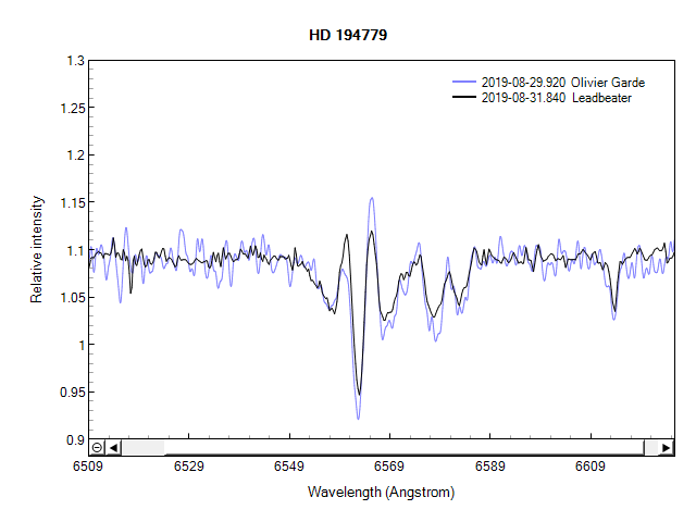

Very interesting! Thanks for the confirming spectrum. Here is the spectrum I took on 28th. (zipped fits file) It looks so different that I am not sure it is the right star. How does it look superimposed on the other spectra ?
EDIT: now confirmed. the observation 20190828 is of a nearby A3V star, not HD194779
Last edited by Robin Leadbeater on Sat Aug 31, 2019 11:09 am, edited 2 times in total.
Olivier GARDE wrote:Here's the evolution of HD 194779 with two others spectra in Bess
Jon has updated the table requesting priority higher cadence monitoring of HD194779 until the end of this TESS sector
"Recent spectra show Halpha activity beginning on Aug. 28-29.
Continue to monitor. If possible, get 2 spectra per night- one early and one late until Sept. 11 2019. High SNR will be useful to compare to TESS data."

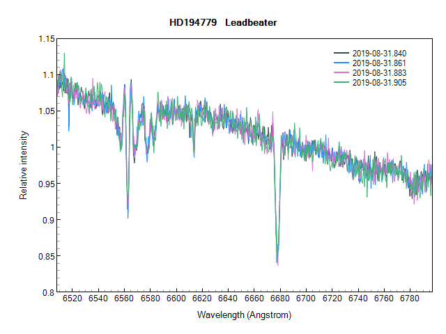

HD194779 last night (R~5500, SNR ~300).
There has been some small evolution in the last 2 days. (The profile is now symmetric.) Valerie's book of spectra shows a similar event in 2014
(Tellurics removed, rectified, filtered to match resolution)
No short term variation above the noise between 4x 30min spectra (SNR~150)

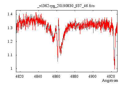

I am confused about V1362_Cyg, a high priority target currently being observed in TESS sectors 14-15. This is a high priority on the list because:
1) historical BeSS observations show Halpha variability, always double-peaked, and without an exceptionally strong disk
2) KELT light curve shows apparent flickering at short timescales
--> high likelihood of observing photometric flickers with TESS simultaneous with spectroscopy tracing disk build-up/evolution (under the assumption that this is a classical Be star)
More recent spec. observations do indeed show Halpha variability on short timescales which at first glance is exactly what was hoped for. Now looking at the spectra closer I'm not sure what to think. There is no question that Halpha is varying. But is this a classical Be star with a highly variable disk (i.e. recent variable mass ejection history)? Reasons to be skeptical this is a classical Be star:
1) The V/R variations are rather extreme for timescales of just days.
2) Strange morphology in the Hbeta line. I don't know what to make of this. Even more strange is that in the most recent echelle spectrum from Charbonnel, the Hbeta line shows double-peaked emission that is seemingly normal for a classical Be star, except that it is very clearly blue-shifted with respect to the absorption profile of the line (see attached img.).
3) Apparent large RV shifts in the He 6678 line (which is possibly more narrow than expected?). I haven't looked into this carefully yet but the effect seems real.
Points 2 and 3 are suggestive of... something involving a binary system. What that 'something' is, I have no idea. Further, I don't know if this rules out a classical Be scenario without a more thorough analysis and maybe more data. I don't see anything obviously unusual in the SED. Simbad lists this as a B5II:n star, so the luminosity class II is a bit of a red flag. Curious to hear if anyone has seen something similar to this or has any thoughts on the matter. I'll try to do some more digging in the mean time.
