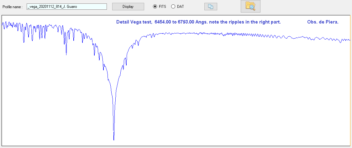

- Posts: 731
Re: eShel + IMX455 Sony
Bonjour Christian,
The results that you have achieved are really spectacular, incredible to do times ago, congratulations for that !
With this system you make observations with hardly any noise in them and I need 5 times more time than you for similar results !
You know that most of the echelle observers we use in our instruments the ATIK460EX that you know very well. One "little" problem is the price of these cameras that have the IMX 455, so many of us will use the ATIK for a few or long time.
But following your instructions, I have made this Vega target with a reduction test by CMOS system with hopeful results.
Telescope Schmidt-Cassegrain. ATIK460EX, ISIS 6.03
Phase 1 : All frames in binning 1x1
Phase 2 : 7 Vega frames, Thor and Tung pretraitement- make BIAS and DARK subtraction, ( I have not known how make the FLAT ).
Phase 3 : 7 Vega frames, Thor and Tung have passed for CMOS treatment, median filter 5x5 and binning 2x2.
Phase 4 : Classic treatment with ISIS 6.03, "Function de blaze lisseé" and "Order merging adjustment" activated.
Have I followed the appropriate way ? Is it possible to achieve good results with our ATIK460EX with this reduction system ?I think there are three many problems, the resolution down from 10000 to 8000, ripples appeared in some regions and it is possible that the noise in the violet could be improved.
What is your opinion about that ?
Cordialement, Joan.

- Posts: 1276
Hello Joan,
I don't understand why you want to proceed CCD data with a CMOS process ?
CMED in ISIS V6 is only for a CMOS camera because CMOS camera have telegraph noise, not CCD.
It's normal that you decrease resolution of your spectrum with CMED process because you use a median filter and binning factor on your raw images.
With an ATIK 460ex your pixel size is 4,54µm, with the CMED process your pixel size grow at 9,08 µm
With an IMX 455 the pixels size is 3,8µm, with the CMED process your pixel size grow at 7,6 µm
The best process to reduce CCD data is the "classical" method.
