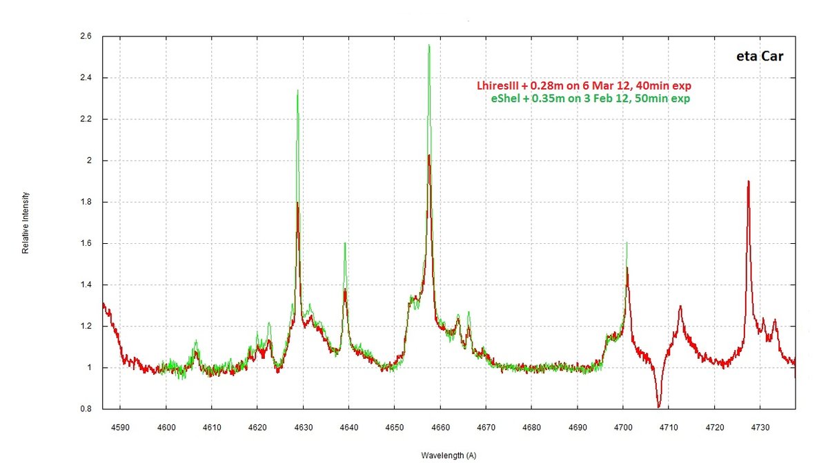

Some more puzzling results ... if you look back to my original post (above top) you will see that, compared to my Lhires+Atik314L, my eShel+ST-8ME has a lot more ripple. The plot below, from current proam work I'm doing on eta Car, shows that the eShel+ST-8ME and Lhires+Atik314L now have very similar results. The only real difference between the two sets of results is that they are on different stars (zet Pup and eta Car), nothing else that I'm aware of has changed.
Any ideas whey the ST-8ME ripple ... or is it just random noise ... has gone? I'm also a bit puzzled why the eShel emission line amplitudes are 25% greater than those with the Lhires.
Bernard

Hello Bernard,
two comments on your Echelle spectrum:
Noise:
The higher noise of echelle spectra may have its origin in the fiber. In the fiber different modes are excited, which give an intensity pattern looking similar to interference fringes. I noticed it earlier in my flats where S/N is high. An more detailed explanation you find here (in german):
http://spektroskopieforum.vdsastro.de/v ... 5986#15986
Look also at other posts in the forum under Technics - LWL(fibers)
I found an english version:
fiber optic mode noise Muenchen.zip
Fiber optic noise
(202.93 KiB) Downloaded 547 times
One method to get rid of this interference is to move the fiber during exposure (gentle shaking).
Another method would be to use a mode scrambler (more complicated, additional losses).
The lower S/N may als have the cause in lower signal (smaller number of e- per spectral bin, with possibly different bin size)
Peak intensity
- the higher peak values of the emission lines with the echelle may have different causes:
- higher resolution
- better spectral purity (absence of scattered light from the grating) due to the cross disperser due to imperfections of the grating.
- eta Car is a speciaal star with an extended nebula around it. With your slit spectra you may subtract some background from the nebula, reducing the intensity of the emission lines. With the fiber this background is not subtracted, unless you make a control exposure with slightly offset position of the fiber on the sky.
These are just ideas, do not blame me if not everything is indeed the case.
Good to now that other people have similar problems.
Regards,
Martin

Hi Martin,
Thank you for your comments and the link to the very interesting paper on fiber noise ... the idea of shaking the fiber cables during an exposure is certainly counter intuitive, but fascinating. According to the first graph the predicted S/N at around 4700A, where I'm working, is only around 80, which is about what I'm getting. I still don't understand why the 'noise' is varying, unless it is related to where the fiber cables are positioned. There is definitely a need for further investigation on how it affects amateur equipment and how to reduce it.
Your ideas on the line intensities are also interesting and, even though I don't think I agree with some of them, I need to look into each of the points you make ... I won't hold you responsible for any errors ;)
Bernard

Hello Bernard,
the expected S/N depends also on the fiber diameter, mode number is proportional to fiber diameter^2. In the FOCES spectrograph a fiber diameter of 100 microns is used, compared to the 50 microns we use. Therefore you should not expect the same S/N as in the paper. In addition it depends on how much of the light is vignetted. See here for a detailed description of the Foces:
http://adsabs.harvard.edu/abs/1998A%26AS..130..381P
By the way I mostly observed the effect with my lab setup, by dividing a flat spectrum by a flat reference. On the telescope other limitations to S/N prevented me from seeing this. In the flats the additional noise is smoothed out before using it for the blaze function, so it would show up only in the object spectra.
I did not mention incorrect subtraction of background as a cause for difference in peak intensity, a common beginners error, since I trust your correct treatment of spectra.
