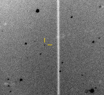

I can't guide on that though. The target is invisible while guiding. I take a deep stacked image using the guiding camera and measure the offset to a brighter star that I then guide on.
This is the 30x30sec stack I used to calculate the guiding offset for PS1_J134743+495621 (The total exposure for the spectrum was 140 minutes)

Robin Leadbeater wrote:I take a deep stacked image using the guiding camera and measure the offset to a brighter star that I then guide on.
I think I used the "bright" ~mag14 star at the top of the image to guide on
