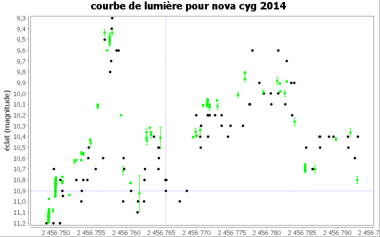

Re: Nova Cyg 2014 = PNV J20214234+3103296
j'étais également dehors ce matin
Toujours des oscillations dans la courbe de luminosité

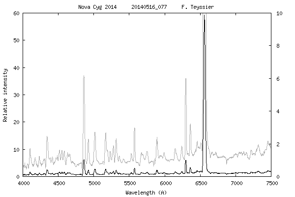

Posts: 1432
Spectrum for the date May 24 (C11 + Alpy 600):

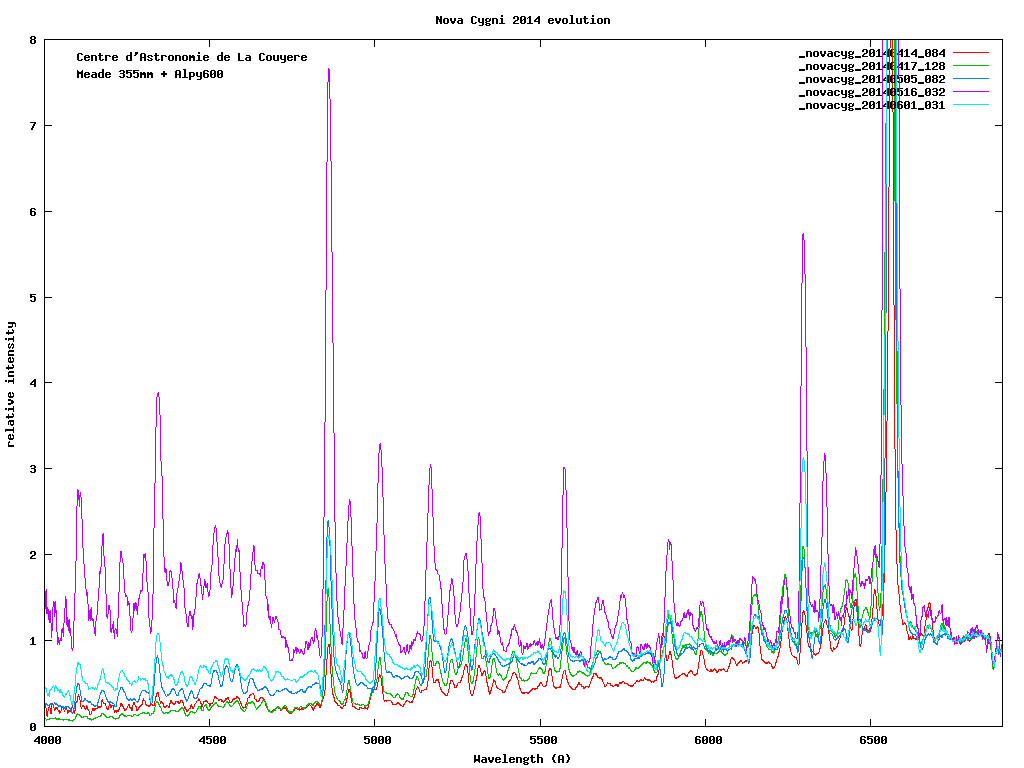

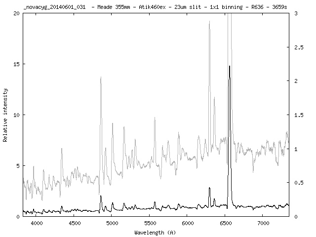

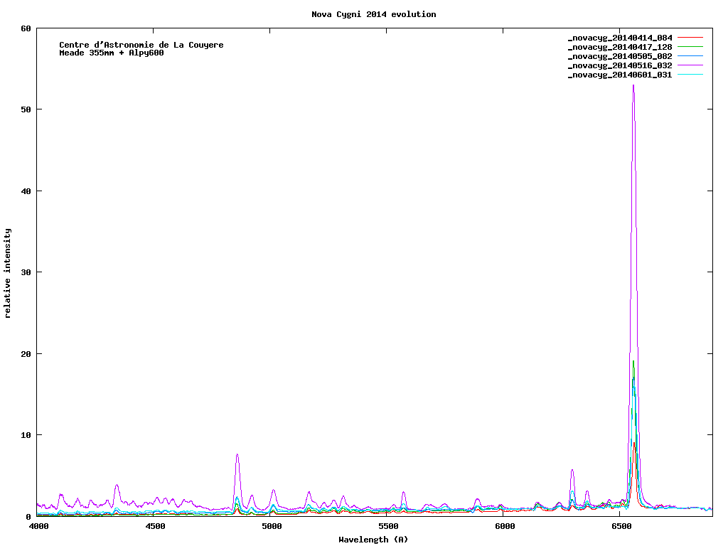

Nova Cyg à la date du 1 juin
Évolution du 14 avril au 1 juin

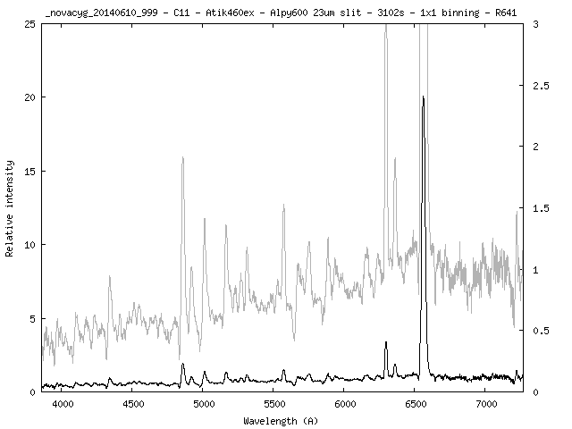

Posts: 1565
Tonight spectrum
Luminosity decreased of 0.9 mag in 10 days ; current = 10.75
[OI} very intense. Low density and low excitation.
Very peculiar behaviour for a nova.

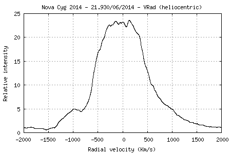

Posts: 578
Hi all, 21.930 june nova spectrum of h-alpha region with Lhires III 1200, R~6000 (a setup for a Be stars observing session). The range includes [O I] 6364A, H-Alpha, He I 6678A and probable [S II] doublet 6716, 6730A.
Radial velocity of h-alpha line:
Posts: 1565
That's great Paolo,
The two absorptions in the blue edge of H alpha line are clearly seen ; the complex structure of the flat top of [OI] also
See you soon

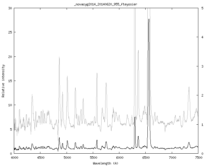

Tim Lester
Posts: 168
Location: Arnprior Ontario
Post by Tim Lester »
June 23rd spectrum.
Seeing was very good and slit efficiency was relatively constant so I decided to calibrate to flux.
I am using HD190603 and its Miles spectrum M(V) 5.66 for the calibration.
Tim Lester
