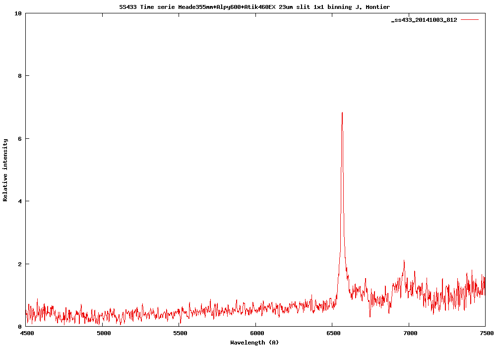

A time series try of SS433 with 10 spectra of 600s exposure.

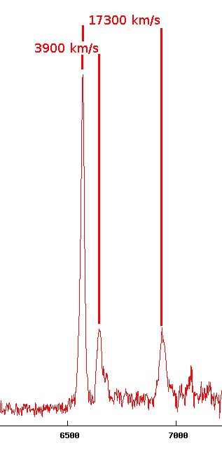

Weekend's series (25cm f4 newt, OrionG3, Alpy 600), something happening around H-alpha in the last 2 days:
- interesting features around Ha
- ss433.gif (35.76 KiB) Viewed 6404 times

Nice series Jacques and Peter !
Peter : "something" always happens in this fantastic star
See : https://www.youtube.com/watch?v=iz5UbKmvyik
Blobs of matter are ejected throw spiraling jets at a speed of several thousands of km/s
Hydrogren of these blobs produces "satellites" of H alpha line, in the bue and in the red
Steve will write a note in the next issue of the newsletter

Thanks François,
I estimated some Halpha speeds on 2014/09/30
Very impressing !
