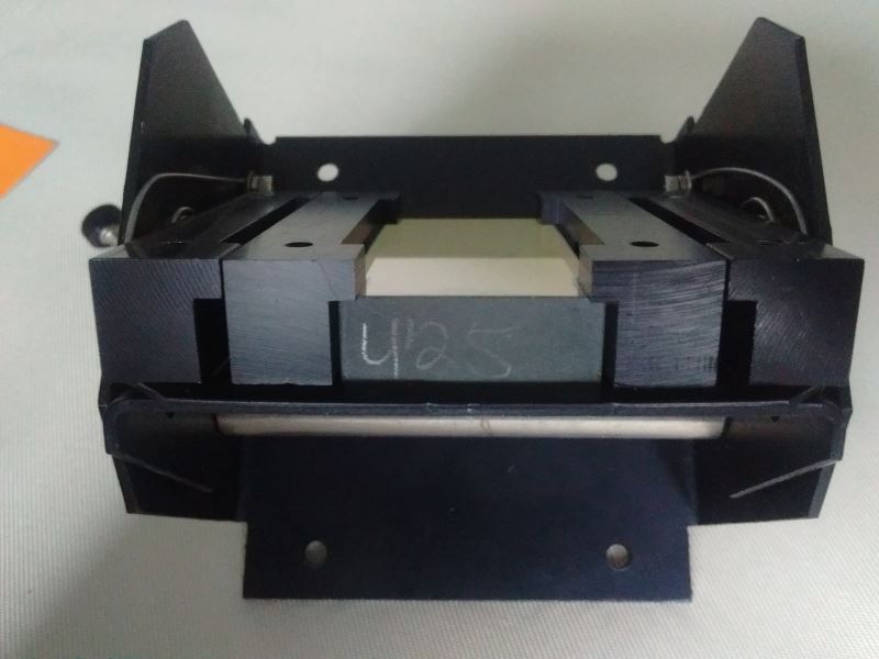

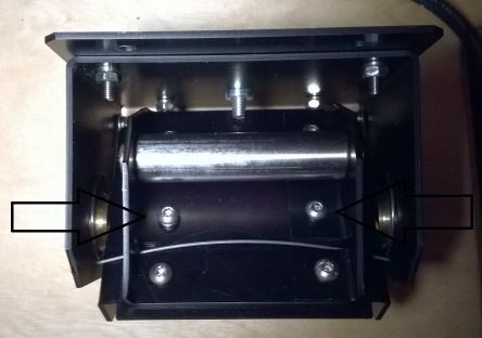

Thank you for your detailed reply. I think I may have just identified the main problem, which was the grating clamp was too tight and giving a slight deformation to the grating. This combined with my misunderstanding of which screws loosen to adjust the pressure holding the grating in place.
I had been trying to adjust the end screws on the grating, which would not budge, rather than the centre screws. In Olivier's personal email to me today he mentioned springs to free the grating which made me realise my mistake. I attach a photo for reference for all to show the screws I've just adjusted. Backing these out allowed me to move the grating, I then retightened them to hold the grating gently (after my experiment I've tightened them a little more to make sure the grating is secure).
Grating holder with arrows pointing to the screws I adjusted.
2400 l/mm grating adjustment screws

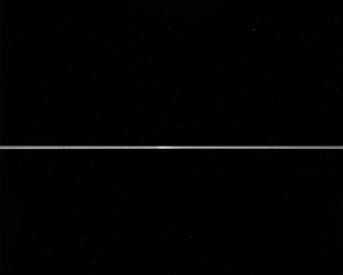

Unfortunately cloud rolled in earlier than scheduled, so I had to make a very rushed job of taking a spectrum without correctly fine tuning everything. I had no time to adjust the neon and telescope focus, but both appeared to be roughly in focus, and I managed 3 short 10 second exposures of Betelgeuse before thick cloud came over (I chose a bright star to have a chance of getting a quick spectrum). As can be seen the spectrum is still not perfect, but this already looks better than the spectra I was getting before, and this is not surprising as the focus is unlikely to be accurate. When it is clear again I shall carry out a more thorough test taking care to focus everything properly.
Roughly focused spectrum with 2400 l/mm grating.
2400 l/mm grating spectrum with crude focus
I'll only be able to tell if I've properly solved the problem when I get clear skies again. However, this quick result gives me confidence that at the very least the main problem is now identified.
Thanks to everyone for their help and advice. I'll post a further update when I can run a thorough test.

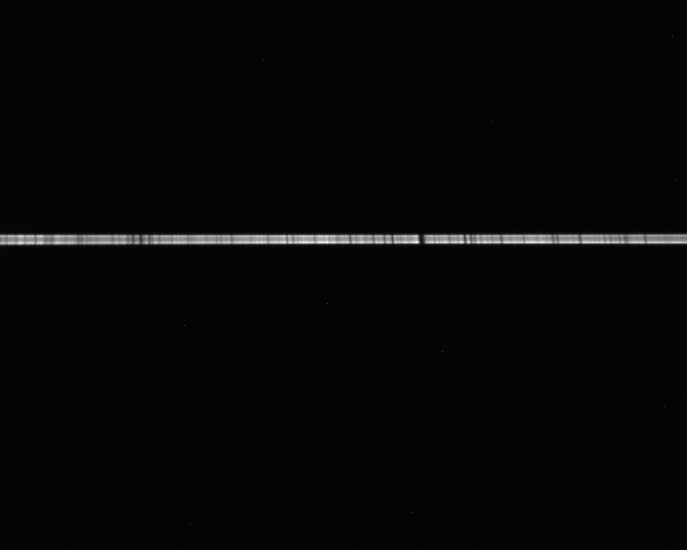

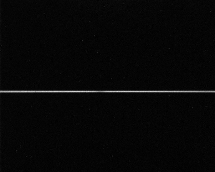

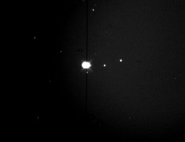

A clear night tonight so I've been able to spend time focusing the collimator lens and telescope following my adjustment to the grating holder a couple of days ago. The results are a huge improvement over anything I've been able to achieve before.
Below is the best spectrum I attained. Most of the time I had a slightly broader spectrum, as per the second example below, but I put this down to my experience and probably changes in telescope focus due to temperature shift. The guider image also looks very good, as per the final image below.

In addition to the above visual impression of the spectrum, I found I needed shorter exposure times. I had to cut the exposure time in half for a star I frequently observe as I had reached the non-linear range of the CCD. Also, there had previously been a very slight asymmetry to the neon lines which has now gone. Both good indications that the spectrograph is now working well.
