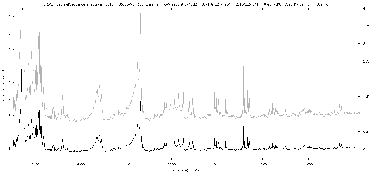

Hi all:
Leave a graphic on 16 January. I think all we do a good job.
Friendly, Joan.
Friendly, Joan.
- _c2014q2_20150116_741_REFLEC_J. Guarro.png (12.55 KiB) Viewed 9084 times

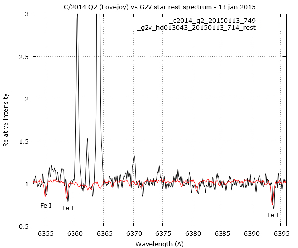

Coming back to radial velocity, I try to measure the shift of sun absorption lines on comet observed spectrum, respect to their rest wavelengths (using some Fe I lines) for 13 jan observation, finding a Vrad value around 10 Km/s. Being reflected light, we should consider the Vrad between Sun and comet (~ -5.2 Km/s - from ephemeris - comet was slowly approaching the Sun) and Earth-comet Vrad (~ 14.4 Km/s moving away, eph.). Hoping the reasoning is correct and leave aside other local effects that can occur close to nucleus (what's impact?), observed Vrad should be the sum, 9.2 Km/s, a value not far from measured one.
Some of Fe I lines on comet spectrum and a G2V star rest spectrum:

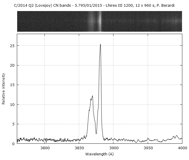

Weather continues to be very bad here, so I took the opportunity to reduce an old observation (5 jan)... Just an attempt to capture CN 3880 bands with Lhires III 1200. The two bands are not individually resolved in this R~3200 spectrum:
Rigel in the same spectral interval:

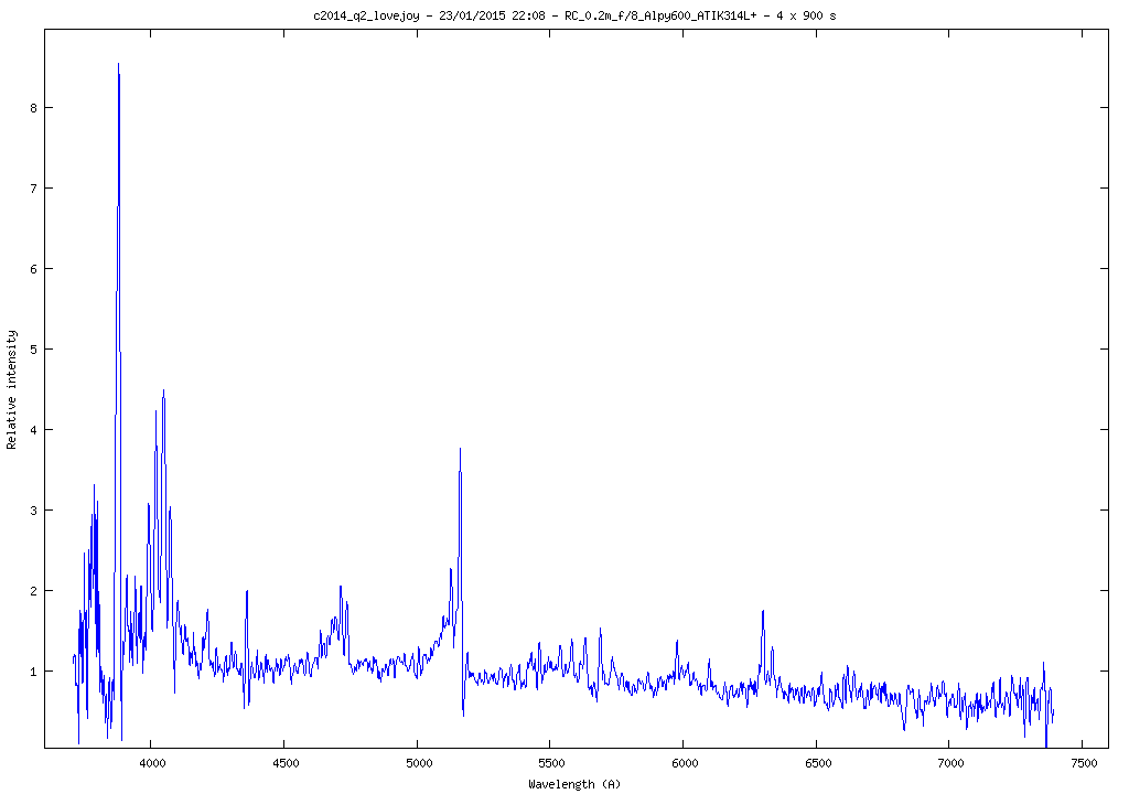

Spectrum from last night with Alpy600.
Miguel
Miguel
- C/2014Q2 Lovejoy Alpy600 4x900s
- _c2014_q2_lovejoy_20150123_923_Miguel_Rodriguez.png (8.91 KiB) Viewed 8995 times

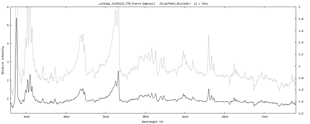

Bonsoir à tous
Good evening everyone
Spectres hier soir Alpy600
Ce soir, météo mauvaise (un peu de repos !)
Tonight, bad weather (some rest!)
Cdt
Cdt

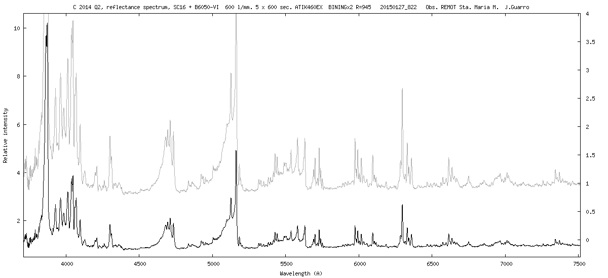

Hello:
The Comet in last night.
J.Guarro.
J.Guarro.
- _c2014q2_20150127_822_REFLEC_J. Guarro.png (12.39 KiB) Viewed 8955 times
