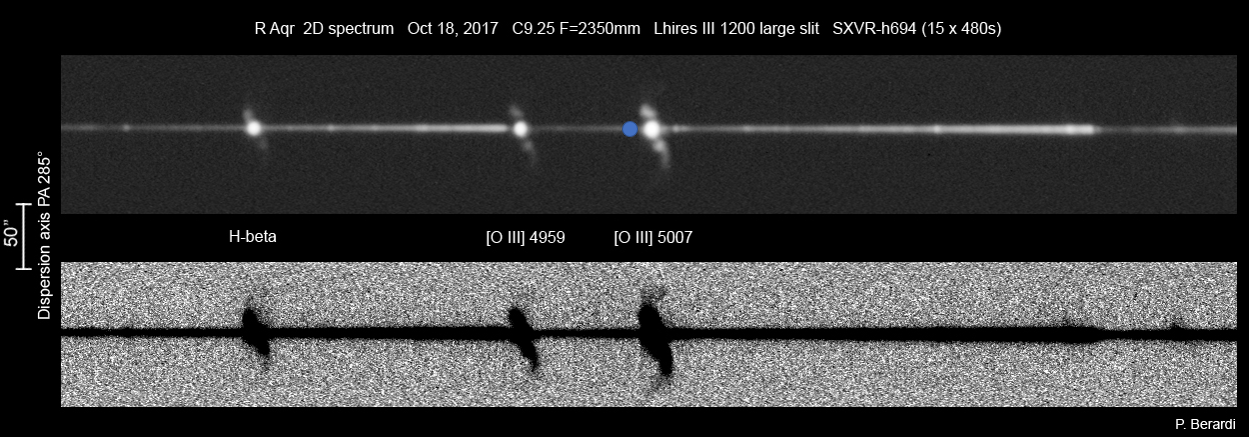

- Posts: 1565
Re: R Aqr spectra requested by Margarita Korovska
Approximative size of the hole of eshel (50 mcm) with my setup
Autoguiding RMS < 1 arcsec
So I can't get the jets shown by your image
It should be interesting to get an image with the slity aligned with the jets

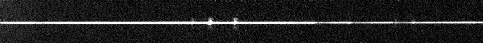

- Posts: 578
Hi François, the narrow slit (31 micron) should be on the jet now (PA 35°, for the large slit observation it was at 15°).
The Doppler shift is appreciable on the 2d spectrum. The north-east "lump" is noticeably redshifted on the oxygen line.

Perhaps I should try with the 2400 l/mm grating to increase the spectral resolution (but I don't know if the SNR is enough). Also try to observe H-alpha line.

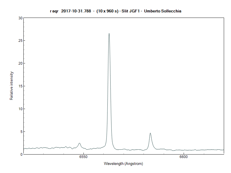

- Posts: 247
Bonjour, J'ai essayé une observation sur la région H-alpha de la même manière que Paolo, mais avec une grating de 1800 l / mm et une fente de 50 microns. Voici le spectre 2D et son profil. Umberto

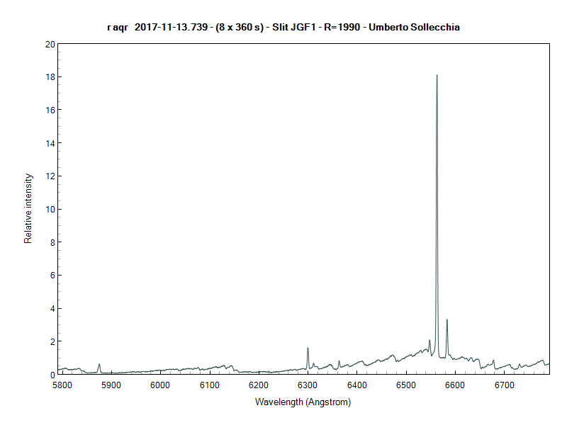

- Posts: 247
Bonsoir, le profil de l'observation de cette soirée 13-11-2017. Umberto
