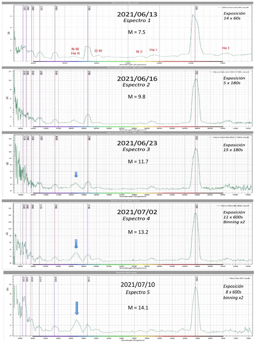

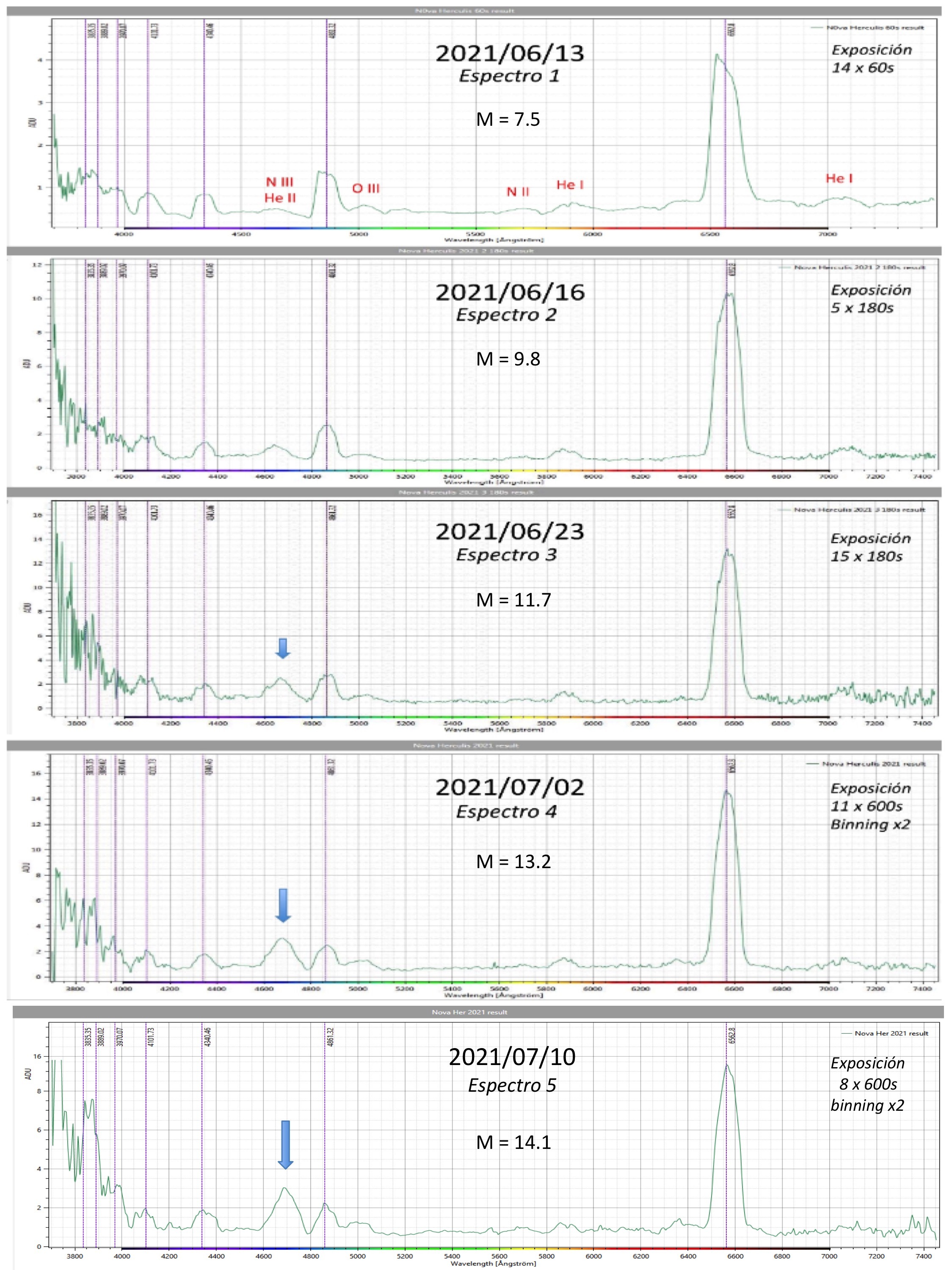

5 low resolution spectra of nova Her 2021
Post by Juan Jose Pueyo »
I have obtained five spectra of Nova Herculis 2021 with the idea of seeing if there is any evolution as the luminosity of the nova decreases (current magnitude below +14). The only variation observed, at low resolution, is the increase in the line located approximately 468 nm, which seems to correspond to species with higher ionization. However, and because it is low resolution, I cannot specify what is happening. Has anyone interpreted the reason for the growth of that line over time? JJ
It is He II 4686 and/or NIII/CIII blend
The envelop recedes and its temperature is rising (perfect gas law): the ionization strengthen (~ 50 000 K), thus He II is doubly ionized and recombination produces the increase of He II emission and other high ionized lines. See: http://spectro-aras.com/forum/viewtopic.php?f=33&t=2703
With higher resolution spectra, I suggest a comparison of He II and H beta profiles in order to decide if He II is alone or blended with CIII/NIII. The further sequence of spectra will also help to decide.
The identification of lines often requires to take a step back ...

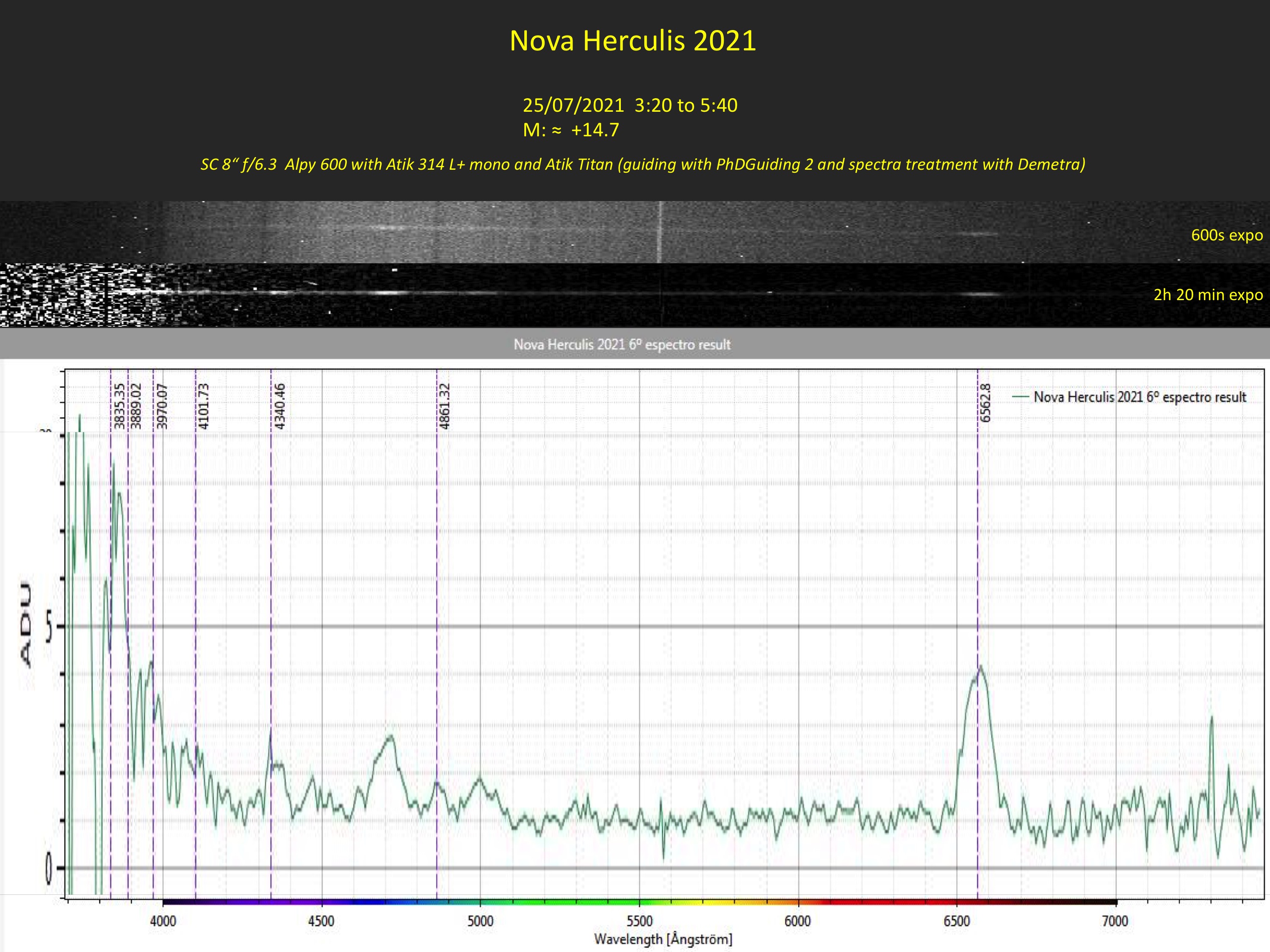

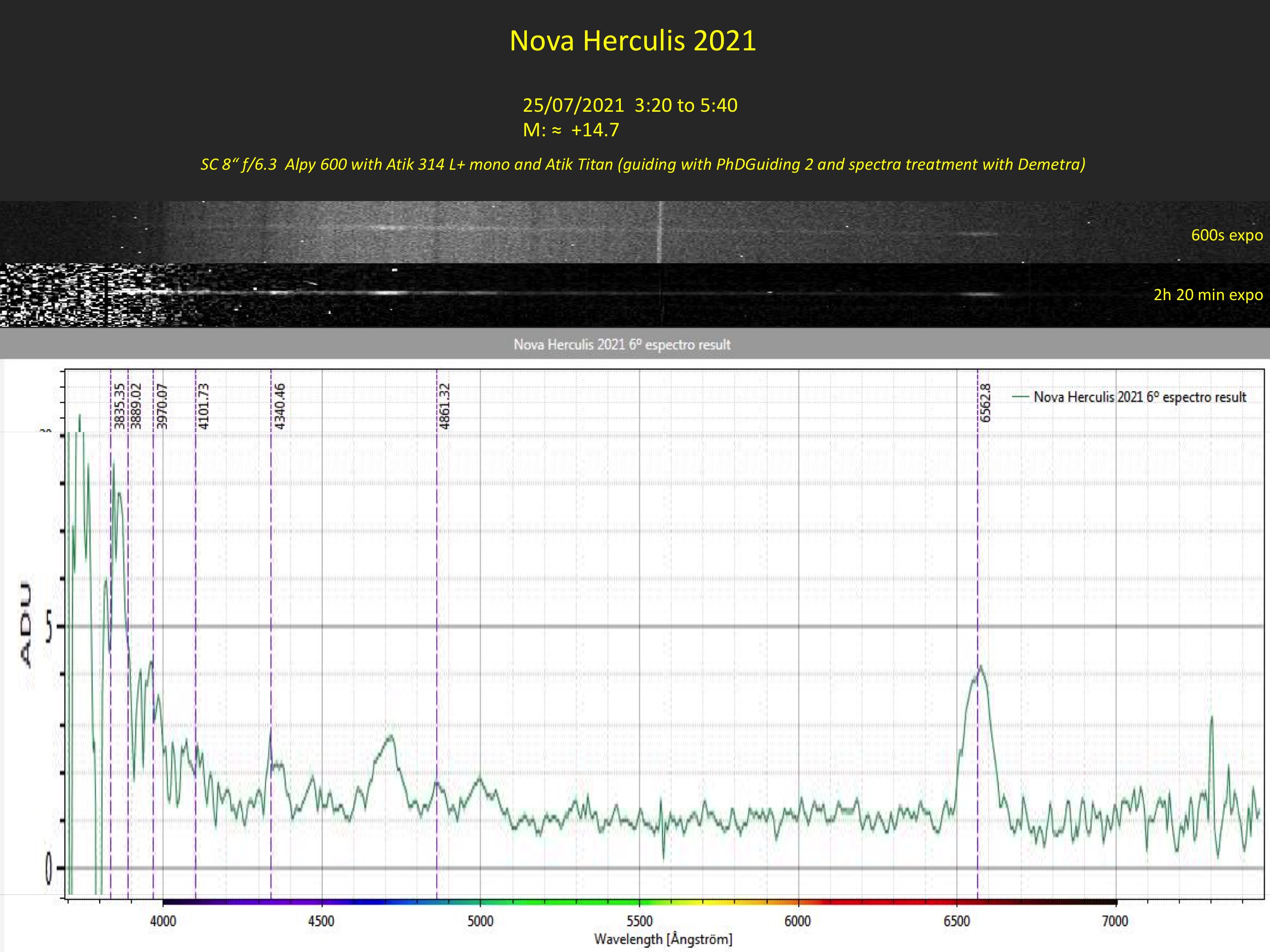

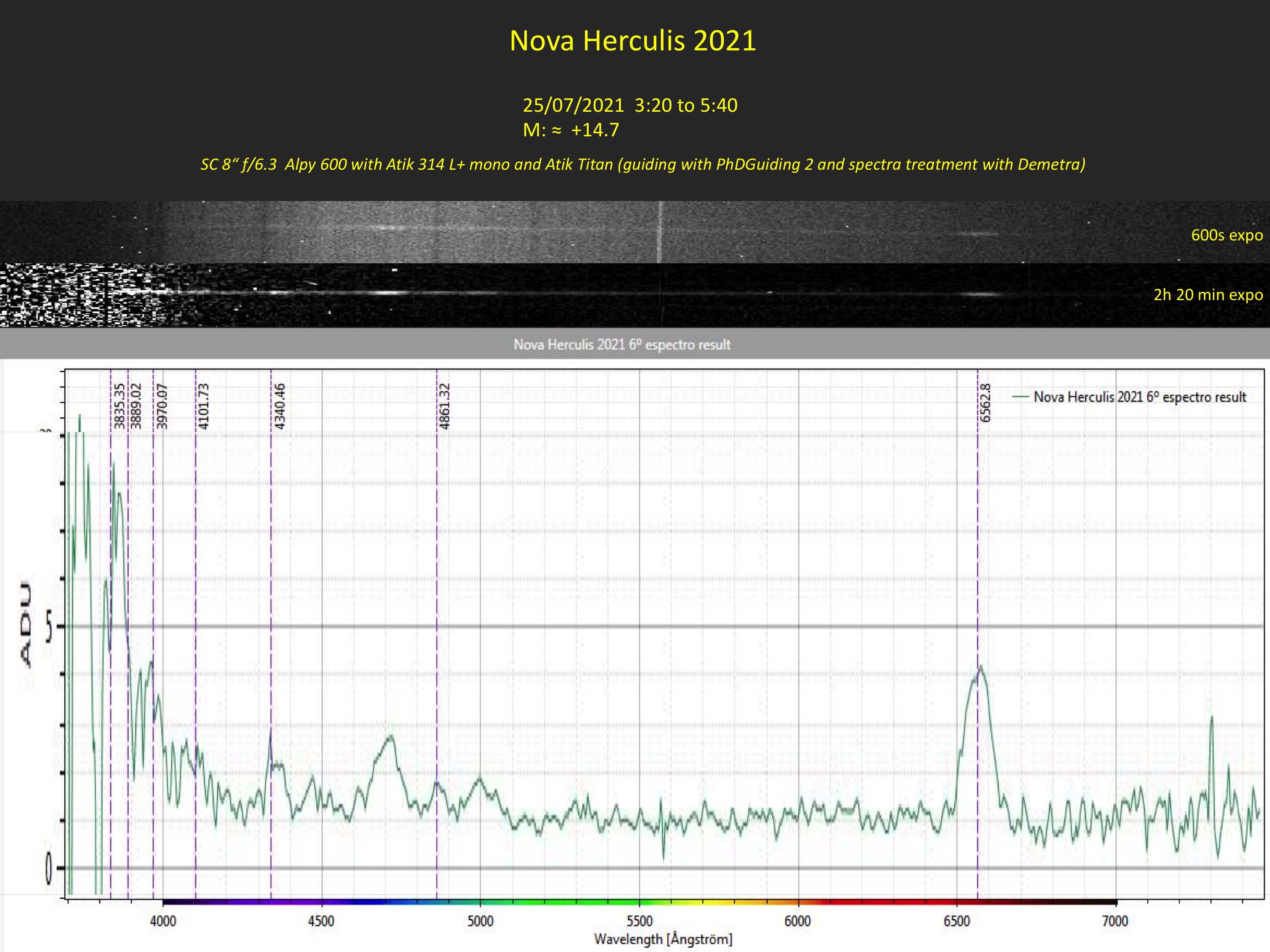

I took a sixth spectrum of Nova Her 2021 with a double purpose: to follow its evolution as the nova fades, and to check what is the practical limit of my spectrograph (an Alpy600). I think that this limit will probably not be conditioned by the camera that captures the spectrum, but by the guiding system. I am using an Atik Titan at binning x3 and 10s of individual exposure. How could I improve this system to be able to track dimly objects? At the time of the spectrum acquisition, the magnitude of the nova was approximately +14.7 and the Moon, located in Capricornus, was practically full (97%). Its effect can be seen in the upper 2D spectrum (individual 600s spectrum without sky background and instrumental correction). I added a rough evolution of the 468 nm line along time (42 days).
Regards. JJ Pueyo

Congratulation for that impressive result with a magnitude near 15 at full moon ! Apparently your sky is showing almost no pollution. Excellent site for observation.
Not sure to unsdestand your question regarding the guiding camera. Why to increase the exposure time above a few seconds ? At such low luminosity you should not expect to see the target within the slit. What really matter is the guiding star, not the target.... But I may have misunderstood your point.
Daniel

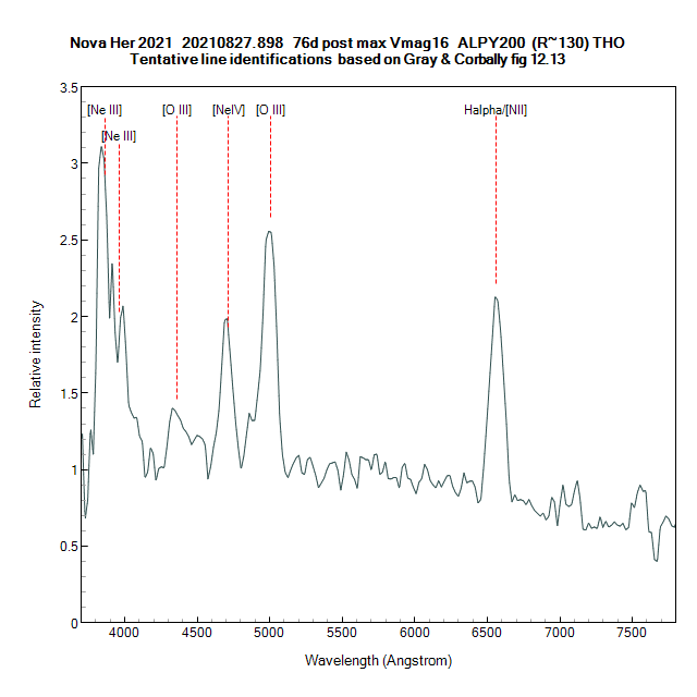

Re: Probable nova in Hercules mag 6.4 !
Now mag 16 so time to use the ALPY200 at R~130
Line identifications are based on a spectrum of another very fast nova Sgr 1991 in Gray and Corbally at similar date which looks very similar but should be treated with caution at this resolution.
If it is the same as nova Sgr 1991 there could be very strong [Ne V] lines at 3346/3428 A . Too far into the UV for me but perhaps a good target for the UVEX ?
