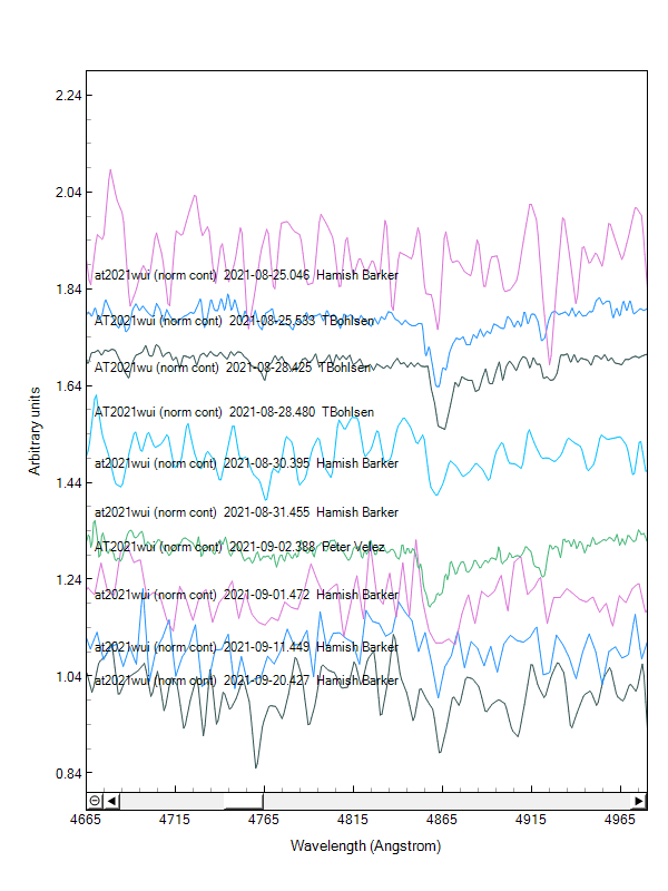

I normalised all to continuum and made a stacked plot around Hbeta. I can't see a trend there, whereas there may be one at Halpha.

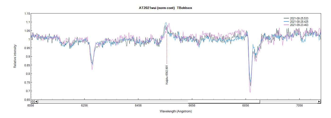

I took another spectra of this star. The Ha seems to be dancing around a bit. Maybe just being double peaked and oscillating. Should this star be added to BeSS or somewhere else to keep the spectra we have taken in a central place?

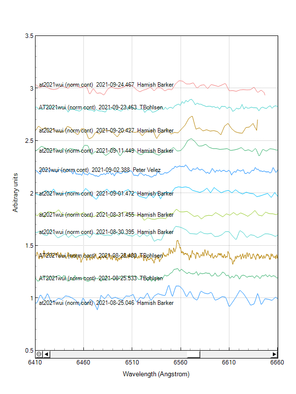

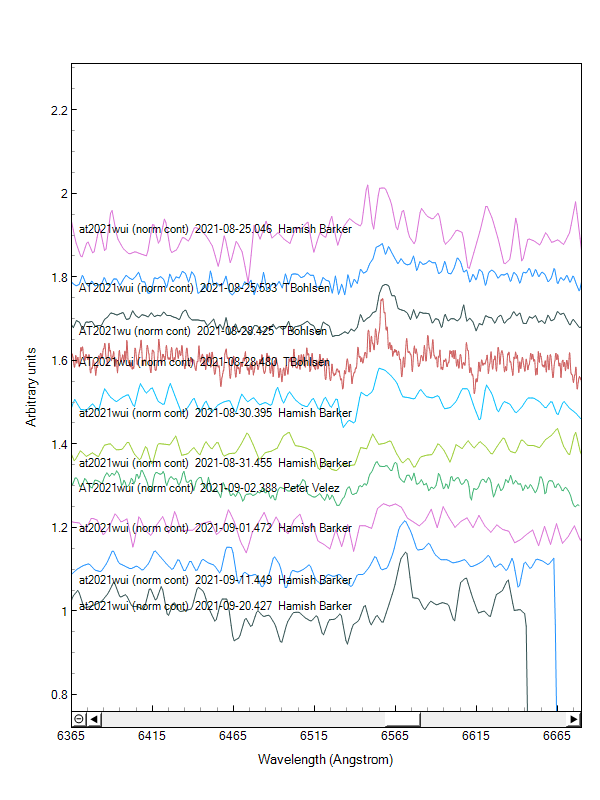

stacked plot of Ha region with all the spectra taken to date by Terry, Peter and myself.
the two sharp peaks of red and blue shifted Ha are about 23 days apart. It will be interesting to see if the sharp peak reapears with blue shift, perhaps 23 days after its peak red shift, around 13 october.

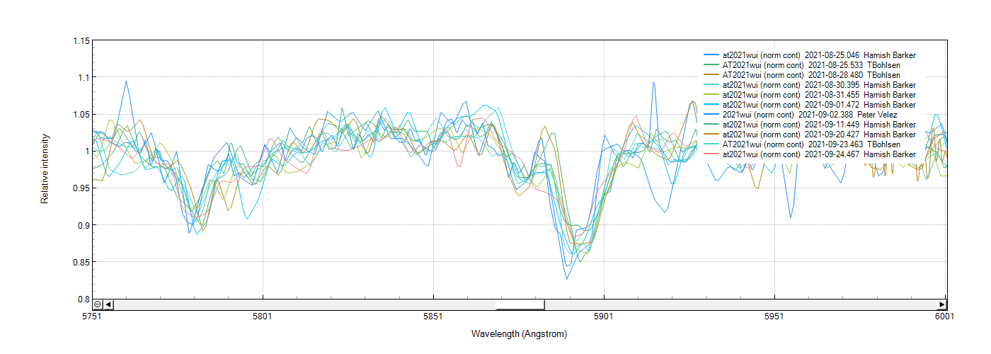

I don't know what the absorbtion is around 5780. I see a dip in B start spectra there, but haven't look up what it is likely to be (or if it could be atmospheric oxygen?).

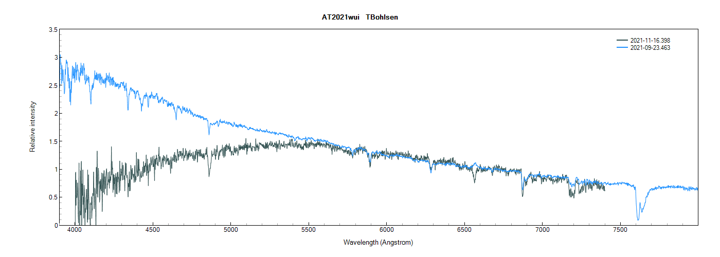

This star has continued to become brighter but is very low in the west now.
I took a spectrum last night when it was only about 14deg above the horizon. As a result the continuum is not properly corrected as I don't have a suitable comparison star at that low altitude. Despite this it seems that the star is no longer in Ha emission. It won't really be possible to take any more spectra of it until the next season.
