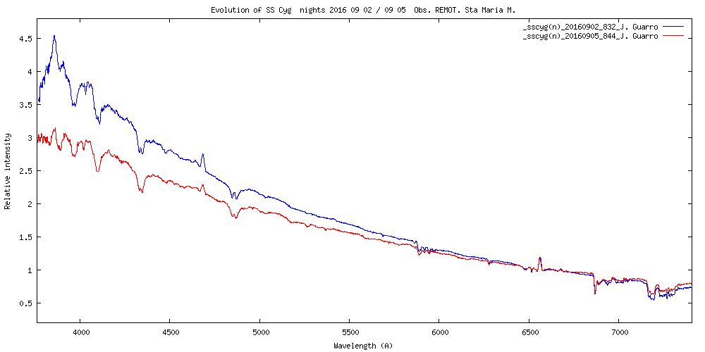

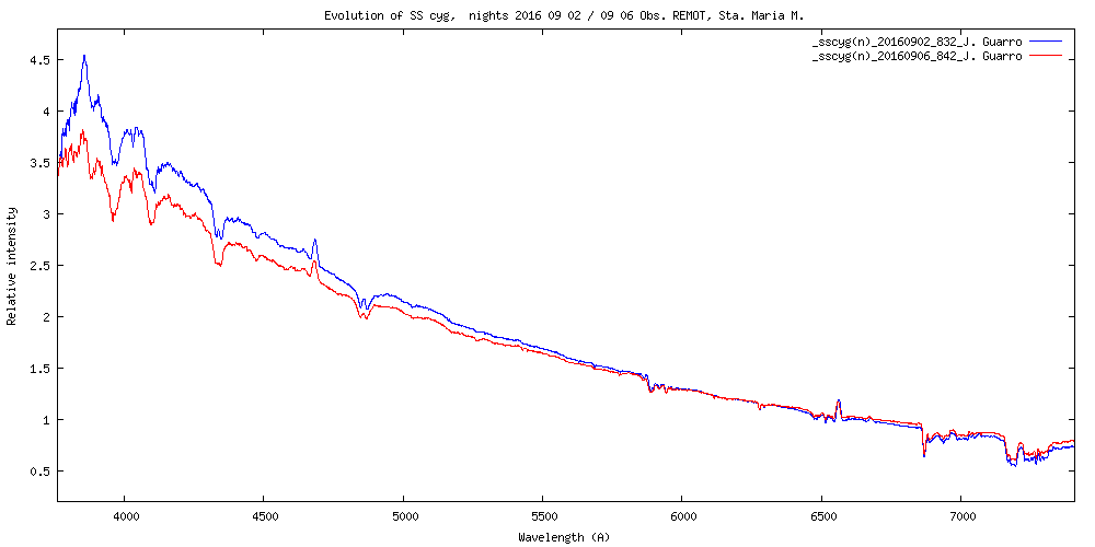

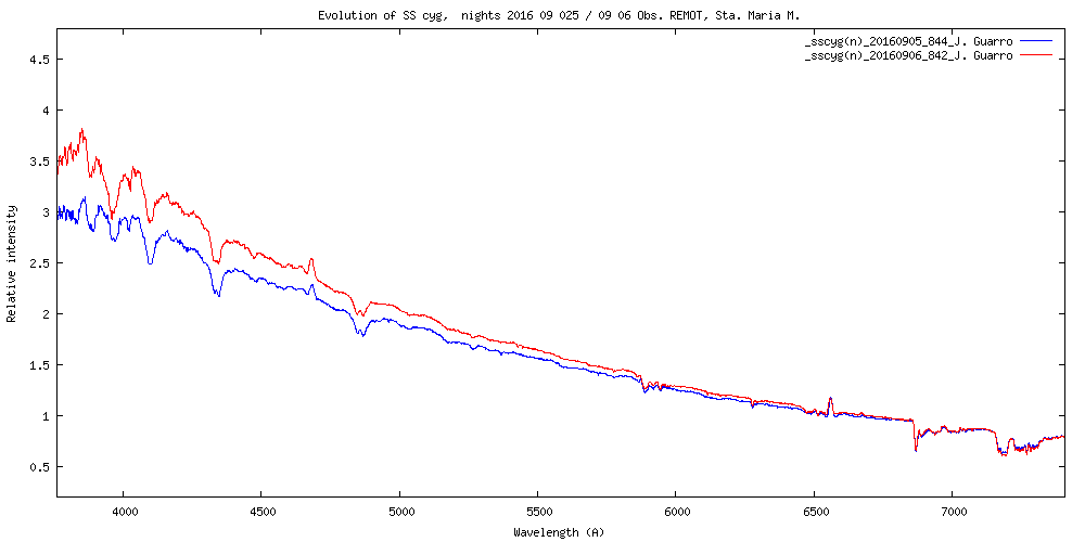

- Posts: 729
Re: SS Cygni in outburst
To all :
After a small decline in last night, SS Cyg will again increase somewhat in brightness. This seems to be reflected in the graphics.
It is a pity not to have any reference photometric.
Friendly, Joan.
Friendly, Joan.
- _SSCYG NITS 20160902-0905.png (7.31 KiB) Viewed 11548 times
- _SS CYG NITS 20160902-0906.png (7.28 KiB) Viewed 11548 times
- _SS CYG NITS 20160905-0906.png (7.1 KiB) Viewed 11548 times

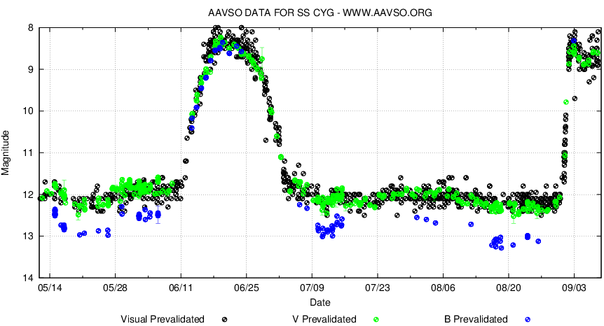

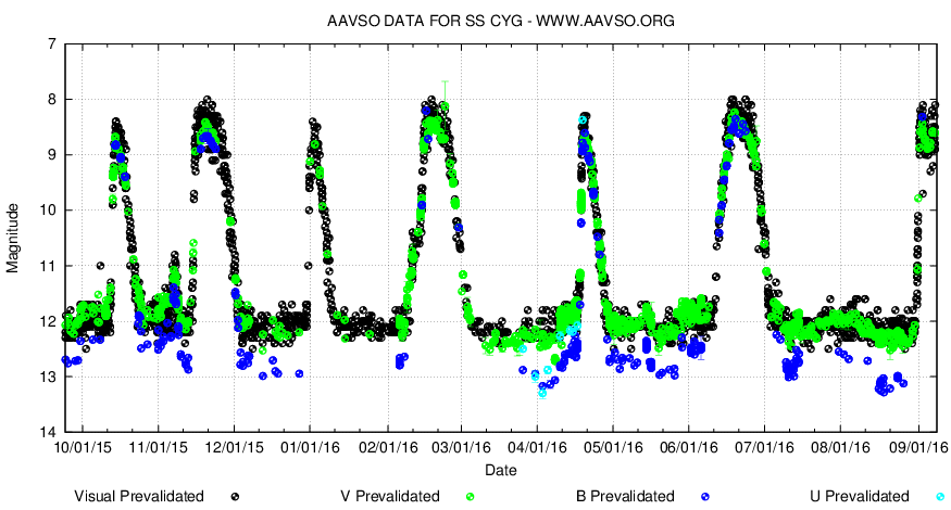

Hola, Joan,
here you are two photometric graphics excerpt from the AAVSO database. It seems that SS Cyg had two different maxima during this outburst
and here you are an extended graphic with all the last outbursts. Here, the alternance between short/small and long/big outbursts is clearly visible, but keep in mind that this periodicity is not always respected! I wouldn't be surprised if this current outburst will be a big one, like the last observed in Juny... at this moment I have the feeling that we are watching a big outburst!

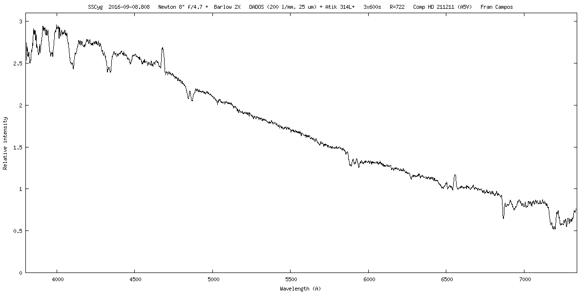

Finally, my contribution from the last night. The calibration has been done with HIP 109831 (A2Vnn) = HD 211211 (there is a mistake in the graphic's title about the spectral class of HIP 109831: I treated it like an A2V star).
Greetings!

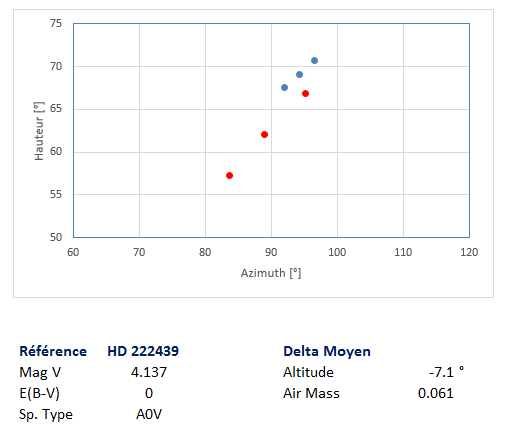

I now use the last version of his tool Reference Star Finder which displays positions of target star and reference star in the same canvas taking in account beginning, ending and duration of exposures for both stars. This is really useful and highly more precise. I don't take a star which the altitude difference exceeds 4 or 5°.
I'm taking in account the class of the star (is the star available on the Pickles or Miles libraries ?) and the E(B-V) value (equal or really near 0) too.

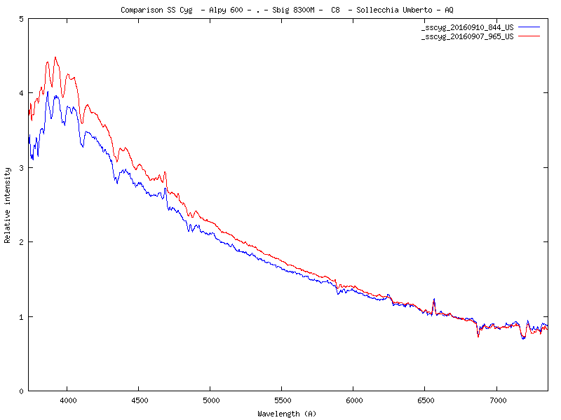

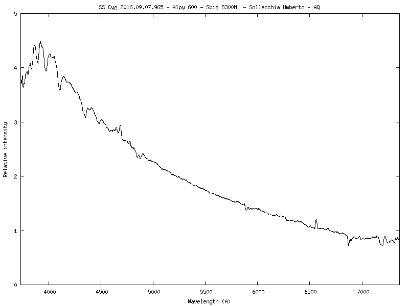

- Posts: 247

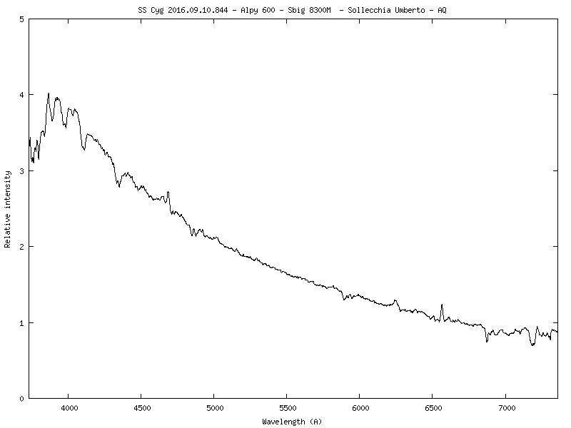

Bonjour à tous, placez les profils des observations 07.09.2016 et 10.09.2016.
Pour la réponse instrumentale Je l'ai utilisé les miles Hd 192640.
Le jour 10/09/2016 J'applique également une réponse avec l'étoile HD 222439, recommandé par François, mais le profil est pas identique à celui avec la miles.
Je ne suis pas sûr que je l'ai fait bien, mais le HD 192640 a un profil connu dans la bibliothèque du programme ISIS, le hd222439 (A0V) il y a un profil générique Pikles.
salutations
salutations

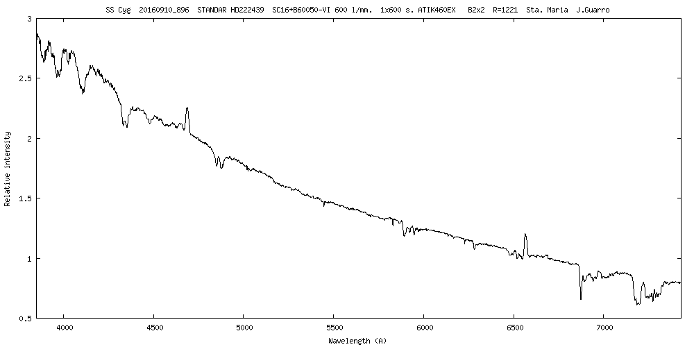

- Posts: 729
Bonjour Touts:
J'ai refait toutes les observations (27 nuits), appropriées à l'étoile HD222439. Je pris comme référence HD222439, de les observations de la nuit dernière.
V
ous laisse un graphique de ce soir.
Je suis heureux, Joan.
V
- _sscyg_20160910_896_J. Guarro.png (6.13 KiB) Viewed 11478 times

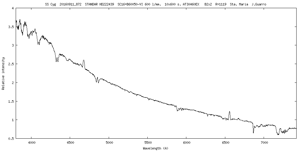

- Posts: 729
A touts :
SS Cyg, dans la nuit 2016 09 12.
Salutations, Joan.
Salutations, Joan.
- _sscyg_20160911_872_J. Guarro.png (6.07 KiB) Viewed 11459 times

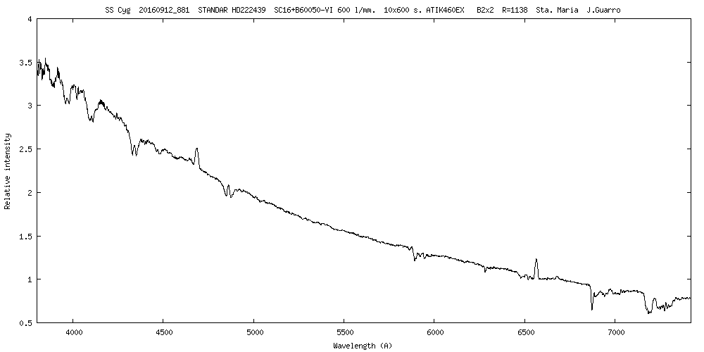

- Posts: 729
Hi, is the SS Cyg in the night 2016 09 12.
JGuarro.
JGuarro.
- _sscyg_20160912_881_J. Guarro.png (6.06 KiB) Viewed 11446 times
