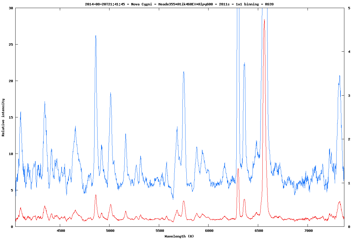

My last observation, 12.9 aug 2014. Two Miles reference stars for flux calibration, HD 176301 and HD 196544.
4.9 and 12.8 august comparison of the same spectral range.
During large slit operations (long exposure guide camera frame). Target is slightly slit off-axis to avoid contamination by a field star.

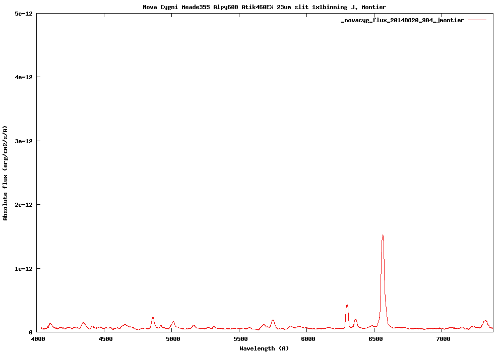

Nova Cyg of the last night
My first try of measuring flux with Christian Buil first method and 23um/230um slit

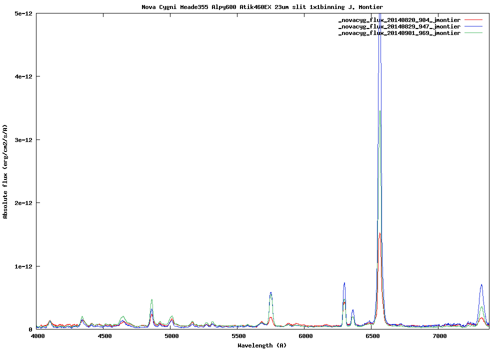

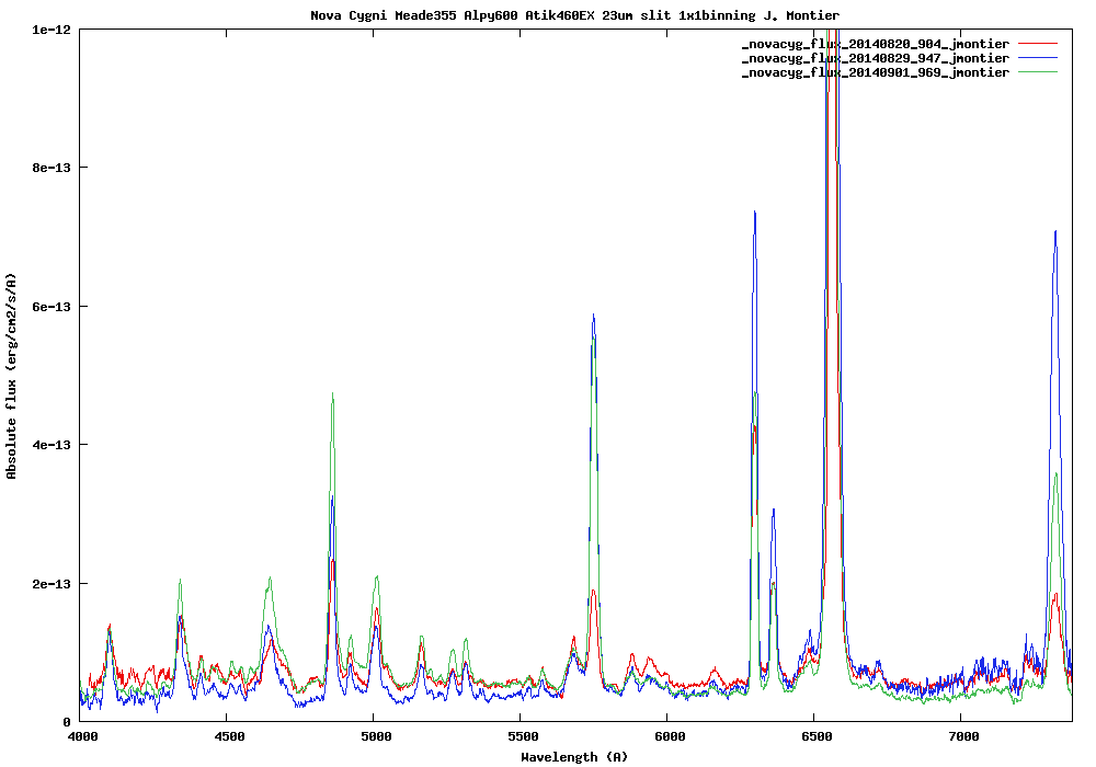

Flux comparison of the nova on 20140820, 20140829 and 20140901
Jacques Montier

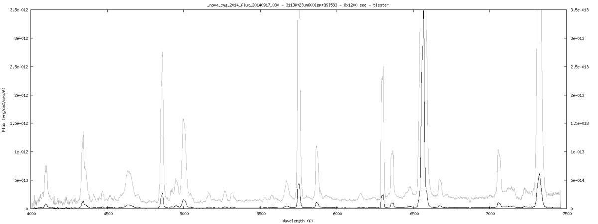

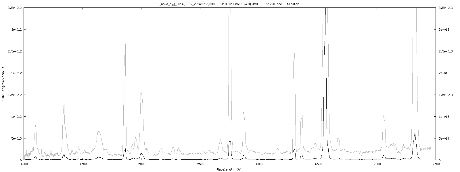

Nova Cyg for Sept 17 calibrated for flux.
Multiplying by the V Bessel function gives a V magnitude of 12.65, in very good agreement with AAVSO data.

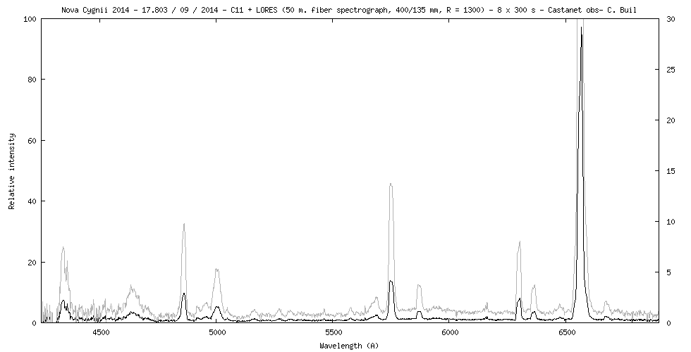

Posts: 1565
Re: Nova Cyg 2014 = PNV J20214234+3103296

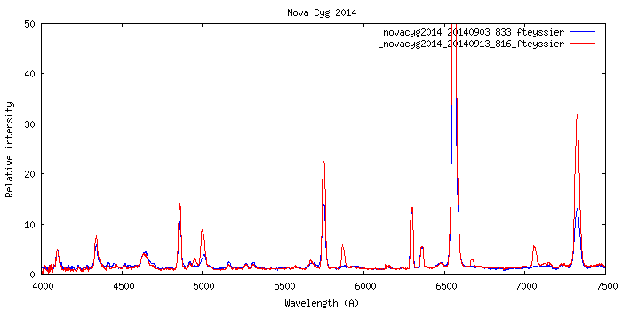

Very fast evolution,
noticelly [OIII] lines
A daily coverage should be usefull for a few days

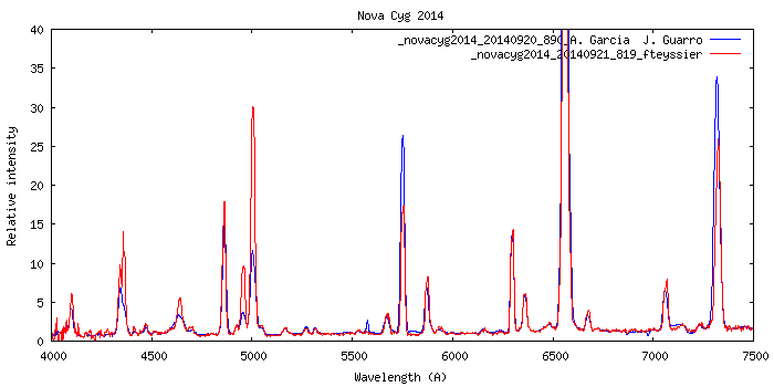

Thanks to Joan and Antonio 's spectrum, we can establish that the "[OIII] flash" occured precisely between 20.9 and 21.8 of september
.png
.png (5.37 KiB) Viewed 9449 times

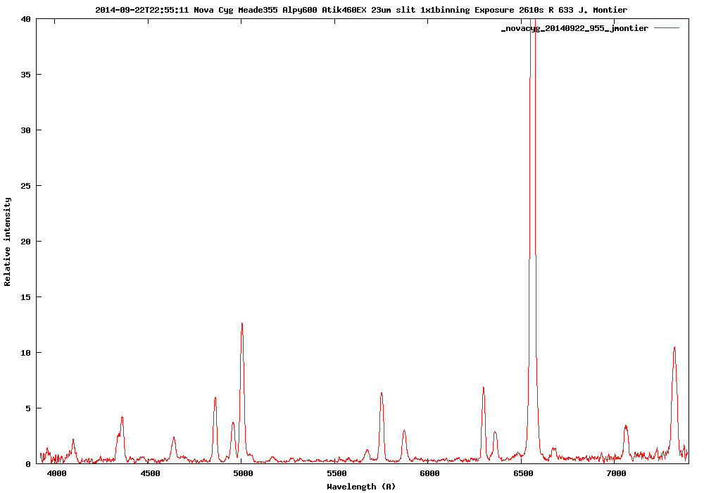

Here is the nova spectrum of the last night
Jacques Montier

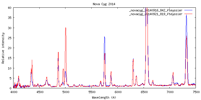

Posts: 1432
A spectrum taken the 19.9 / 09 / 2014, not perfect but can help for follow fast evolution.
Peculiar spectrum because it is one of the first light of setup presented here
http://www.spectro-aras.com/forum/viewt ... ?f=6&t=917

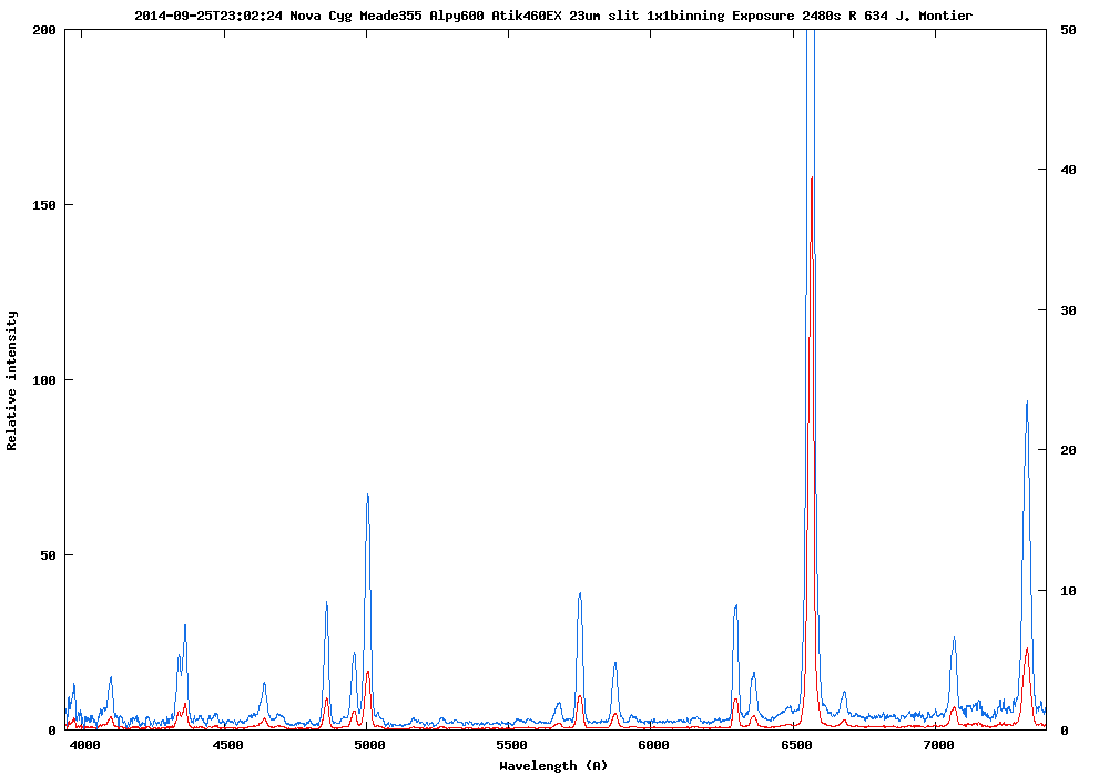

Nova Cyg on 25/09
Regards,
Jacques Montier
