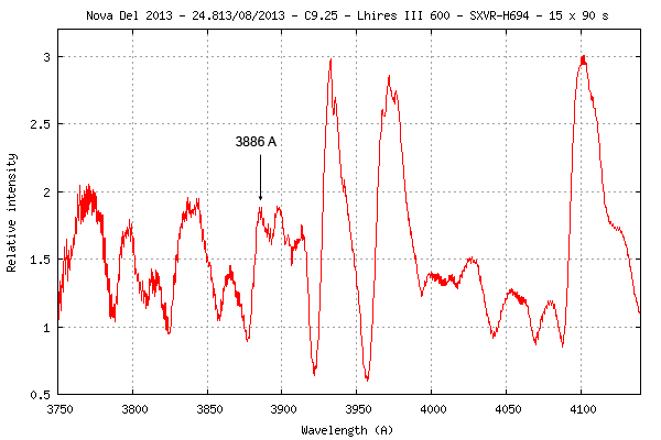

Paolo, are you a peculiar feature at 3886 A in your actual data ?
Christian, this is yesterday spectrum:
I don't know if 3886 A small peak is a feature already known (perhaps we can see it in Eric and Robin spectra).

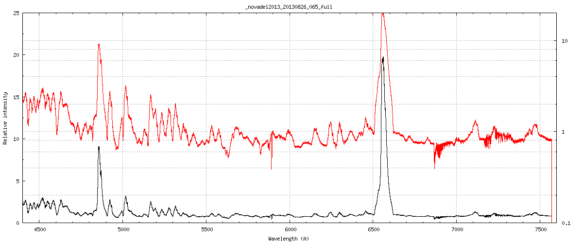

there is a good chance that we can get some spectra of Nova Del 2013 from the IAC80 telescope equipped with an eShel on Teide. Here a preview:
eShel 4x60 sec with IAC80 telescope at Teide, red: log scale at right
In case of bad weather over all of Europe this might be very valuable.
