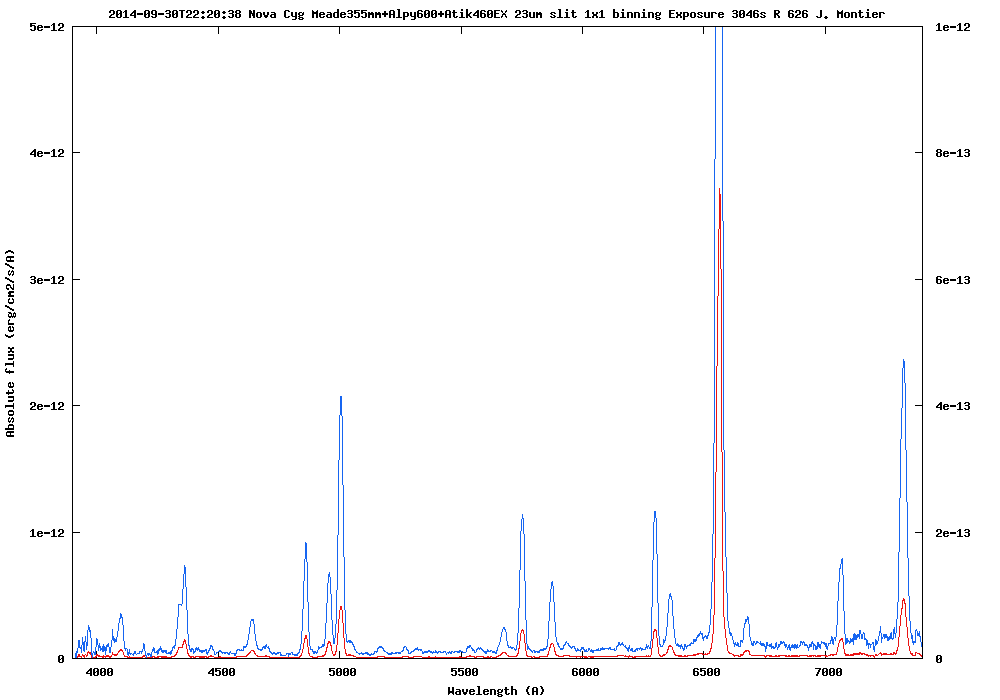

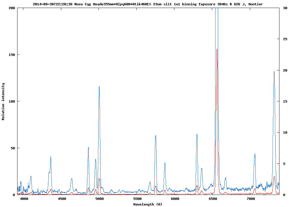

Nova Cyg on 2014/09/30
Relative intensity
Absolute flux
Evolution from 09/01 to 09/30
One could see the 4959A and 5007A [OIII] lines and 5876A and the 6678A and 7065A HeI lines.
Regards,
Jacques Montier

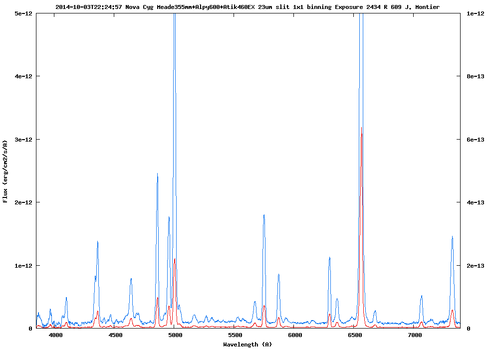

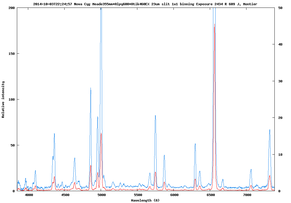

Nova Cyg on 10/03
Relative intensity
Flux (erg/cm²/s/A)
Regards,
Jacques Montier

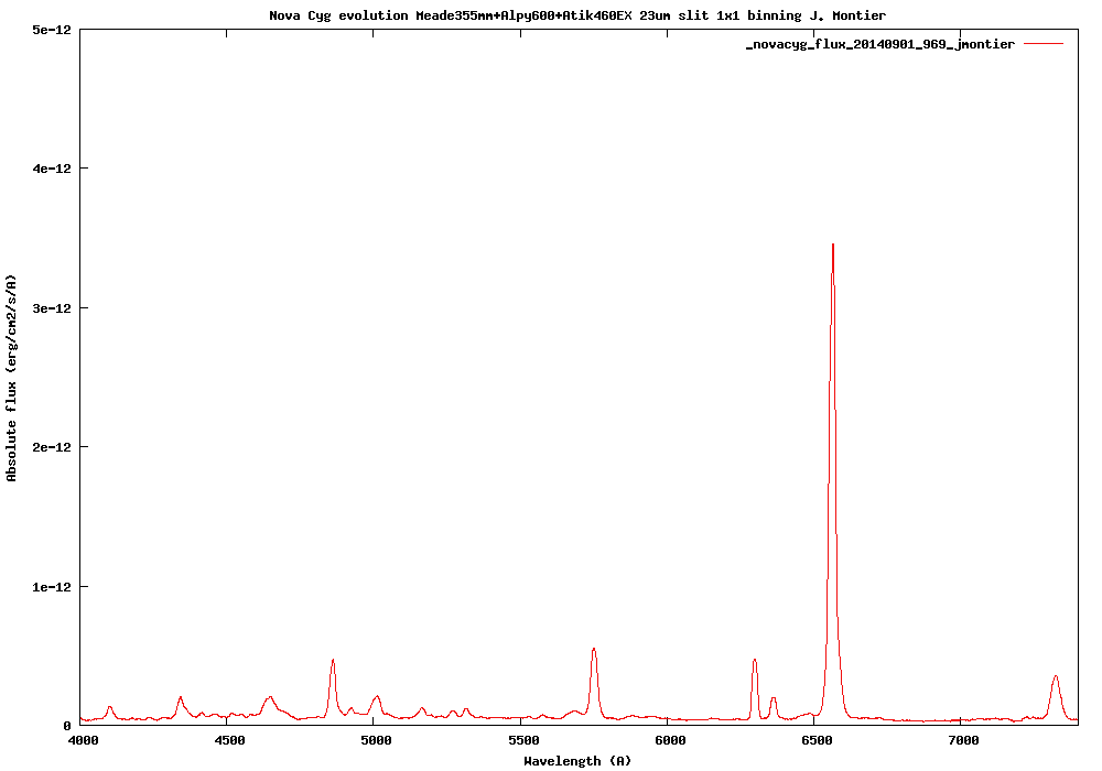

Evolution de la Nova entre le 30 juillet et le 3 octobre.

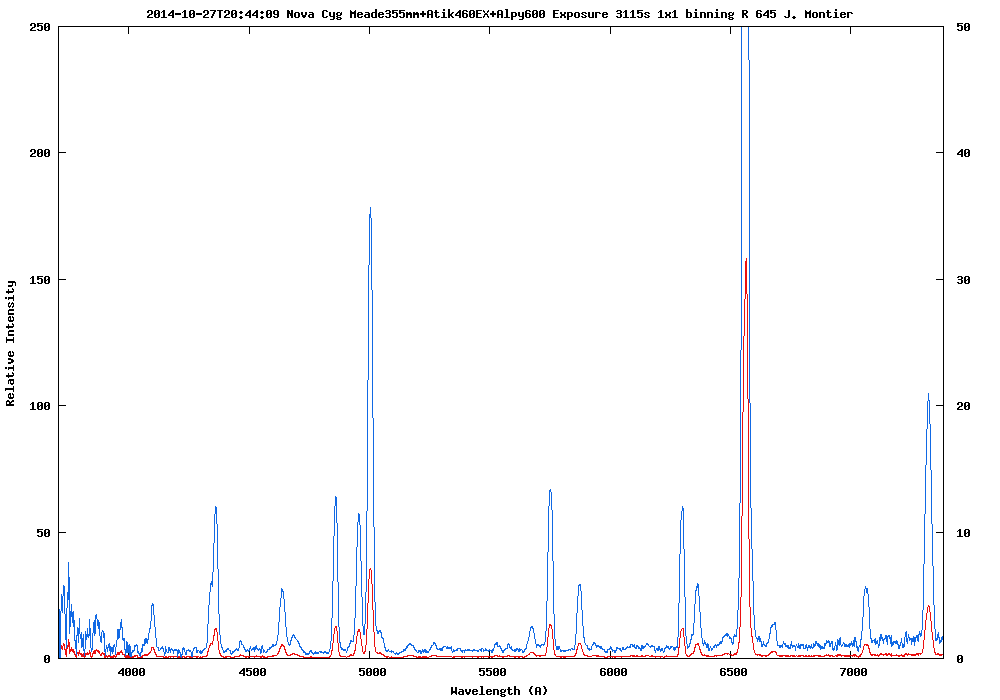

Nova cygni of the night
Relative intensity
Absolute flux
Jacques Montier

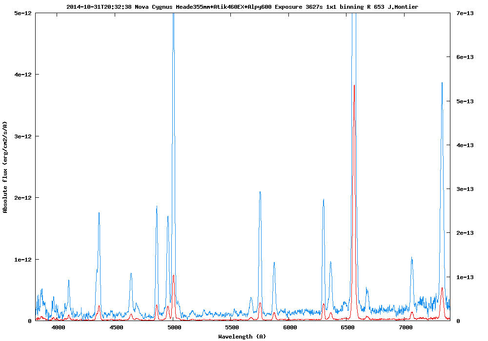

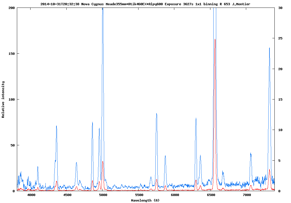

Nova Cyg on 2014/10/31
Relative intensity
Absolute flux (erg/cm²/s/A)
Regards,
Jacques Montier

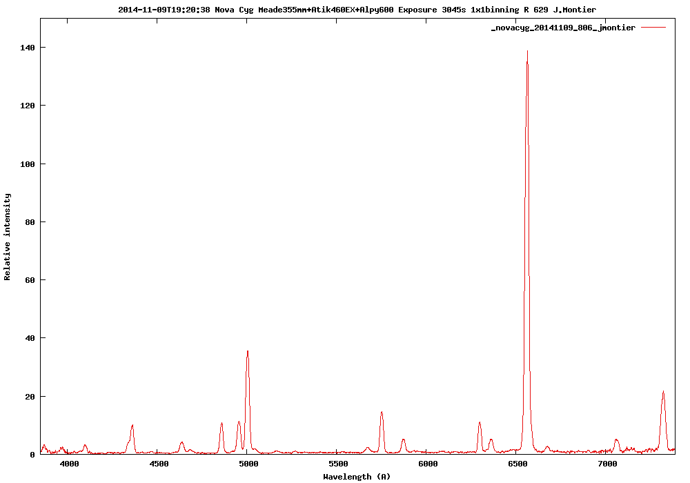

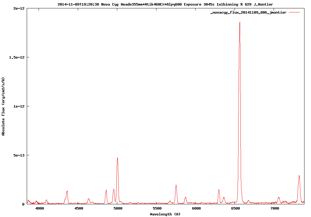

Nova Cyg on 2014/11/09
Relative intensity
Absolute flux
Regards,
Jacques Montier
