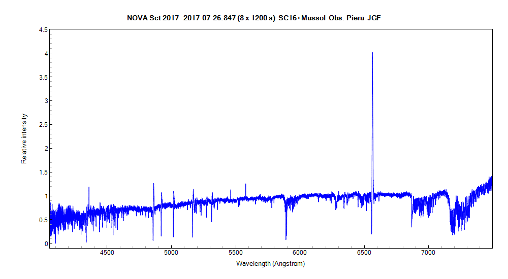

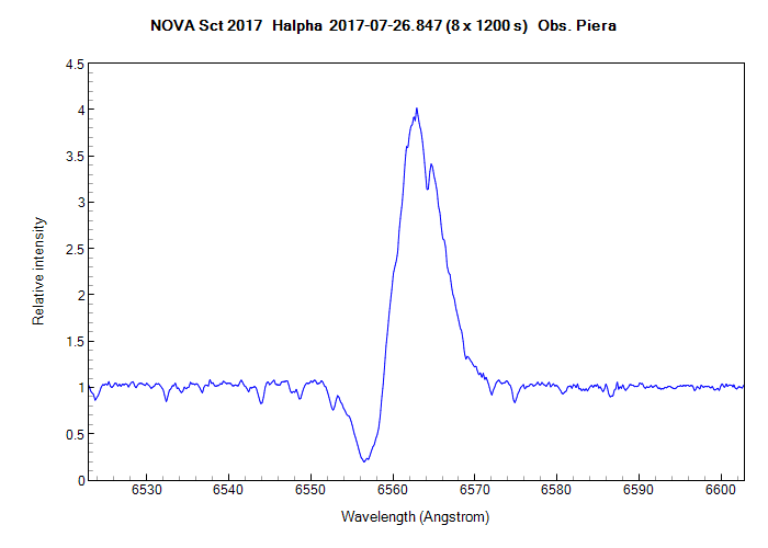

This is the aspect of NOVA Sct 2017 on the last night, wiht the SC16 and the Mussol echelle.
Regards, Joan.
Regards, Joan.
- __novasct2017_20170726_847_J. Guarro.png (42.89 KiB) Viewed 12186 times
- __novasct2017_20170726_847_J. Guarro1.png (18.77 KiB) Viewed 12186 times

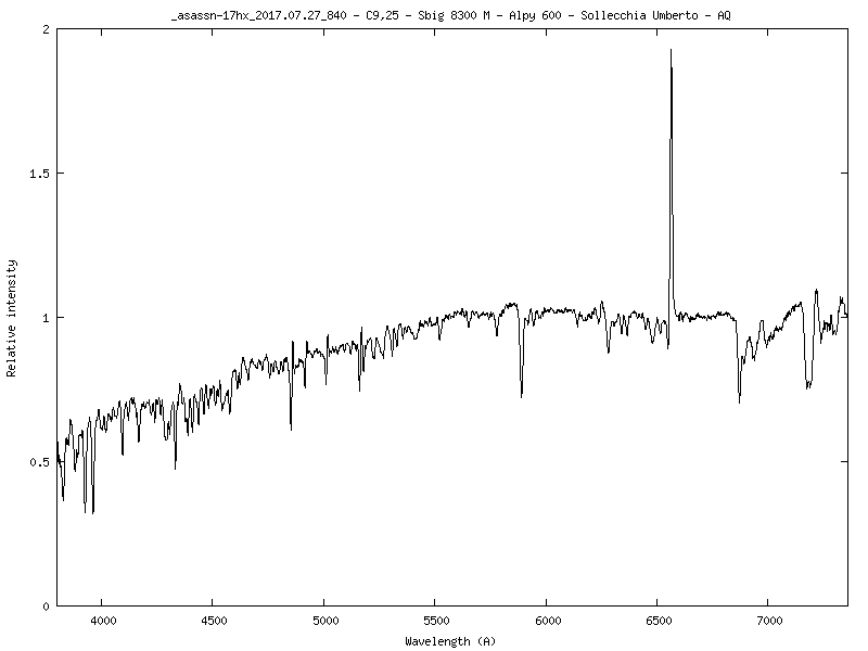

- Posts: 247
Bonjour à tous, placez le profil d'osservazione dans la nuit du 27/07/2017.Umberto

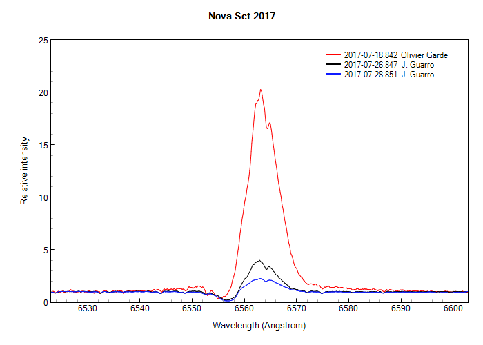

- Posts: 728
This graph is the comfirmation of Olivier's observations.
Regards, Joan.
Regards, Joan.
- novasct2017_20170718_842_Olivier Garde2.png (22.83 KiB) Viewed 12135 times
- Posts: 578
Well done Umberto. Olivier, very nice the OHP joint venture spectrum!
The comparison of your great echelle spectra (Olivier and Joan) show very well the effect of the continuum raising.
I have another example with Lhires III (1200 l/mm 26/7, 600 l/mm 4/7). The same spectra compared in absolute flux and rescaled to unity at ~ 5000A.
Yesterday (July 28, ~ 21 UT) I measured V mag 8.70, perhaps the maximum brightness until now.
The ARAS database database begin to be well "supplied". I think this interesting nova deserves to be observed in this peculiar phase.

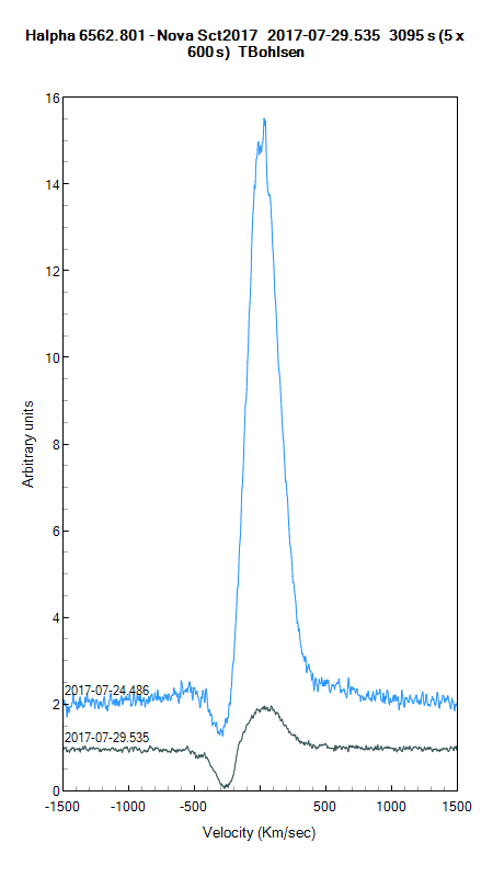

- Posts: 191
I took another spectra of this interesting nova last night using my LHIRES at ~R=14000. The strength of the Ha line has dropped significantly compared to the continuum.
Terry
Terry
