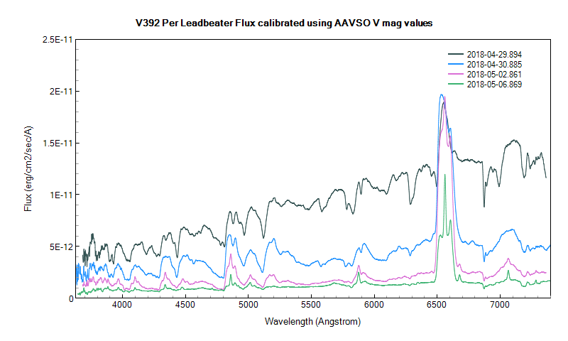

Re: V392 Per in outburst
Tonight's spectrum (flux calibrated using AAVSO V mag values) compared with previous spectra. Although the H alpha line remains strong relative to the continuum, it is now actually reducing in absolute flux
