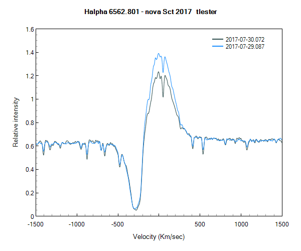

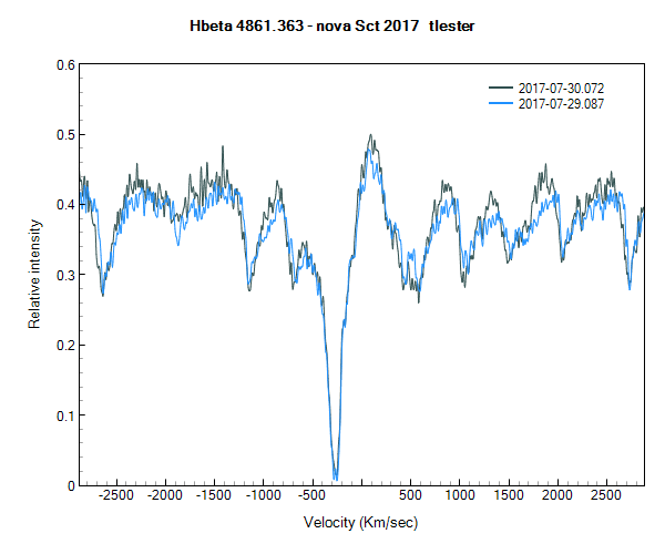

Post by Tim Lester »
Was able to get spectra the last two nights (29th and 30th) with my new echelle. Halpha still dropping.
But not much change at Hbeta.

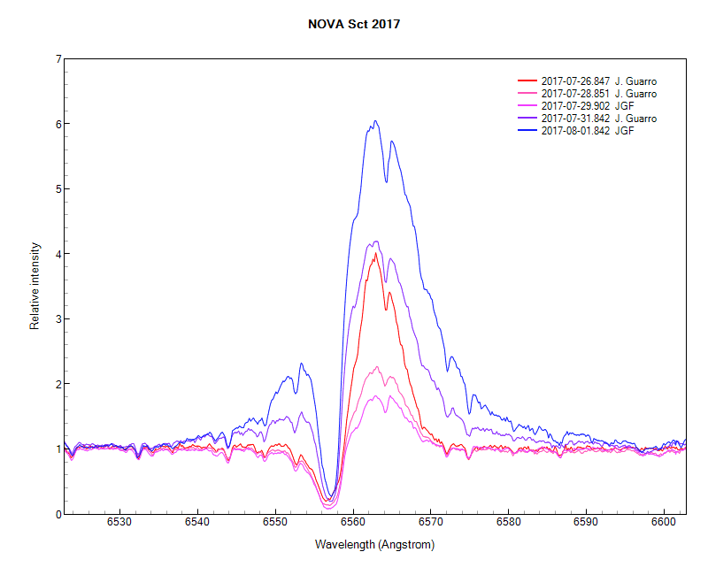

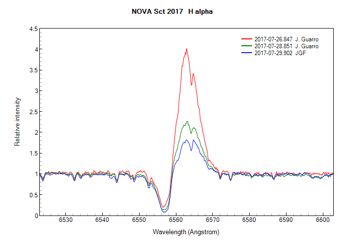

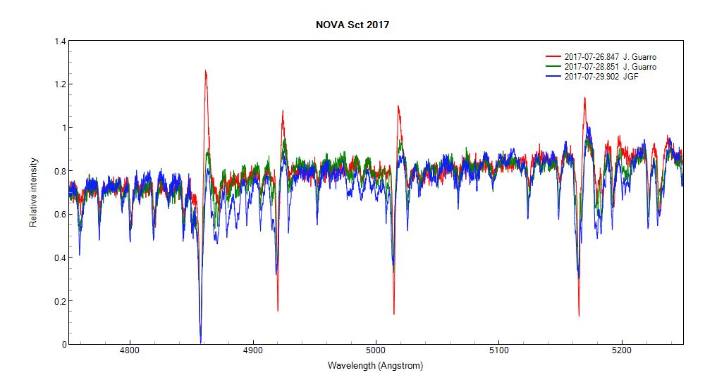

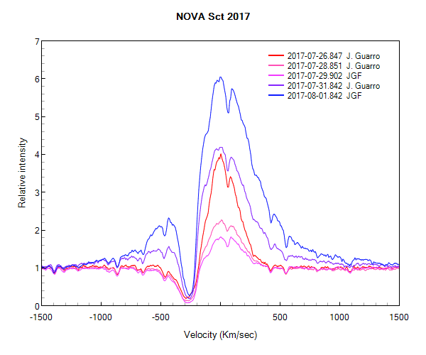

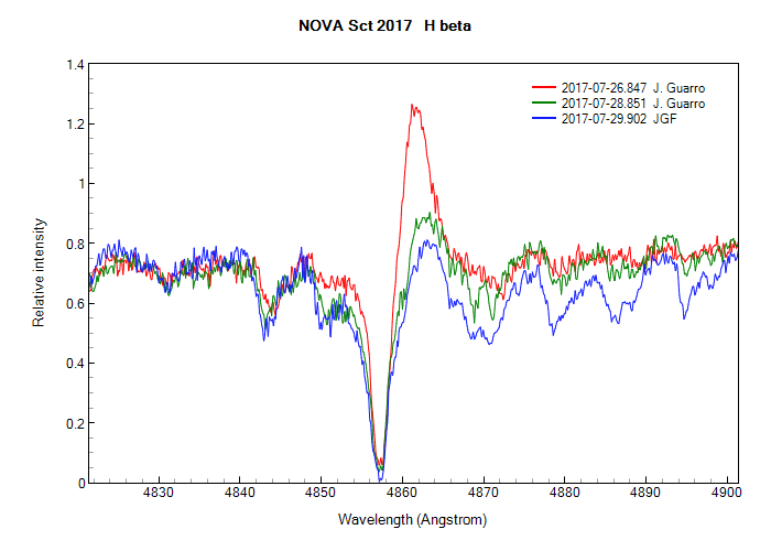

Post by Joan Guarro Flo »
Comparing three nights.
Joan.
novasct2017_20170726_847_J. Guarro1.png (31.72 KiB) Viewed 9375 times
novasct2017_20170726_847_J. Guarro2.png (52.05 KiB) Viewed 9375 times

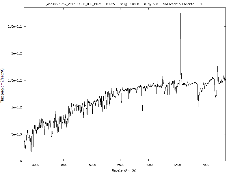

Bonjour à tous, placez le profil d'osservazione dans la nuit du 30/07/2017.
Profilo nova flux.png (12.59 KiB) Viewed 9371 times

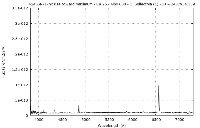

Salut, j'ai fait une animation avec des spectres pris jusqu'à présent, calibré flux absolu par photométrie de Paolo.
Il souligne que l'animation est interpolée, pour sa réalisation,j'ai utilisé 12 observations qui couvrent la plage où la nova atteint la luminosité maximale.
Salutations

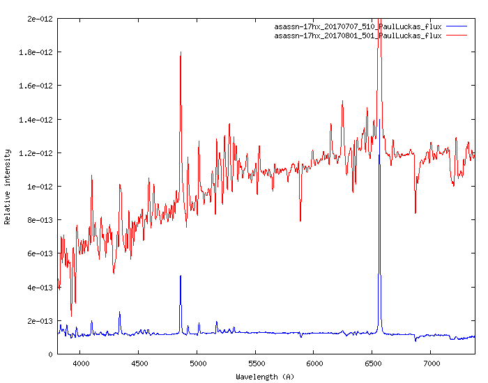

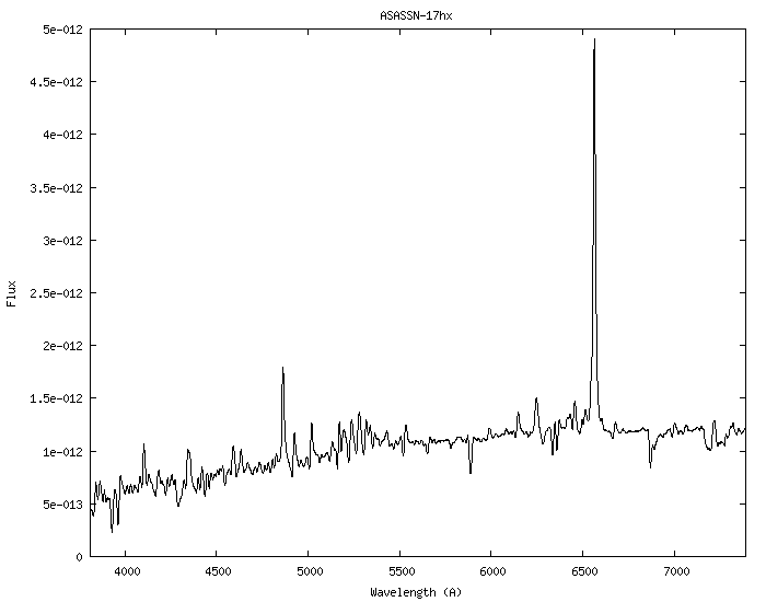

I've not had much chance to take spectra due to rain, but finally managed some spectrophotometry of the now changing and brightening ASASSN-17hx last night. A comparison with my last spectrum of 7th July is also attached.
Paul

The H alpha of NOVA Sct 2017, is ascending again, I hope that does it hard.. The minimun, ( at de moment ), is registereg by Tim Lester, on the night 2017 07 30.
Congratulations to all, Umberto, si sta facendo un grande lavoro.
Joan.
novasct2017_20170726_847_J. Guarro1.png (52.89 KiB) Viewed 9305 times
novasct2017_20170726_847_J. Guarro2.png (37.12 KiB) Viewed 9305 times
