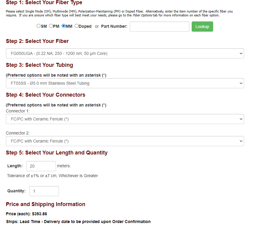

Thanks for providing the information regarding the optical fiber source. I'm designed a cable that looks to be the correct one... can you confirm the specs in the attached picture before I order, please?
- Capture.PNG (37.96 KiB) Viewed 9298 times

- Posts: 1276
Re: A modification for improve eShel spectrograph
Hi James,
This ring adapter is supply by Shelyak, just ask Shelyak to have a quote if you need one.
