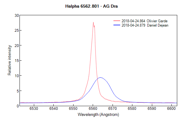

I am very impressed by what I see on this forum on AgDra alert. Not sure about the value added of my comment based on low resolution data. It a obviously a great challenge for my Alpy600 on a SkyWatcher 200/1000 with Atk428 camera (4.5microns/pixels)... After a first (and poor) tentative with bin22 on 24/04 I did a second trial on 26/04 with bin11 (cf data base record 26/04/18 DDJ). Result appears better and more reliable.
Looking to these low resolution data I can see a significant doppler blue shift on the main lines. Based on a chart below it can be evaluated at about 140km/s for Hgamma and HeI 4686. It appears to be slightly lower for Halpha around 110km/s. The measurement resolution is estimated by ISIS is around 512, in such condition, the best measurement error level is probably around +/-30kms. Then I am not sure of the real meaning of these measurement at low resolution.
Is there a real blue shift around 130km/s for AgDra or a just an calibration error on my side ? If real, what is the physical reason behind such effect ?
Many thanks for any comment.

Daniel Dejean wrote:Is there a real blue shift around 130km/s for AgDra or a just an calibration error on my side ? If real, what is the physical reason behind such effect ?
Daniel,
The shift is "normal" and real because of the proper motion of this star, around -147 km/s (see Simbad), so the star go in our direction with a velocity of 147 km/s
http://simbad.u-strasbg.fr/simbad/sim-b ... BAD+search
So if you have remove heliocentric velocity from your spectrum, the shift found in your case with an Alpy is good and real (with a resolution about R=600, the error is about +/-40 km/s).

Thank you Olivier,
I was not sure to get enough accuracy in my calibration process to measure such a "small" shift (everything is relative...) with my Alpy600.
This is a great new.
Daniel

Daniel, Olivier a raison en ce qui concerne la vitesse radiale de AG Dra, très élevée
Pour AG Dra, nous avons à la fois des spectres Echelle et des spectres basses résolution
C'est une excellent moyen de vérifier les spectres BR
Pour le 24/04, sur des spectres non corrigés de la vitesse héliocentrique:
agdra_20180424_864_Olivier Garde.png (15.85 KiB) Viewed 10538 times
La position de Ha dans le spectre d'Olivier est 6560 A (-125 km/s, mesure à mi-hauteur de la raie)
Donc, du même ordre de grandeur que la vitesse héliocentrique du système. Note: pour différentes raisons (rotation, zone où se forme la raie ...) il y a souvent un décalage entre la mesure de vitesse de la raie et celle du système.
Dans le tien, on trouve 6464 A, soit un décalage significatif, *vers le rouge*
Ta calibration spectrale doit pouvoir être améliorée. 1 A d'écart serait un résultat correct.
Bonne continuation

Post by Daniel Dejean »
Bonjour François,
Tu as tout à fait raison et j'en étais arrivé à la même conclusion après mon premier essai du 24/04. C'est pourquoi je me suis remis au travail le 26/04. Mon commentaire ci-dessus faisait bien référence à ce dernier enregistrement. Sur cet enregistrement du 26/04, voici un donc zoom sur la région Ha en comparaison du spectre d'Olivier. La calibration est meilleure et commence à ne pas être trop ridicule par rapport à ce que l'on peut voir sur un spectre haute définition ... :-)
Dans les deux cas, spectres à haute et basse résolution le blue shift en Ha parait plus bas que celui sur Hbeta et Hgamma (-105 au lieu d'environ -140km/s). Mais bien sûr je n'oublie pas que de toute façon mes résultats obtenus avec un Alpy sont impactés par une incertitude d'au moins +/- 30km/s ce qui rend cette remarque discutable dans mon cas.
Merci à toi d'avoir accepté à la fois le premier essai et ce second tir corrigé. Ceci donne lieu à un échange très instructif et me donne des perspectives d'améliorations.
Bon ciel,
Daniel
Posts: 1565
Oui, Daniel, ta calibration du 26/04 est impeccable

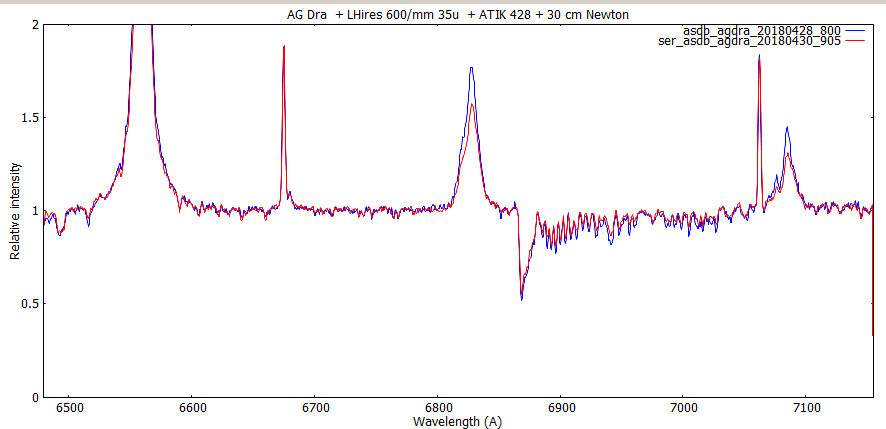

Last night 04.30 I've caught Raman lower than on 04.28 (unlike for many past few days till 04.28 till the EW is the same for many days):
R~2700, 8 vs 15x450 sec
Also caught similar fade with a small flicker within a night on 04.21 evening (have an overnight serie).
Have multiple series from more nights (with bad luck: only 208.04.21 so far that showing something), I'm on preparing a more comprehensive report, will send results later.
Weather got poor here, but someone else might catch a further fall.
