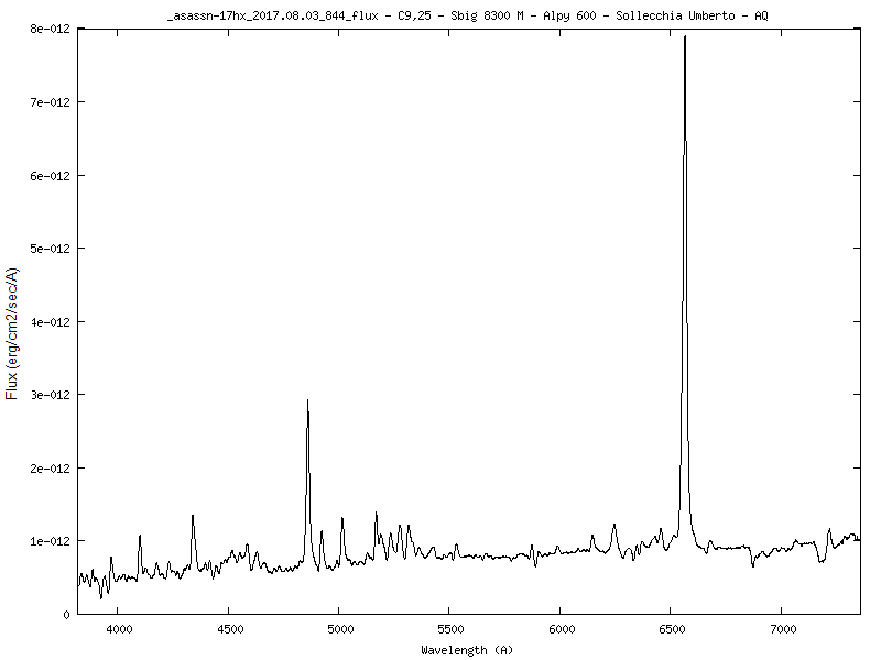

Bonjour à tous, placez le profil de nova observé dans la nuit du 03/08/2017.Peut-être la nova, a décidé d'aller à la retraite.
Profilo nova flux.png (10.21 KiB) Viewed 15035 times
Posts: 1565
Nice Spectrum, Umberto. Decline toward nebular phase.
James: correct, unless He I. The lines are Fe II, multiplet 42
He I will appear latter when the recessing photosphere will be hotter and so hot enough to ionize He

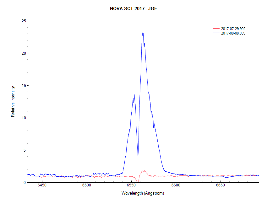

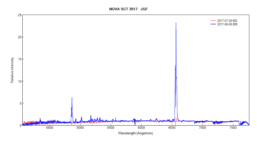

Posts: 728
Post by Joan Guarro Flo »

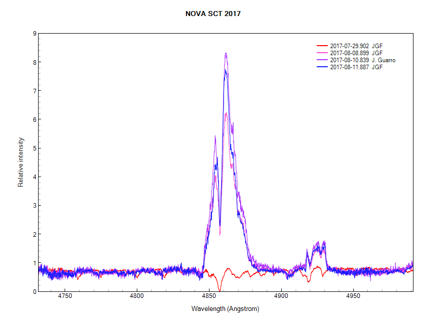

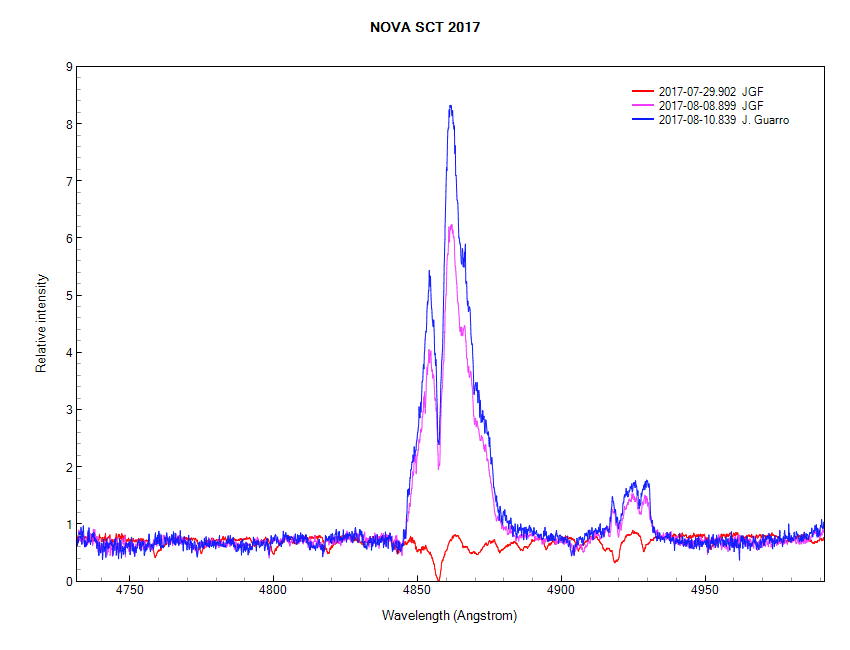

NOVA SCT 2017, is full of surprises...
Joan.
Posts: 247
Post by umberto sollecchia »
Caramba, quelle belle surprise Joan !....- Umberto
Wow ! Even allowing for the change in continuum flux between the two dates (~1 mag at R, AAVSO data) that is a big change

Posts: 728

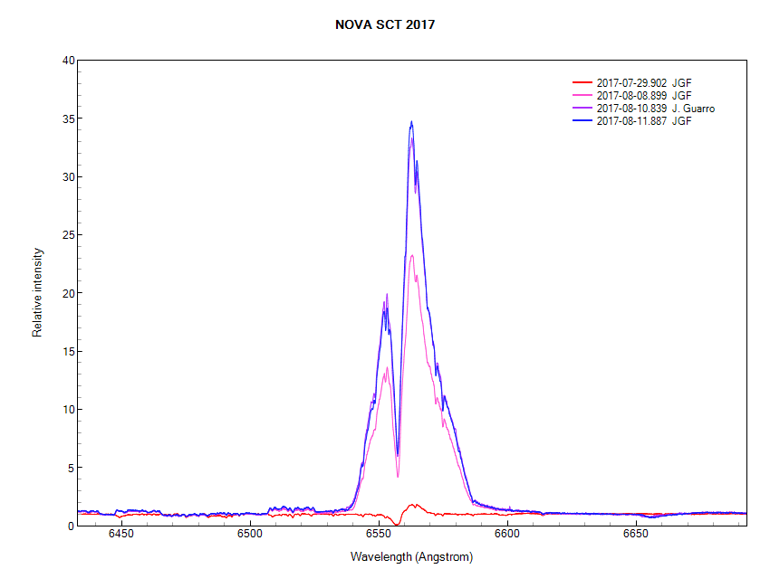

Continues the rise of Hydrogen.
Joan.

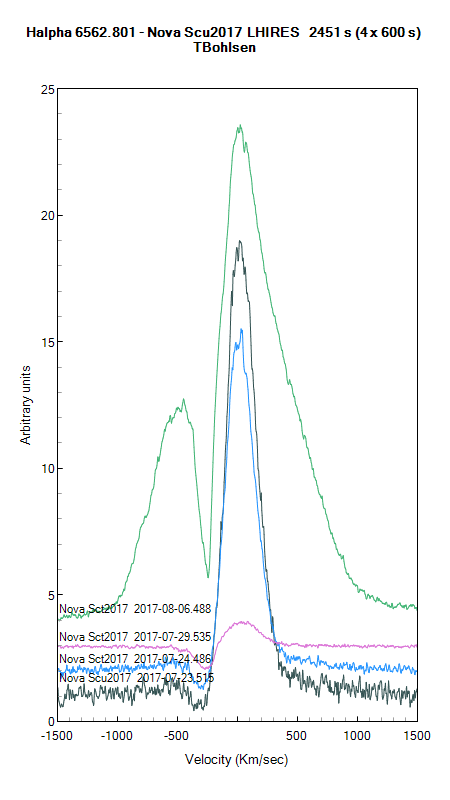

My effort with this nova. Big changes over 2 weeks.
Terry Bohlsen
Armidale NSW
Australia

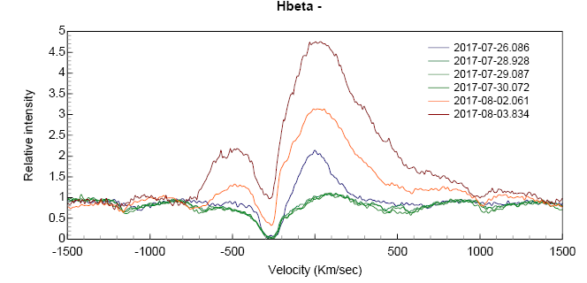

Posts: 728

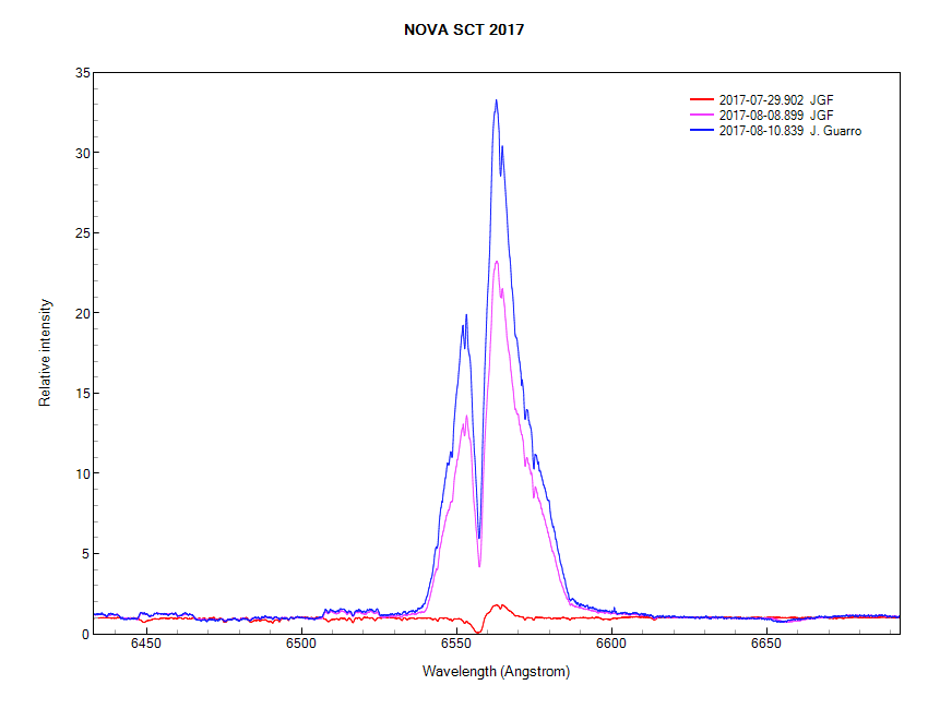

NOVASCT2017 has moderated its growth in the Halpha and has decreased to its emission in the Hbeta.
Regards, Joan.
