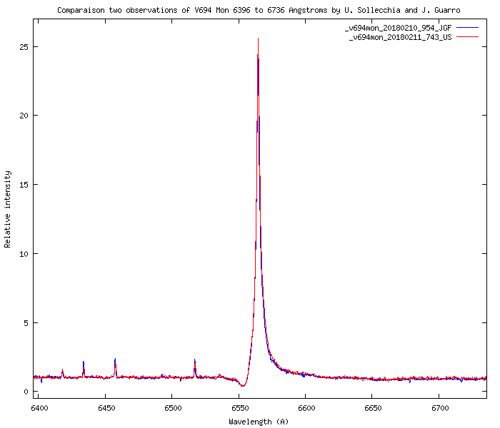

The image shows the graphs of two observations of the star V694Mon, one is made by Umberto Sollecchia from L'Aquila, and the second one is made with the REMOT telescope, from Sta. Maria.
The used telescopes and spectrographs are completely different, so is the spectral resolution. But the two graphs coincide, (I have not manipulated or adjusted, I have compared only two).
This means that the method of treatment we use, based on the ISIS, seems to work in a very acceptable way. I'm happy.
Joan.

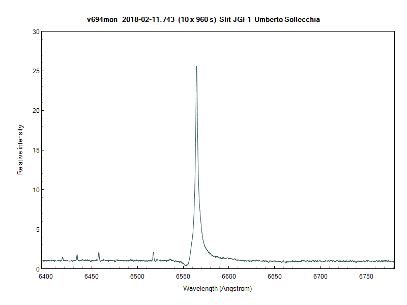

Merci Joan pour cette comparaison, cela montre que vos spectrographes fonctionnent parfaitement. Mon profil utilisé pour votre comparaison.Umberto
- Posts: 1562
Re: TEST V694 MON
Excellents résultats.
Bravo à tous les deux pour la maîtrise du traitement et à Joan pour la qualité de ses spectros.
