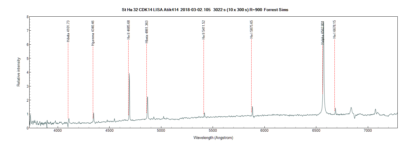

Greetings!
I had a go at StHa 32 tonight. The full Moon was not ideal but the target and reference stars were not at all close to the Moon. I took (8) 300sec guided exposures of StHa 32. I took (7) 30 sec exposures of the Miles star HD041692 for determination of the instrument and atmospheric response curve correction. All of the emission lines in the spectrum appear red shifted.
Comments appreciated:)
Woody
Posts: 1565
Re: Symbiotic Star StHa 32
That's great Woody! A new symbiotic in the database
You have also intense Raman OVI bands, so the ionization level remains very high >> 100 000 K
P Cygni profiles on the lower members of Balmer lines
It looks to be an outburst of an accretion disk around the white dwarf
Of course monitoring of the outburst is welcome
