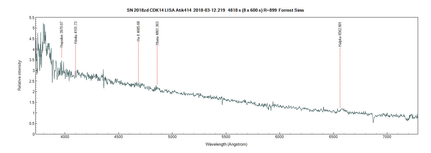

Here is my contribution from last night to add to Peter's data. The humidity was very high and there were some thin clouds wafting though at times during the exposures. I took 8 600sec exposures of the target. I had a very difficult time finding a Reference star as all candidates other than HD043378 were too far off in air mass from the target. But with HD043378 being so bright I had to take only 10 sec images of which I took 7 in order not to saturate. The calibration looks good to the red side of about 3925Å.
Woody

Hi Woody,
You seem to have good SNR in the red, yet I wouldn't dare to tell for your spectrum that any P-Cyg appeared.
Maybe happened in the 0.5 days difference? (2018-03-12.219 vs 12.765)
Hope someone continues and confirms (poor forecast here).
- Peter
