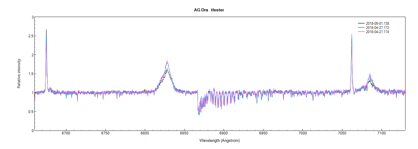

Post by Tim Lester »
My result for May 1 compared to my last two recent spectra. Also showing recent drop in Raman feature.
