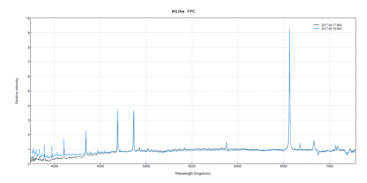

a comparison of two spectra of AG Dra, one a month ago and the second, from this last night. A lot of changes I see: the blue wavelenghts show a increase of continuum and all emission lines are stronger. Definitively interesting, I will continue the monitoring (hélas, today the sky is cloudy). My only doubt: concentrate observations at low resolution or at medium resolution (R=5000) in 6500-7200 A? :?:
Greetings
Fran
Posts: 1567
Nice result!
Joan's spectrum obtained the 16th shows an increase of the recombination lines; OVI reamin almost constant
I suggest R 5000 on 6500-7200 range

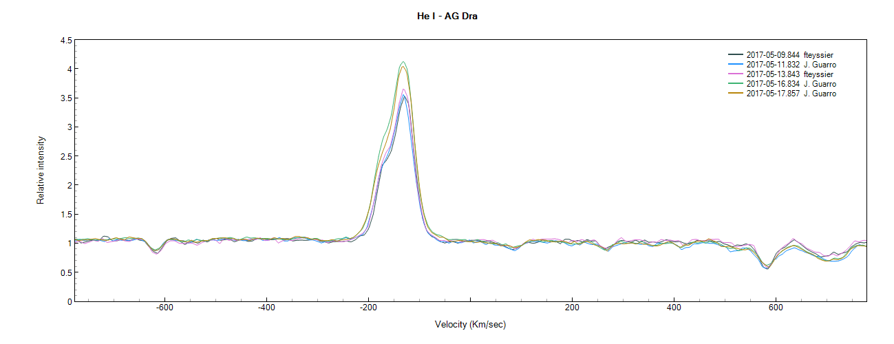

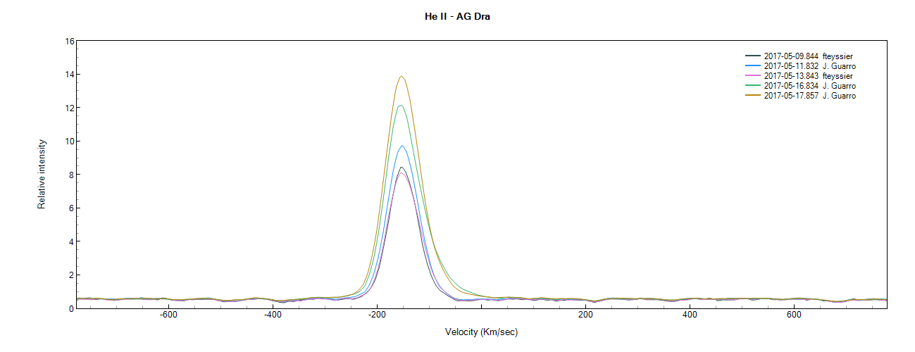

Lines evolution in May
Increase of Recombination lines
He I triplet and singlet

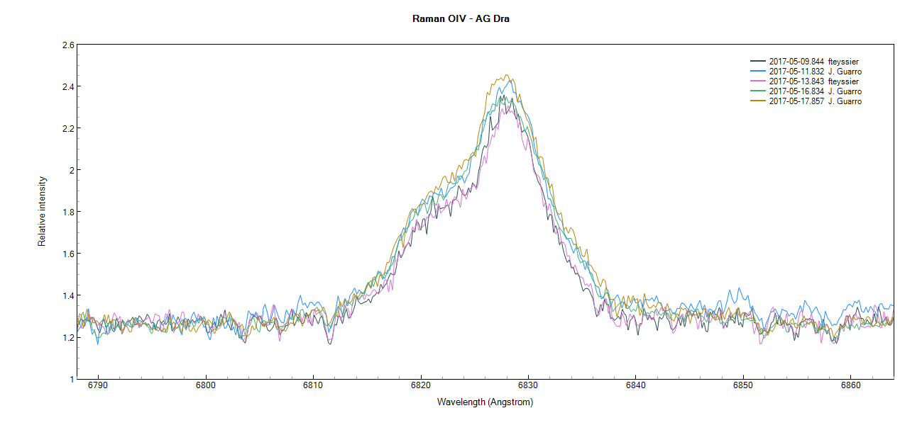

Raman OVI (6830)
Raman OVI 7085
And the EW
