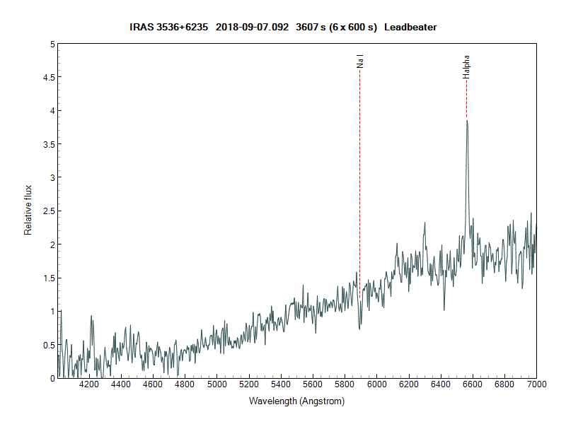

Re: IRAS 03536+6235 RCrB star? - call for spectra
Here is the reduced spectrum. Very noisy but clear H alpha emission. The continuum is very red but there is high extinction in this direction. Total galactic E(B-V) is ~1.0 according to IRSA. The Na D line is clear but again that could be Interstellar. Is this the expected spectrum for an RCrB star in a high state ?
