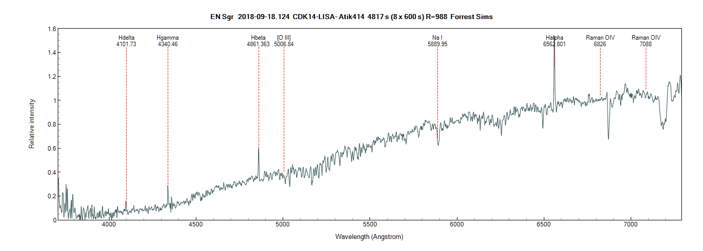

Greetings,
I saw François's request for spectrum on these potential Symbiotics.
I chose EN Sgr last night to see if I could get a spectrum. As you might have noticed all of these targets have a big fat (-) minus sign in front of the DEC. Makes me think they are made to order for Paul Lukas:) Add in the position of the Moon, the magnitudes and that many of these targets are setting in the west early in the evening reduces the candidates I can reach here from southern Arizona. I took 8 600sec images of EN Sgr with my LISA using HD214994 as a Reference star.
Here is a plate solved guider image of the field and the results displayed in PlotSpectra. Some preliminary analysis by François and Adrian Lucy point in the direction of this possibly being a Carbon Mira type star.
Cheers!
Woody
EN Sgr guider plate solved annotated.jpg (22.55 KiB) Viewed 4529502 times
Or for Terry who added two spectra in the base: http://www.astrosurf.com/aras/Aras_Data ... pected.htm
Another spectrum of EN Sgr confirms Woody's observations: Balmer lines in emission, but no sign of high ionization lines (He II, [OIII], [Fe VII], [Fe X], [Ca V], Raman OVI)
The Balmer decrement is normal. The continuum evoques a C star, but flat.
A difficulty is that for some symbiotics, high ionisation lines appears only in UV. See for instance our spectra of NQ Gme, UV Aur, BD Cam ... Or are sporadic (remember that CH Cyg was a M giant standart until the early 60' when appeared for the fist time its symbiotic characteristics ([OIII])
and a spectrum of Gaia DR2 6345873798283774848 (no emission on the red continuum)
One interesting aspect of this campaign is that we have also to determine the spectral class of the targets
"what is that spectrum?" An excellent school
