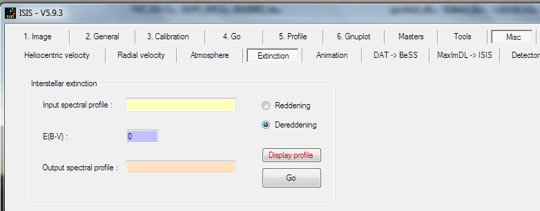

Re: Be or not Be?
You can also use ISIS to see what your spectrum would look like without IS

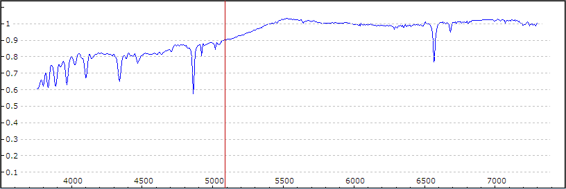

Re: Be or not Be?
This is what a B2iv spectrum (pickles) looks like with 1.2 IS redenning

Thank you Robin!
I did not know this aspect of spectrometry
actually, applying the average rate (1.1134), the profile changes
and comparing with a B2III
remains this bump that appeals to me
I advance
cordially 8-)
