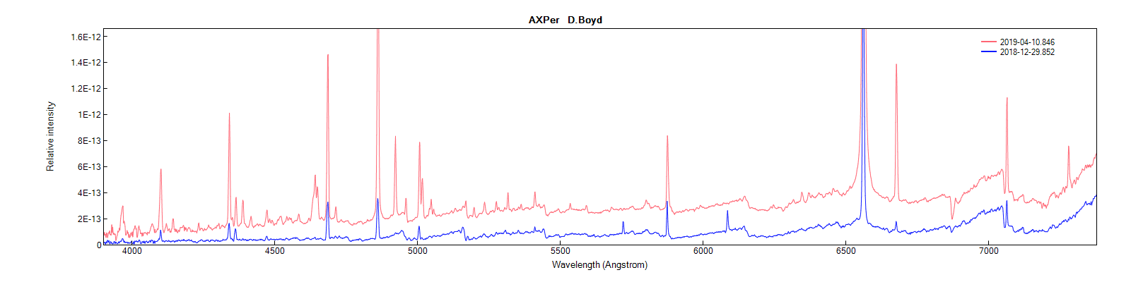

The recent spectra in the database (D. Boyd, W. Sims, C. Boussin, F. Campos) and photometry obtained by David Boyd show that the prototypical symbiotic star AX Per is in strong outburst (V = 10.3)
V mag according to phase (P = 680 days)
Current cycle (brown squares) strongly different from former ones
Classical symbiotic outburst (expansion and cooling of the accreting layer on the white dwarf)
High ionized lines (notably [Fe VII] disapear
Spectra of the event are very welcome

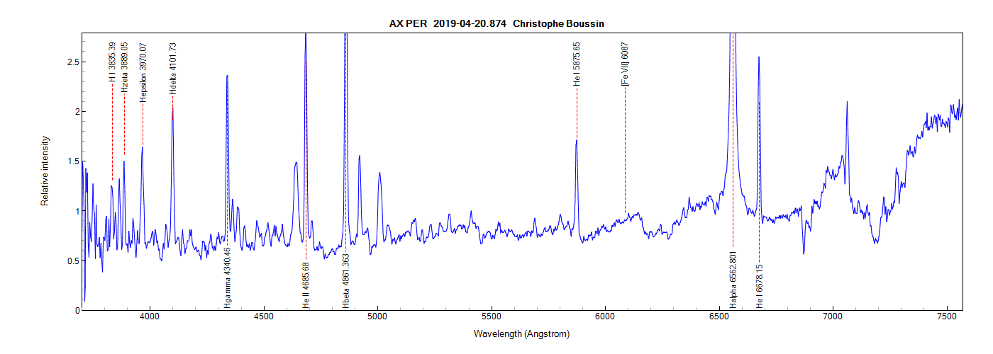

Here is my last contribution to the monitoring of AX Per outburst.
I obtained the following spectrum the 20th of April at 20 h 58 TU with my Alpy 600 (resolution of 505, JJ = 2458594.3738) and an acquisition time of 30 min :
AX Per on April 20th, 2019
_axper_20190420_874_Christophe Boussin_3700_7570.png (80.16 KiB) Viewed 10272 times
As an indication, identification of some lines :
AX Per on April 20th, 2019 (identification from PlotSpectra)
As in the spectrum of April 11, the absence of the [FeVII] line at 6087A is noticeable :
Fe[VII] line at 6087A
Fe[VII]6087_axper__Christophe Boussin.png (32.88 KiB) Viewed 10272 times
Since April 11, for example, the relative intensities of the Halpha line and the HeI line at 6678 remain, approximately, unchanged :
Halpha
Halpha
Halpha_axper_Christophe Boussin.png (31.54 KiB) Viewed 10272 times
HeI line at 6678A
HeI line at 6678A
HeI6678_axper_Christophe Boussin.png (31.36 KiB) Viewed 10272 times
Clear skies,

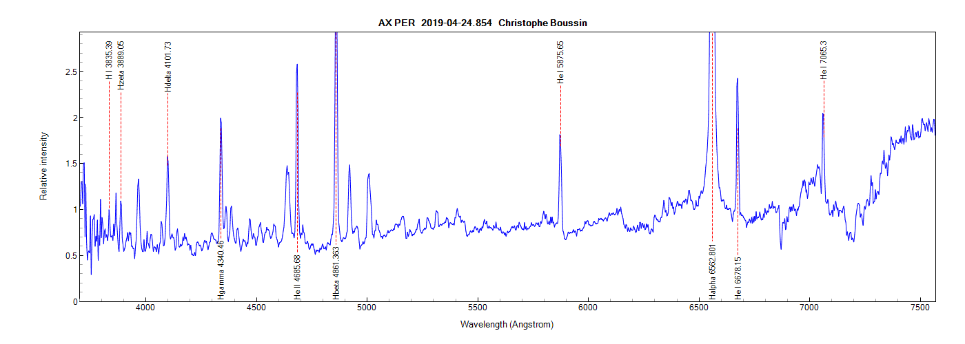

After a cloudy day, I was lucky to see the sky clear again in the early evening on April 24th !
The weather has improved long enough to allow me to get another spectrum of AX Per with a perfectly clear sky...before the clouds came back !
So, I obtained the following spectrum the 24th of April at 20 h 29 TU with my Alpy 600 (resolution of 504, JJ = 2458598.3541) and an acquisition time of 20 min :
AX Per on April 24th, 2019
_axper_20190424_854_Christophe Boussin_3700_7570.png (80.01 KiB) Viewed 10210 times
AX Per on April 24th, 2019 (identification from PlotSpectra)
Clear skies,

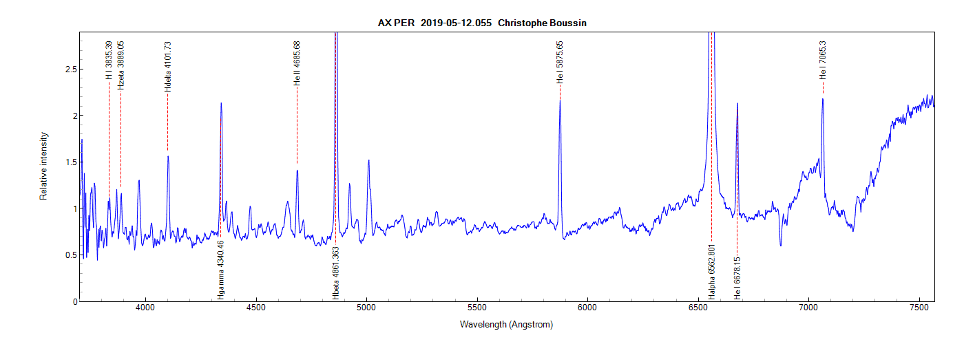

The spectrum below, obtained this morning (12th of May at 01 h 19 TU, resolution 501, JJ = 2458615.5551) with my Alpy 600, is the result of 5 exposures of 300 s each :
AX Per on May 12th, 2019
_axper_20190512_055_Christophe Boussin_3700_7570.png (77.07 KiB) Viewed 10122 times
AX Per on May 12th, 2019 (identification from PlotSpectra)
The relative intensity of the Halpha line is still increasing...
Halpha
Halpha
Halpha_axper_Christophe Boussin.png (35.25 KiB) Viewed 10122 times
...but that of the HeI line at 6678A, for example, seems to be decreasing :
HeI line at 6678A
HeI line at 6678A
HeI6678_Christophe Boussin.png (35.11 KiB) Viewed 10122 times
Does anyone else notice a similar evolution?
Clear skies,

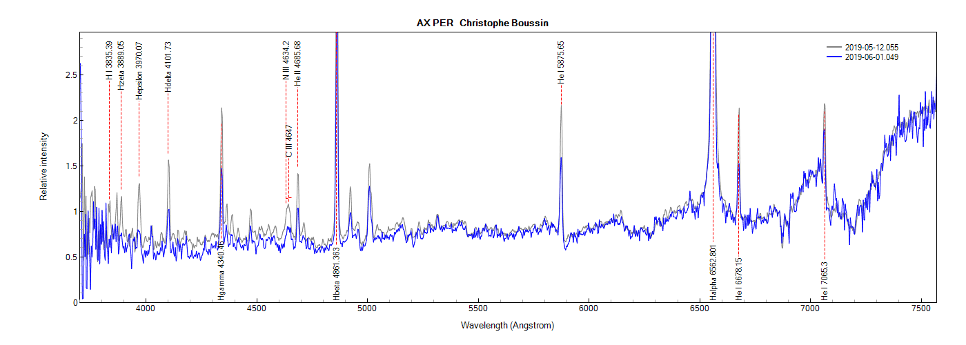

The spectrum below, obtained this morning (June 1st at 01 h 10 TU, resolution 500, JJ = 2458635.5489) with my Alpy 600, is the result of 9 exposures of 300 s each :
AX Per on June 1st, 2019
_axper_20190601_049_Christophe Boussin_3700_7570.png (74.97 KiB) Viewed 9947 times

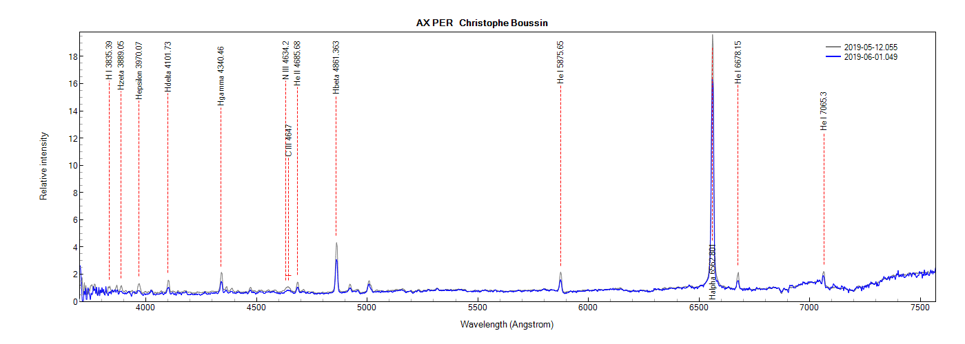

Comparison of the spectra of May 12th and June 1st :
AX Per on May 12th and June 1st, 2019 (identification of some lines from PlotSpectra)
AX Per on May 12th and June 1st, 2019 (zoom)
We can note the decrease of the relative intensities of the spectral lines (like those of the CIII/NIII blend and the HeII line at 4686A) :
AX Per on May 12th and June 1st, 2019 (NIII/CIII blend and HeII line at 4686A)
CIIINIII_axper_Christophe Boussin.png (26.59 KiB) Viewed 9947 times
