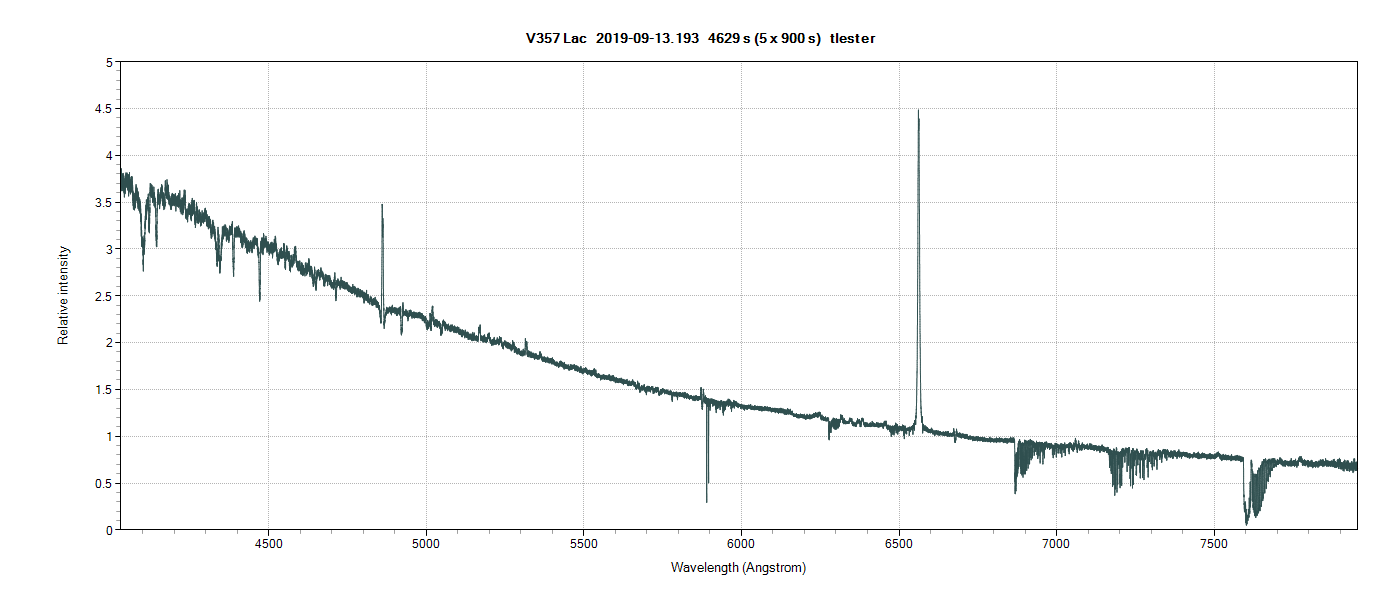

Here is V357 Lac for Sept 13th. R = 14000 and I estimate the S/N to vary between about 80 to 120 over the range.
