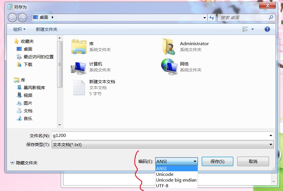

My PC is WINDOWS XP SP1,Chinese version, but ISIS always fails when running FILE mode. I check carefully each step, the only one I am not sure is G1200.lst. I know that both lst and txt are notepad formats, but when I produce such a file, the extension is always .txt in my computor, not ".lst". I HAVE TO rename it. But PC warns me "if you rename the file, it may not be run". YES/NO. I choose YES. After that, ISIS can not work under FILE mode. I change to another computor, as same XP system as this PC, still fail.
I notice that "COSME" is lst format, then I duplicate it, then rename, still fail~~ BTW, in Tab---Master, PC can produce "COSME.LST" automatically, not "COSME.TXT"
I also notice that when run "save as", there is a selection----ENCODE, which code is the correct one for notepad format for ISIS? Does this selection affect ISIS?

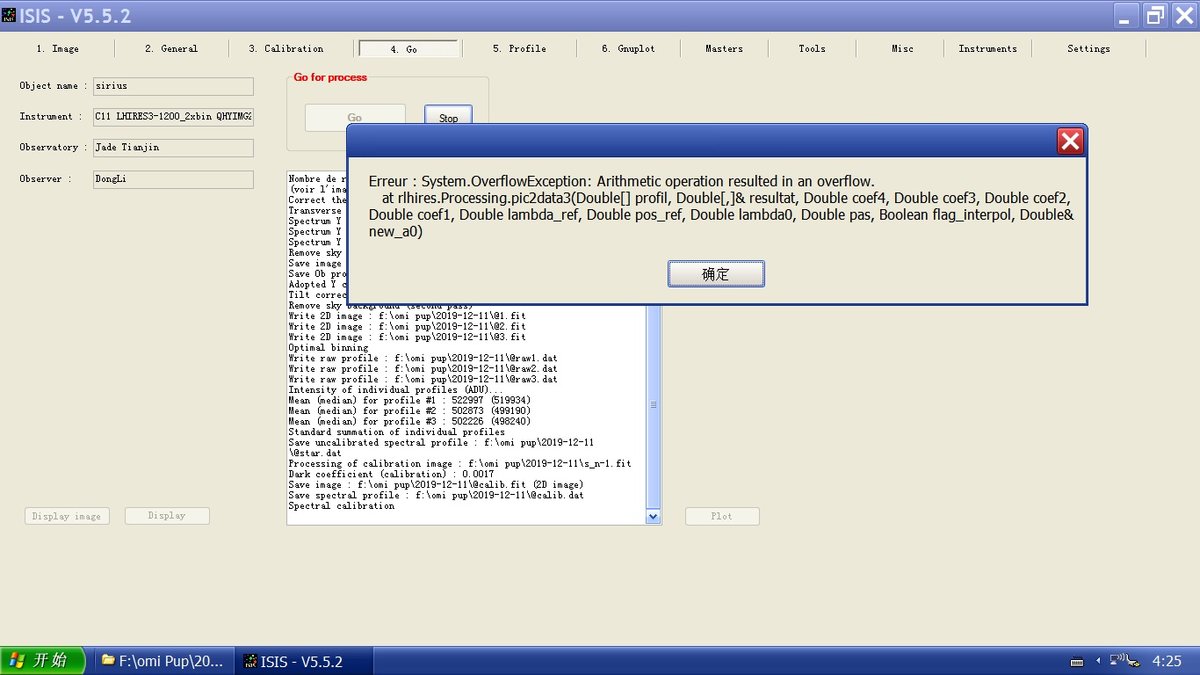

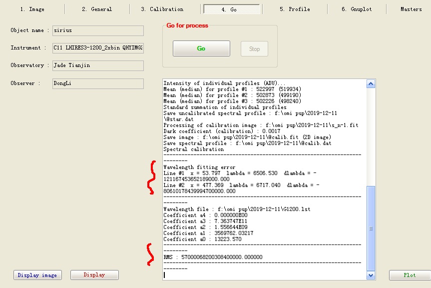

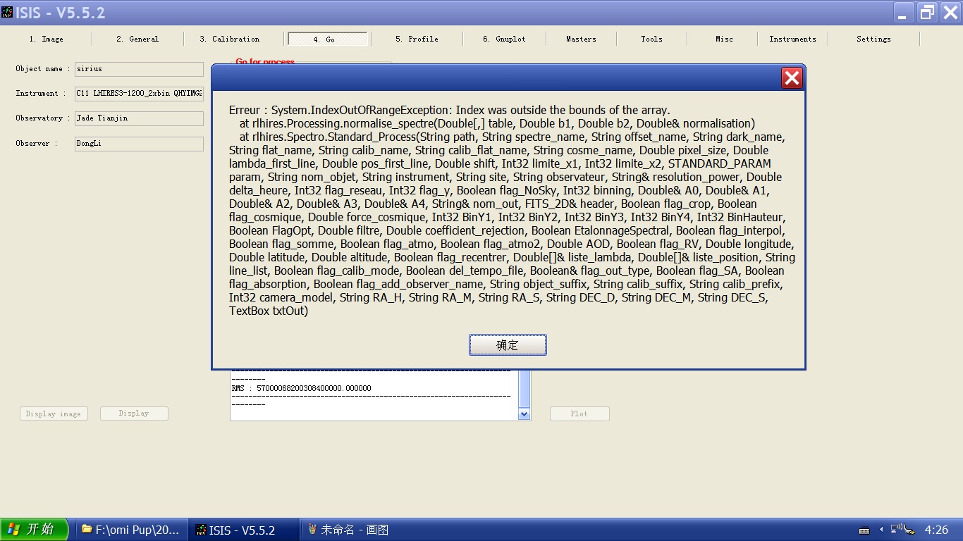

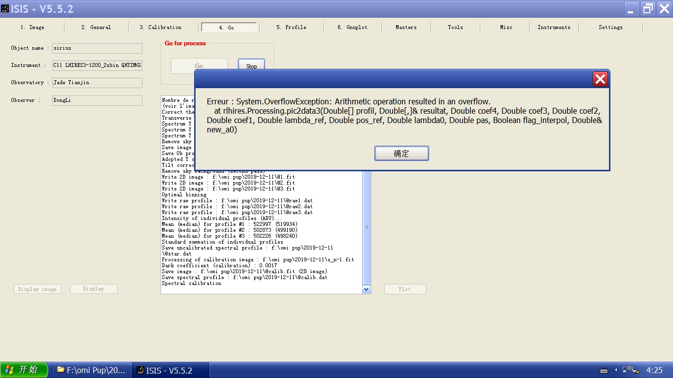

Please see the attachments. I make a file G1200 in the working directory, but when GO, always pops up error. What is wrong?
n-1=order. For grating 1200, order=3, then n=4. I have 5 neon lines in the FOV, if this is wrong?
